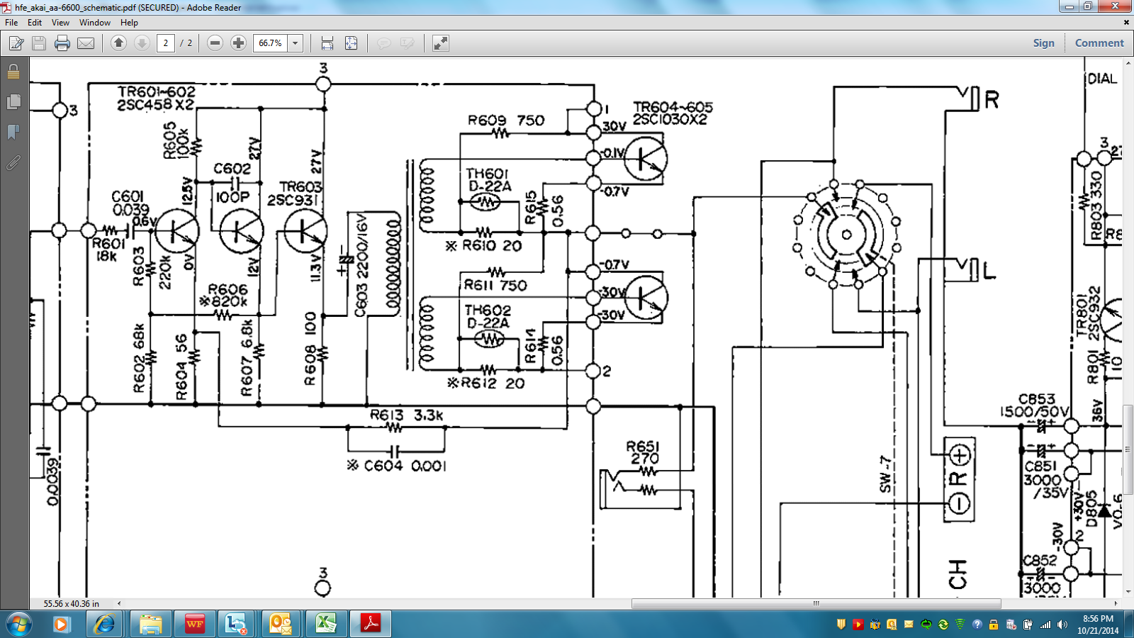

The 2sc931 is a to202 package, with the print facing you the pins will be E B C and the tip31 B C E . The only issue I take with using the TIP31 as a replacement is lower HFE and Ft. If this is in an amp as driver or output with the pnp complement to the 2sc931, it may cause an offset issue or worst case oscillation. I take this item was made late 60's early 70's to be using these old style types. Some details about what your working on may help someone to give you a better solution.
pics attached.
Pics of the circuit here. Its an akai aa 6600.
I would say that for the transistor to fail in that position/circuit is unusual if I didn't already know those old style 2sc458 are known to become leaky and/or noisy(square looking package). I would test voltages around the 2sc458 with the 2sc931 removed before putting another transistor in. Perhaps check after using a hair dryer on them to warm them up a bit to be sure. Also check C603 2200/16V cap for short, this part should have been a 35V in my opinion, and R608/100 ohm for correct value. Honestly I would just replace all of the 2sc458 with 2sc1815.
TIP31 will work there. It's a class A emitter follower, fT isn't a big player. Just about any medium power NPN will work - BD139, C1567, etc.
Jerlwoo: I pulled the other channel C931 and put it in the location the dead one came out of, It worked fine. This was blown up by a speaker with an iffy 1/4" cable. My friend decided that since it has 1/4" output jacks, it was the amp to test my altec 1202's. Then it dies, and we conclude that the speaker had a short. I opened it up and chekced, found nothing and the speaker then worked fine with a different amp (without a 1/4" jack LOL) ... then I tested that cable he had, and found a spot where it had kinked and had a short.

Speaker shorted, blew the driver but not the outputs? If so, then definitely go with something bigger like the TIP31.
