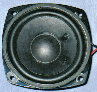

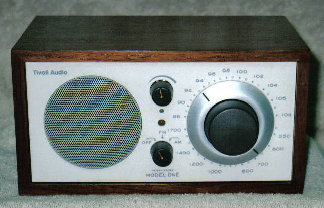

I bought a Tivoli Model One radio and am really suprised about the sound quality.
Any idea about what speaker is used?

Hi All,
I wonder anyone one has try to rebuild a box for the driver in the Tivoli Two. I realy like this tiny driver, and still don't know if they were made by Tivoli!!

Hi all
I had the Tivoli at the bed side table very close to my ears listening at very low level and I had observed that the middles were “dirty” and the bass excessive and boomy.
When listening from a distance and at higher level, these problems were not obvious (in fact boomy bass is an attribute that “sells” on this size of radios)
I opened it up, treated the cone with a dilluted plasticizer (two coatings), filled the internal volume of the box (not around the x-former) with fiberglass and stuffed the bass reflex tube with dacron.
Now, mids are much cleaner and bass not boomy but pronounced and tight.
Removing the protective screen from the front side of the speaker is another step forward.

I have both a Tivoli Model One and Boston Acoustics Receptor.
To my ears the Receptor is smoother sounding and has a more extended low end. If you want to reverse engineer something, I'd suggest targeting the Receptor instead of the Tivoli. In either case you can be sure that some type of EQ is also used. It is not just the box that accounts for the sound.

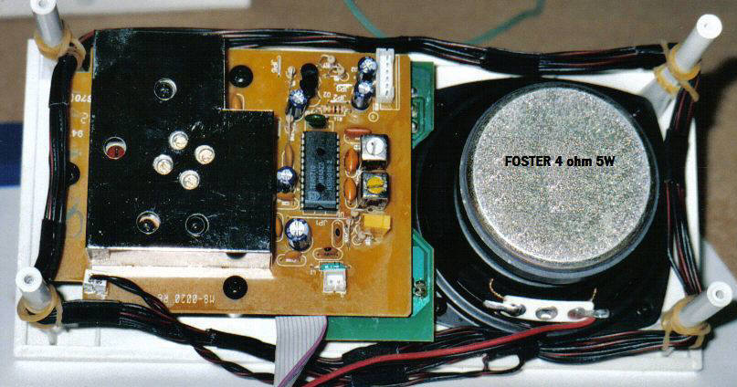

I have a Tivoli Model 2 attached to my PC as the speakers for it (retired from another use), and a model 1 radio in my office. They are OK, but the receptor radio on my nightstand is really much better to my ears, I'm in agreement with audiosteve.
I've got a bunch of pictures of the guts of my model 1. And I can take acoustic measurements of my model 2 if I am talked into it. I'll upload the pics of the model 1 shortly

Here's a couple pics I took of the Tivoli radio a few years ago. I should have taken more pics of the driver itself.

I'll try to find the pics of my Model One and post them. The port on mine is mounted on the bottom of the wood enclosure and mine doesn't have the bucking magnet on the driver.

Who can post detailled schematic diagrams of the various versions? I need it for service and for checking various enhancements.
And who knows the manufacturer brand from China ?
In my own device is the AM/FM/IF receiver IC TEA5710 from Philips in use:
