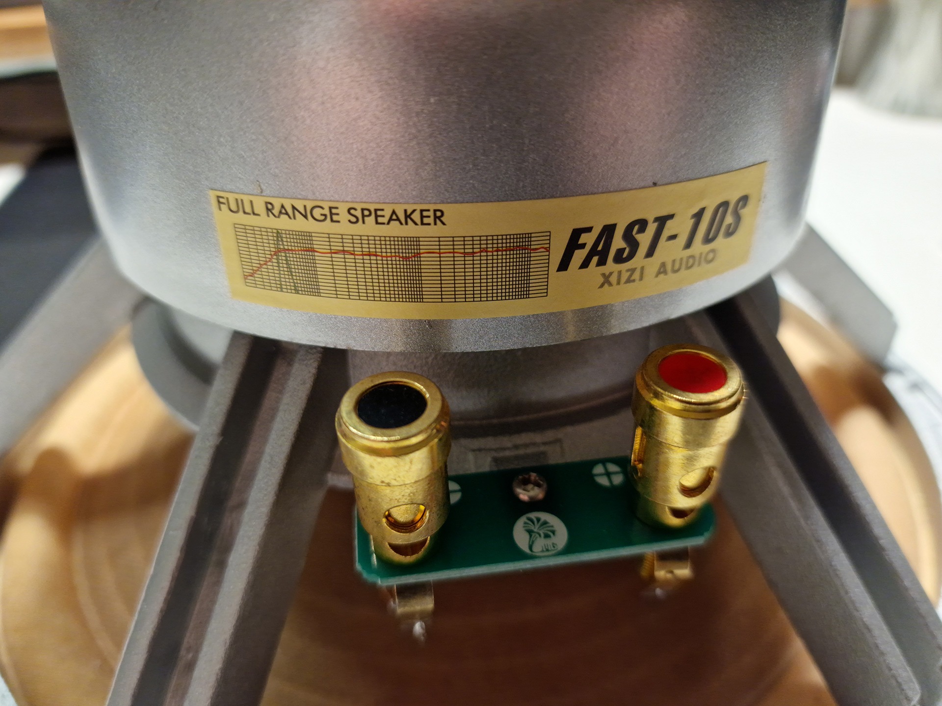

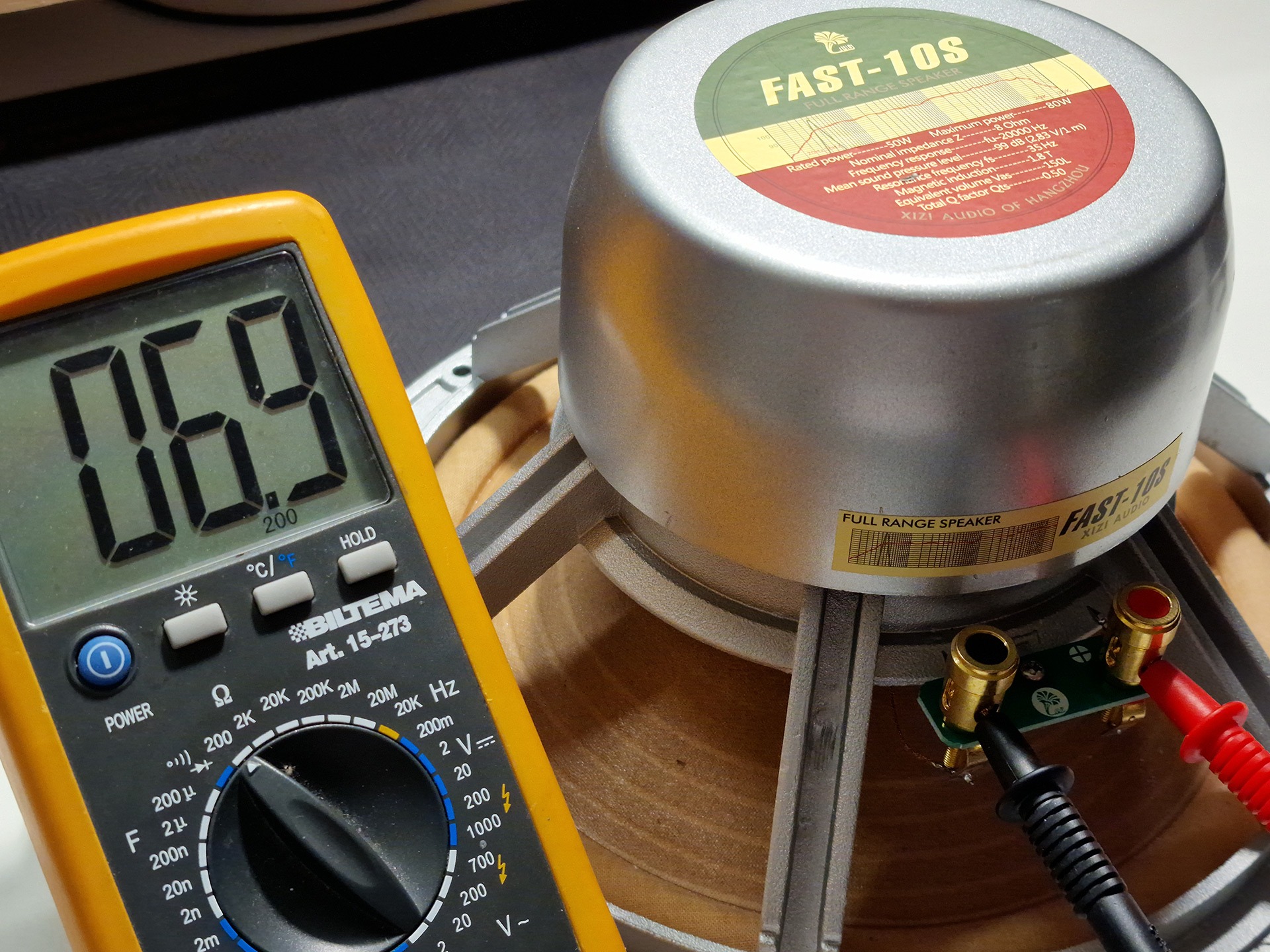

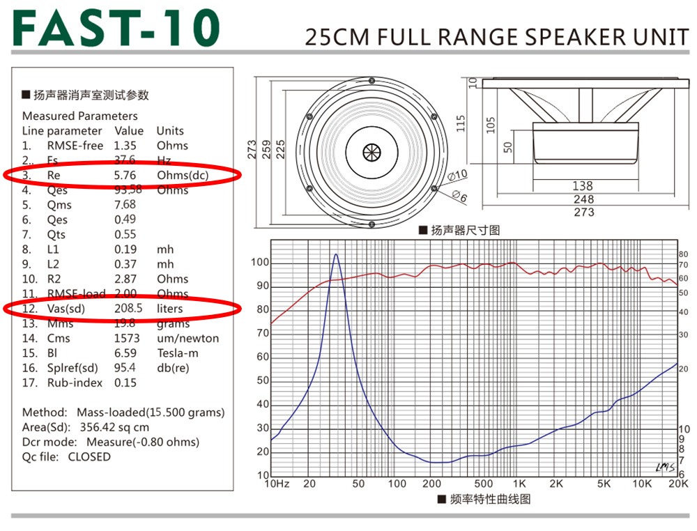

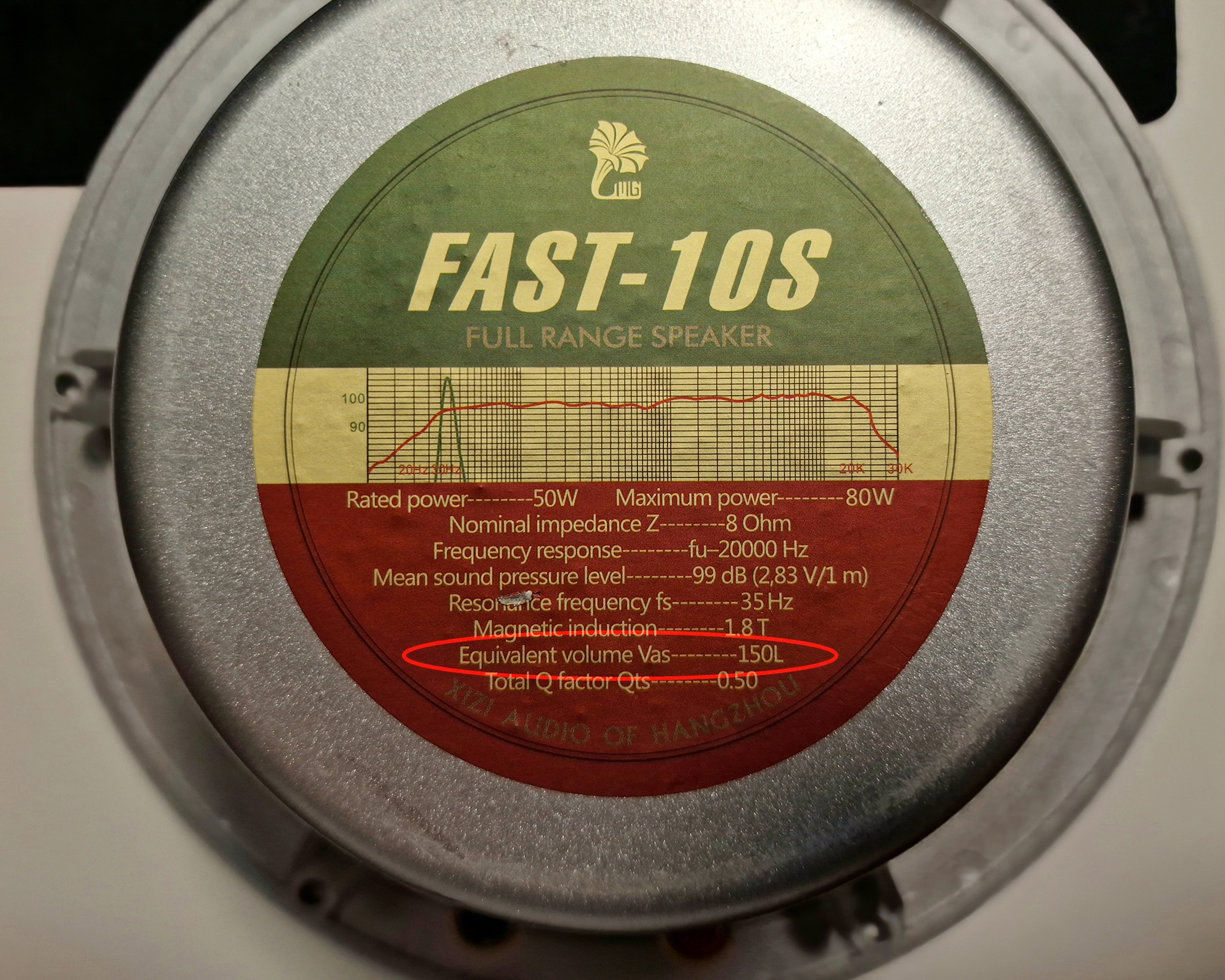

I'm the friend Zleepy mentioned. The problem is that Lii Audio's data sheet doesn't match with the speaker element that I have (see attachments). So I don't have the required information to model the enclosure. So I don't know how to proceed. The speaker enclosure schematic in original post, is the only version that specifies Fast-10 (https://www.lii-audio.com/dt_gallery/plans-for-cabinets-crystal-10-fast-10/). The "crystal" is different version of this speaker element.

OK, so what type/thickness wood are you going to use and then I'll just calculate the cab's gross Vb, subtract a bit for the driver, vent and some bracing to find basic box tuning (not sure ATM how the little vent might impact it), though typically with these type drivers it's tuned to Fs.
Reactions: Scottmoose
Hmm. Lii's data [such as it is] has often been so inconsistent with itself that even in instances where they provide sufficient to do more than SWAG it, you're left wondering what, if any is actually representative. I take no pleasure at all in saying that, and if it's been addressed in their more recent units, so much the better. Sans that -I'd probably just shove them in the largest sealed or open-back box I could handle & try to dial it in with a variac / similar from there.
Alternative: if you don't want to invest in DATS or similar, download REW (free) get a couple of resistors (peanuts), and follow the jig setup detailed in its manual. Assuming you have a reasonable soundcard and a suitable lead you'll at least be able to measure the basic T/S values on a low voltage drive. https://audiojudgement.com/measure-thiele-small-parameters-using-free-software/
