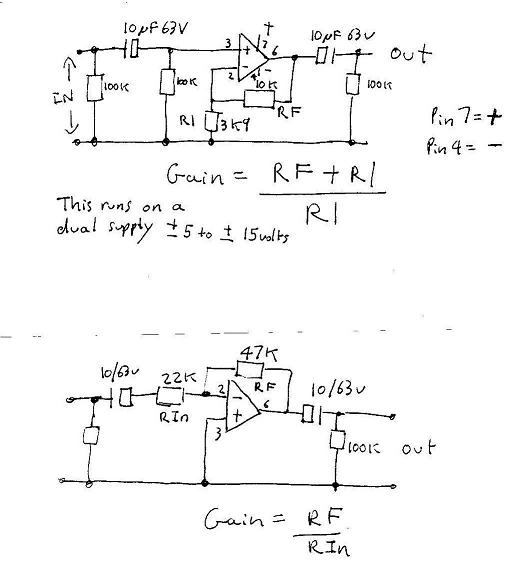

TL071 opamp circuit needed
hi,
i need to bost my input gain for my amp. i have seen that i can use opamp to bost the signal from cd player.
it gose like this....CD player-->--OPamp---> amp
i have TL071 ic for opamp. i need the circuit design for simple way to build opamp.
thank you.
How much gain do you need ? what supplies have you got ?
You need 2 opamps or 1 dual TL072. See image.
The second one is phase inverting but this configuration can sound better to me. You can add a small ( around 4.7 PF ) cap across the 47 K ( This is where you need your 'scope 🙂 )

Hi Space,
What supplies have you available ? You can make either run off a single supply ( with a few more bits ) if you have to, but the split supply is better.
Are you building this into that amp you posted the pics of ?
If you are it's easy, the TLO71 or 72 use so little power that a very simple resistor and zener is all you need for each rail supply.
Remember that R1 sets the input impedance so choose this first then work out what gain you need. The 22K and 47K should be fine though.
If you want the gain expressed as a ratio i.e. db, for the non inverting it is;
20 log*(RF+R1/R1)
And for the inverting it is;
20 log*(RF/Rin)
Are you putting a volume control after the Op Amp. Remember any switch on noise as the circuit settles will be amplified and add to any noise produced by the amp at switch on.
Just to clarify as I have used different terms ( just to confuse you 😀 ), the input impedance is set by the total value of the input resistance for the non inverting one, so that is the two 100k's in parallel. 50K therefore, input impedance for this one.
The inverting input impedance is determined by Rin. So thats 22K
hi mooly,
thank you. problem was equalizer setup for output gain.
now it is ok.......
this amp is ok now... thanks for your gain circuit, i will need it for future.
