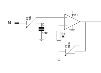

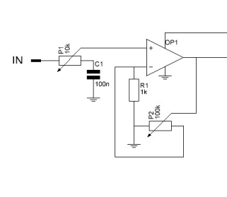

Hi. I'm trying to build a vu-meter with low-pass filter for line level signal, single power supply from 5 to 12 V and i need to set some kind of gain. In the attached schematic, when running some tests, OP1 was 1/4 LM324,everything works beautifully when replaced with TL071 all leds remain light up as there was no signal connected to the vumeter. What am i missing? TL071 can't work in single supply mode?
P2 does nothing. And C1 is wrong placed. I believe P2 is in between out and (-) input, and this way adjust gain. And C1 must be at the P1 to to block DC input. And if the case, there must be another C in the middle of P1 to input (+) and a voltage divider about VCC/2 to bias the (+) input.

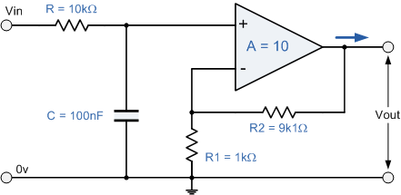

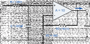

I tried to reproduce in my own way this schematic. Could someone propose a corect schematic for low pass filter with adjusstable gain, single supply?

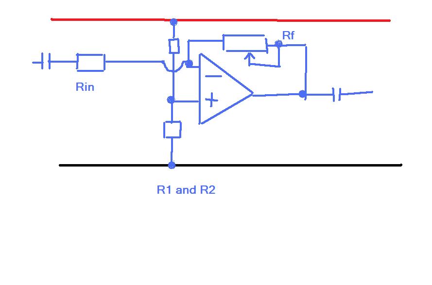

Place the Low-Pass filter at the input and use a simple resistor chain to give you a balanced supply.

The circuit in post #7 is OK but NOT for a single supply. It also needs "Vin" to be correctly biased.

If running a single supply then the opamp has to be biased accordingly... that's easy, but is it going to do what you want ? The output will be at half supply. This all means the input and output has to be AC coupled unless it's incorporated into somthing that provides the appropriate bias and works with the output at midpoint.

One feature of the '324 is that the common-mode range includes the negative supply rail. (Maybe even a few mV below the negative rail.) The TL071 isn't guaranteed to work with common-mode voltages any closer than 4 volts from the rails.Some opamps can't work with inputs right on a supply rail. Read the datasheet to find out.
At the very least, you need some variant of a 2-resistor "rail splitter" on the non-inverting input.
