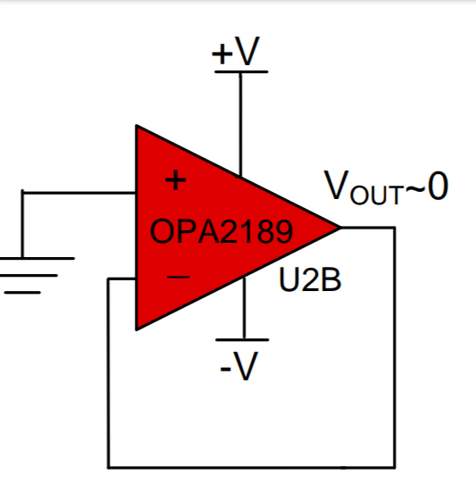

A TL072 is two TL071 in one package. To turn a TL072 into a TL071 make an adapter that connects one of the opamps in the TL072 to pins 2, 3, and 6 and the power supply to pins 4 and 7. I would configure the remaining opamp in the TL072 as a buffer and ground its input just so it doesn't chatter or does anything irrational.

That's exactly what I suggested in Post #2.You can terminate unused channel Like this.
