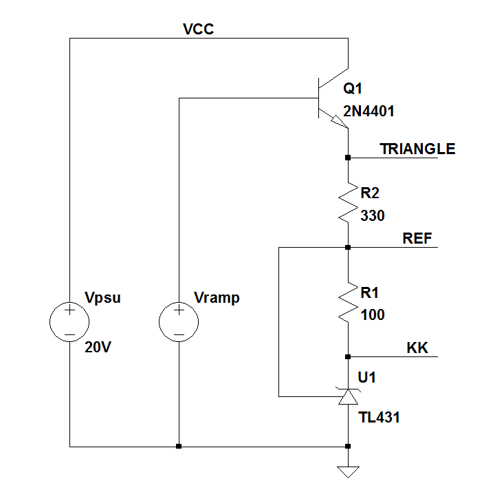

A DC power supply sets VCC=20V. A function generator provides a 12V peak-to-peak triangle wave at 200 Hz, which drives the TL431 by means of an NPN emitter follower. Resistors R1 and R2 form a voltage divider whose midpoint drives the TL431's "Ref" terminal.

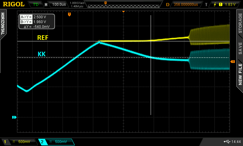

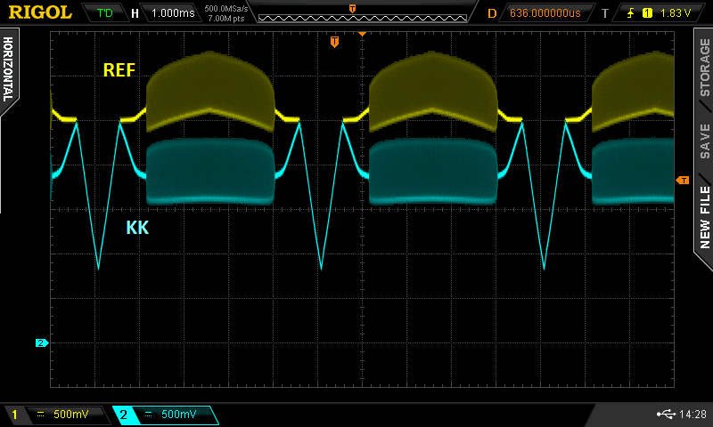

Scope picture 2 shows nodes REF and KK (sorry, it's just a 2 channel scope!). When REF levels off, KK starts to fall. Eventually the TL431 drops out. A magnified picture of dropout is shown in picture 3.
I've put horizontal cursor A on the REF node @ 2.500 volts, and horizontal cursor B on the cathode node KK, at the point where dropout occurs, in my opinion. REF is no longer regulated, it begins to rise. KK continues to fall a bit further, and then Boom! it all blows up in ugly oscillation. The dropout voltage on the cathode is 1.96 volts, as shown in the cursor popup-box.
Case 1: Suppose node "TRIANGLE" (the top of R2) is at 2.7 volts. Node "REF" is 2.5 volts, established by the TL431, and so a current of (2.7-2.5)/330 = 600uA flows in R2. This same current flows in R1, so node KK equals (2.5 - (100*6e-4)) = 2.44 volts. The TL431 does not "drop out" (cease regulating) when its cathode is so very close to 2.50 volts.
Case 2: Now suppose node "TRIANGLE" is at 11 volts. If node "REF" is 2.5 volts, then the current in R2 must be (11-2.5)/330 = 25.7 mA. The voltage dropped across R1 must be (100*2.57e-2) = 2.57 volts, which means the cathode "KK" is below ground! Thus we have a contradiction; node "REF" cannot be 2.5 volts in this case, so the TL431 has "dropped out" (ceased regulating).

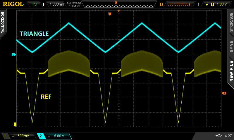

I've attached scope photos showing the entire ramp from 0 volts to 12-Vbe volts and back down to 0. Scope picture 1 shows the TRIANGLE node in blue @ 5.0V/div, and the REF node in yellow @ 0.5V/div. There's only a small zone where REF sits at its regulated output voltage, 2.50 volts -- that's the flat spot where REF is a horizontal line. Below that, the input is too low; above that, the TL431 "drops out" -- its cathode voltage falls so low that regulation ceases. As the input voltage rises, the current thru R1 rises, the cathode "KK" of the TL431 falls, and the circuit oscillates (!).Case 2: Now suppose node "TRIANGLE" is at 11 volts. If node "REF" is 2.5 volts, then the current in R2 must be (11-2.5)/330 = 25.7 mA. The voltage dropped across R1 must be (100*2.57e-2) = 2.57 volts, which means the cathode "KK" is below ground! Thus we have a contradiction; node "REF" cannot be 2.5 volts in this case, so the TL431 has "dropped out" (ceased regulating).
