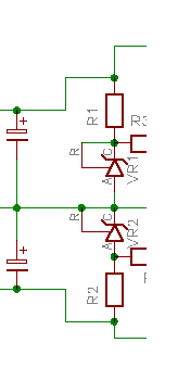

Hello everybody
I'm trying to build a +/- 15V regulator using TL431 but I feel kind of clueless about the negative regulator. The regulator will be driving a JLH headphone amp(circuit 2 at http://www.tcaas.btinternet.co.uk/jlhphones.htm )
My idea is something like this for the positive supply
and something like this for the negative supply
I only have a trafo that will give +-34V regulated at the moment if your wondering about the high supply voltage.
I'm biasing the tl431 with about 10mA since that should be adequate.
Any thoughts?

It might work. One way to find out is to simulate it. You could use the freeware SwitcherCAD (LTSpice) from www.linear.com
The Vbe of the output transistor will be effectively substracted from the 2.5V reference so that negative arrangement is not practical.
You may connect the 5K resistor to the base instead of the emitter and use the TL431 as a plain zener, though. Otherwise, consider a LM337 1.5A negative regulator.

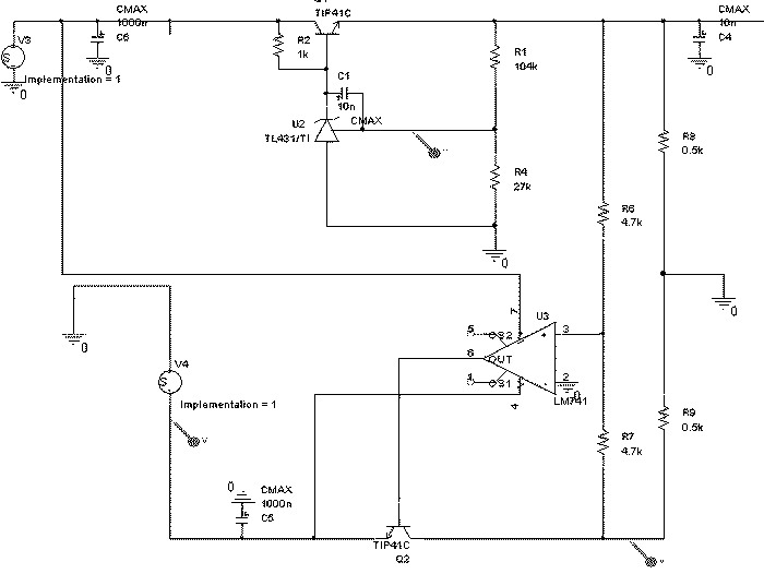

Hello, i am a newbie
i try to use tl431(lm431) to make a dual power(pos and neg dc) supply for OP that can replace 78xx 79xx lm317 and lm137 series
due to i think tl431 have better temputure performance than them,and tl431 is cheap
sorry for my english, too bad and too many wrong spell but i believe that you can understand
i don't know how to use tl431 for negtive power , i was confused, infact i design one, but use spice simulate, it can not keep the voltage, with the changes of RL(the load resitense) ,the voltage is change,so that can not fit my needs
then i found fairchild 78xx manual have a tracking voltage regulator schemitic that useing a OP and a PNP to just tracking and follow the Positive voltage,
so i use the typical TL431 plus a NPN postive regulator diagram and mix with the tracking way make this one
please see the pic i upload

q2 is wrong.
104k to 27r cannot be right (9kV output)
The 431 is a shunt regulator and you are using it much like a Zener with feedback. Is this a good way to implement a series voltage regulator?
U3's output is almost at -ve rail potential.

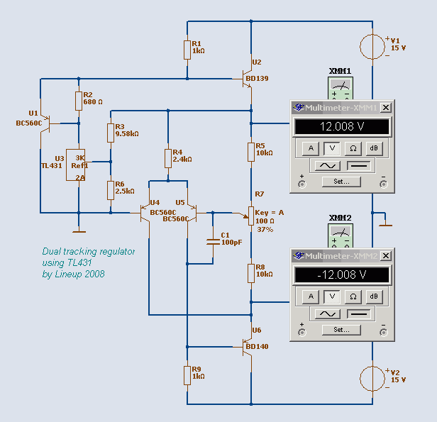

Hello, szcharle 😉
I have used same idea in a couple of dual tracking regulators I have built.
I use a discrete 'op-amp'.
Here two BC560C as differential amplifier for mirroring the positive voltage.
My schematic is a very simple version I created just to show idea.
Can be modified for higher gain and more output current, when needed.
Some notes:
- R3 and R6 sets the voltage output for TL431.
- Transistor U1 keeps constant current ~1 mA in TL431 (increased precision)
- The pair U4/U5 is the 'op-amp' that mirrors the positive Voltage
- R7 the 100 Ohm trimmer is for fine adjust the Tracking Negative voltage
- C1 is added for stabilty (avoid oscillation)
yeah,thanks! Q2 is wrong, in the Fairchild 78xx datasheet, the tracking schemic it is use one PNP, i changed it to NPN(due to i have a lot NPN and few PNP!)
change the Q2 to PNP and swap the Pin 2 and Pin 3 (inverting and non-inverting input of OP LM741) then it works ok!
i found this problem after i made a real PCB and power on
the Neg DC output is about -11.xxV (the input is -12V)
then i came here to check reply and i got you reply
the reason is the NPN, change it to PNP than all ok,
and the OP no need to use a rail-to-rail one, just a cheap 741 is ok!( in fact i suspect if real use a rail-to-rail maybe still got this problem)
and for the spice, i think the spice's simulate OP is too ideal! it ignore the can not rail-to-rail fact, so simulate is success.
thanks again, and I think this circuit is success now?
