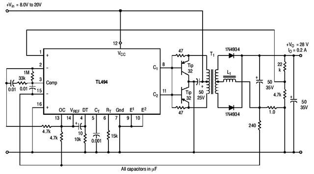

There is a lot of information on the internet about using the TL494.
I forget what Vref is on the TL494 but feedback is simply a matter of a voltage divider across the output to provide a feedback voltage = Vref at the output voltage.
It is usual to use an opto isolator sensing the output voltage. When it increases above the threshold set by you, the receiver signals pin 1 to turn off.

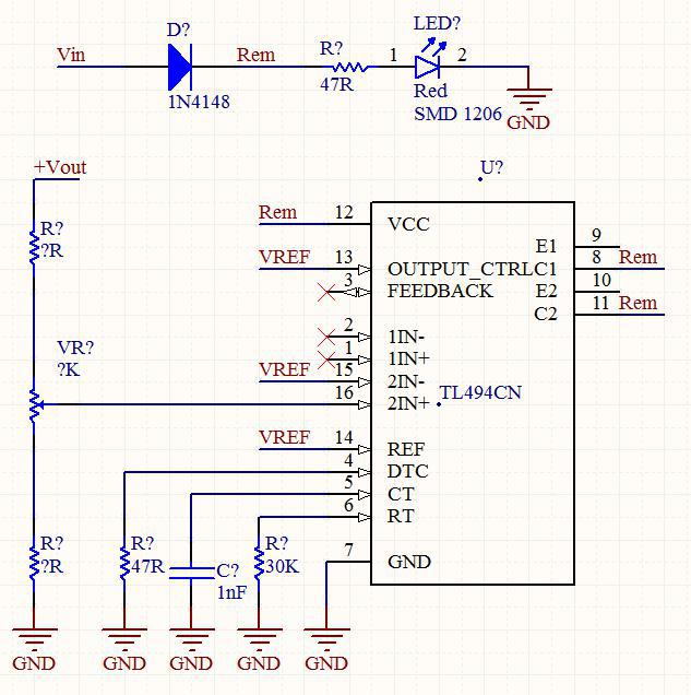

this is my sch for Oscillator
is this have problem?

The dead time resistance is 47 ohms. Almost this problem was resolved.
But when the potentiometer pin 3 is rotated to the negative (almost close to zeroing pin 3 of 494), the output will fall instead of the gain
The diagram is incomplete. Do you have a complete diagram?
Why the 47 ohm resistor on pin 4?
For now, connect pins 1 and 16 to pin 7. Connect pins 2 and 15 to pin 14.

Your friend may be confusing the 494 DT control with the DT control on the SG type driver ICs.
What do you mean that pin 3 is negative?
For now, disconnect the potentiometer and connect the IC as suggested in post #9.

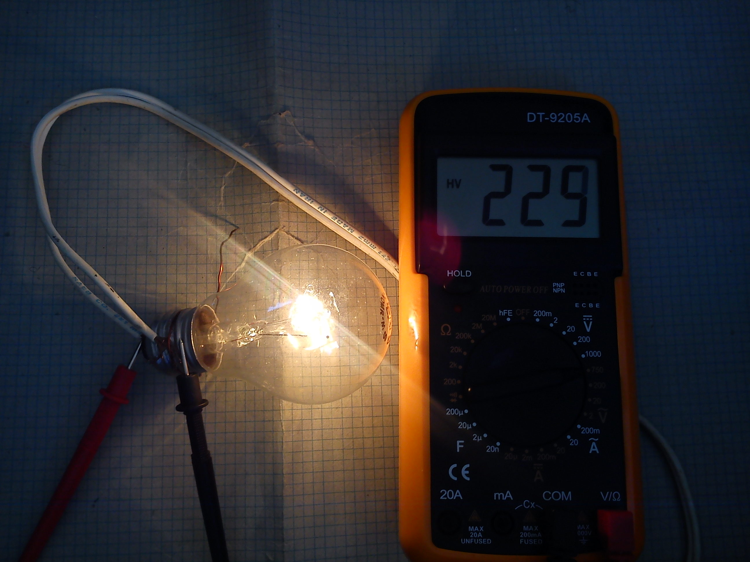

and IC works well
Thats output:
But when I turn pot pin 3, one of the MOSFETs gets hot.
I do this "connect pins 1 and 16 to pin 7. Connect pins 2 and 15 to pin 14. "and IC gave a very low output for a second, and then it turned on
If the IC is constantly detecting Vin < Vref then it will try to increase the output. As this will not increase Vin the IC will eventually result in 100% duty cycle. Hence one MosFET will be hard ON.

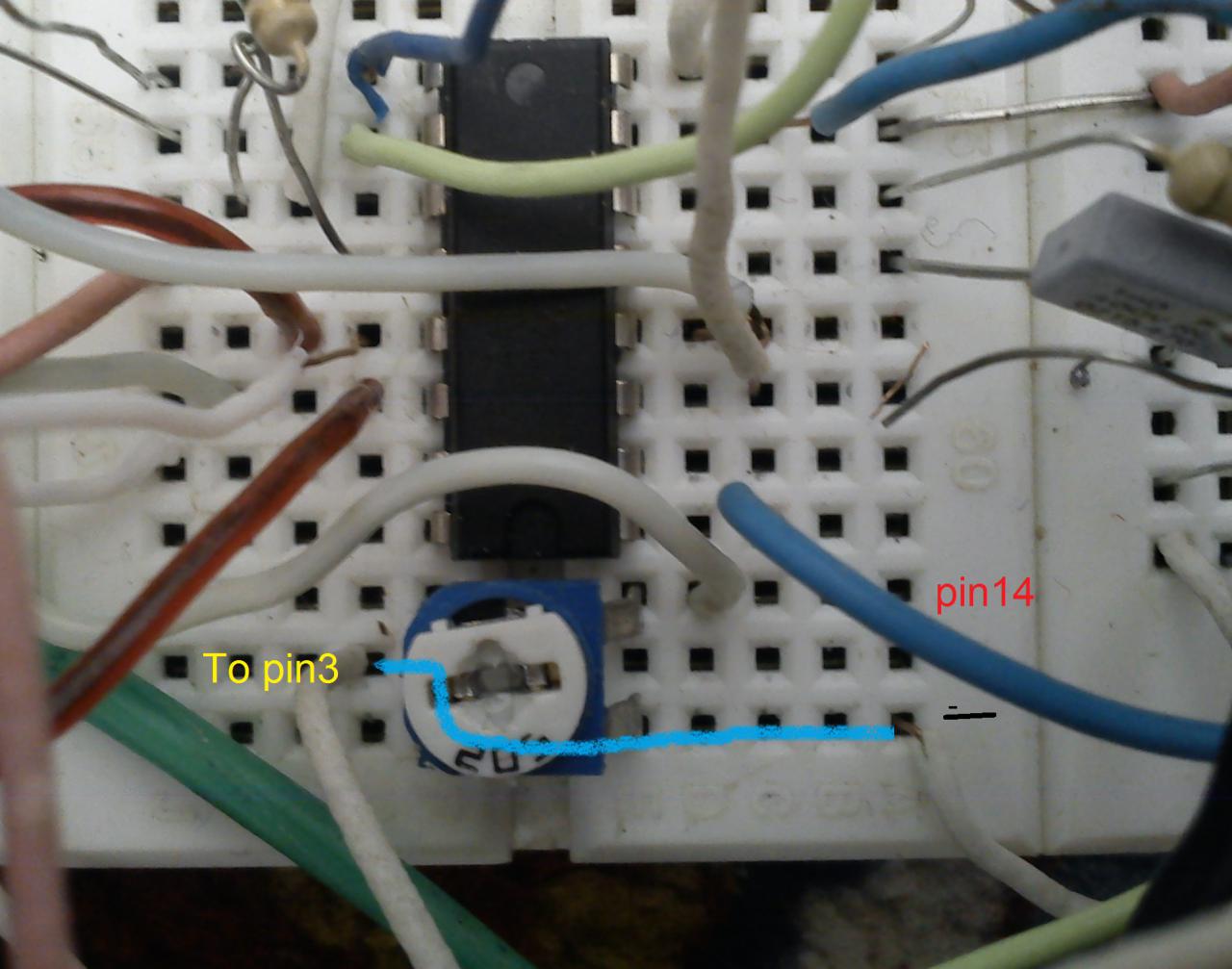

when i turn pin3 pot What features of ic changed?
Pin3 is connected to gnd(because the pot of the pin is turned to the gnd completely)
