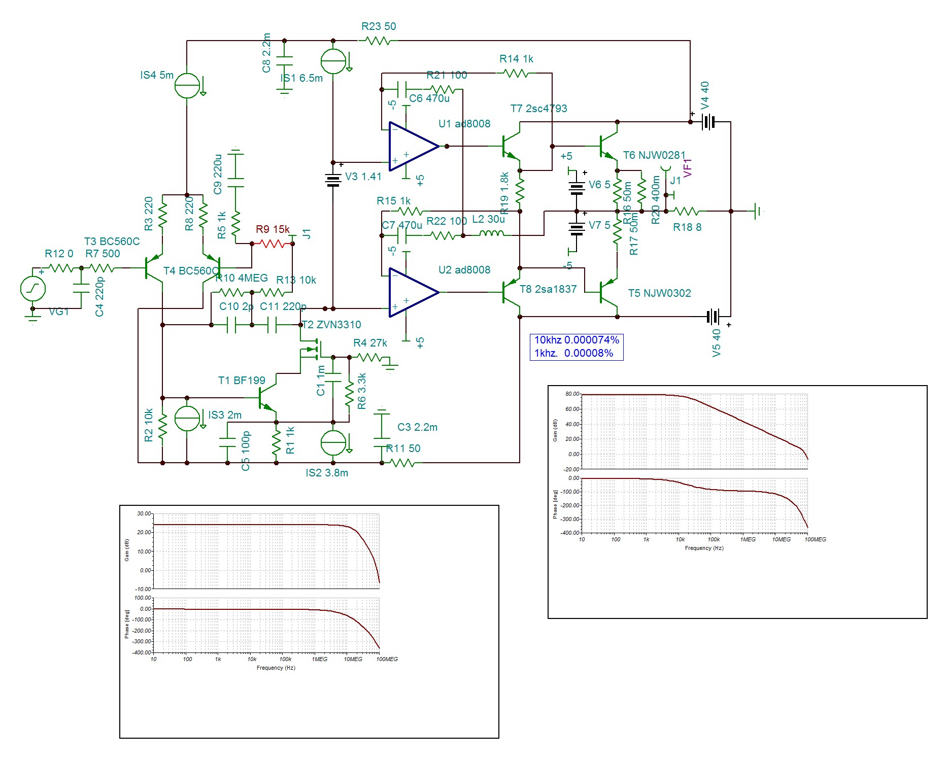

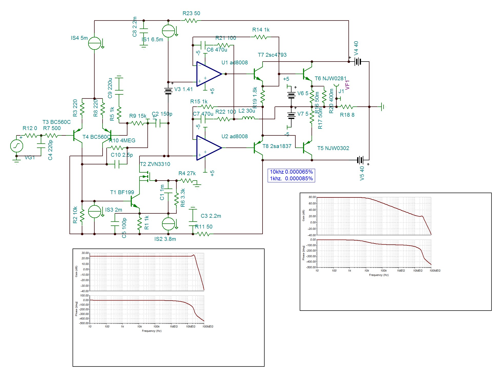

I formed a simple amplifier to test these compensations. Most of the distortion measured is noise.Output 30Vp
posted order TMC Miller Cherry and mine bellow.
