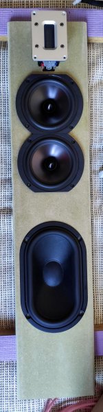

Hi I'm designing a box with 2 Dayton RS150T-8 (40W each) in parallel combined with a passive radiator. (and a tweeter but not important here 🙂)
What I'm now seeing is that at (very) low input (10v) 25W the basta simulation excursion graph show that I'm at Xmax ? Actually much earlier if I take the frequencies lower than 44 Hz into account.
Anybody willing to explain this please ? (I can reduce the box Vb but then the charterictics are way off) ps, vent / passive radiator are exact as per vendors parameters. (SB15SFCR-00)

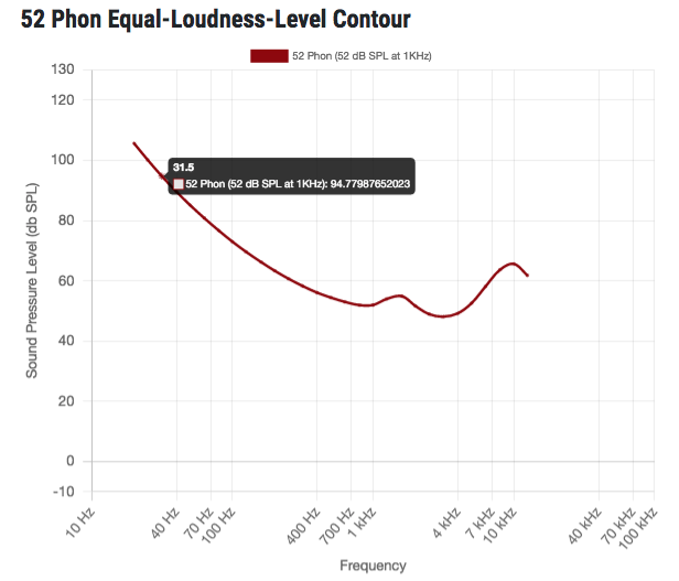

Though LF fundamentals may be -10dB (or less) in most acoustic recordings, note that the OP's simulation response has dropped to -10dB at 30Hz, and has reached Xmax for both the driver and passive radiator at 95dB.
Due to our hearing being less sensitive to low frequencies ("equal loudness level contour"), an SPL of 95dB at 30Hz sounds about the same level as 52dB at 1000Hz, about half as loud as an average conversational level at one meter.
