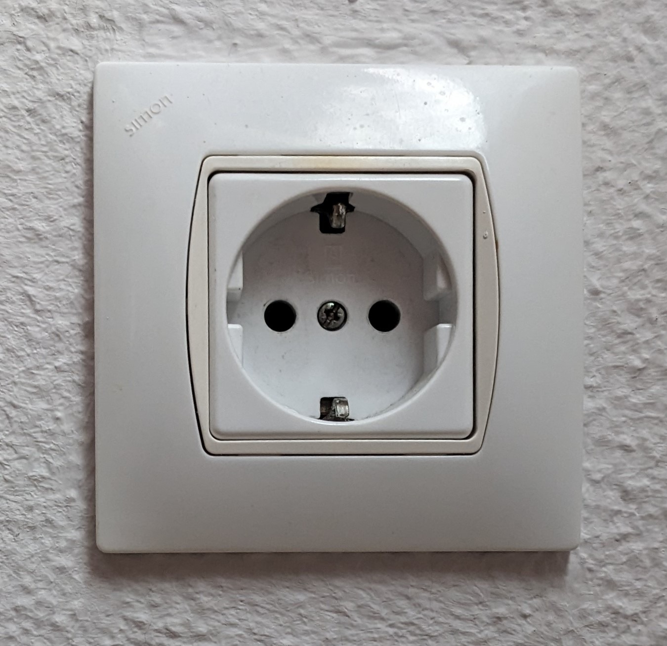

If you look at he socket there are only 2 plug holes with live wires, the third one is a screw.
I don't know about rules and regulations but the praxis is to have earthed plugs in rooms where you can touch water pipes ... etc.
Double insulation is beyond me too.

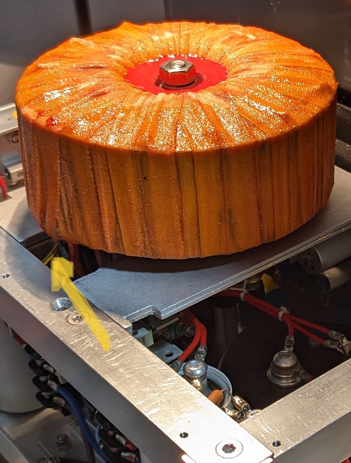

There is a metal shield between primary and secondary on my donut, don't know if that is sufficient?

My toroidal trafo is resting on 2 rubber sheets and the bolt goes through epoxy in the middle, son no part of the trafo is touching the chassis.
... apart from the wire from the shielding between primary and secondary.

Picture of an earthed socket below.
RCCD's work by sensing the difference in current between live and neutral, ie detecting leakage from the circuit to anywhere (in practice to earth), so you don't need 3-prong sockets for it to work.
