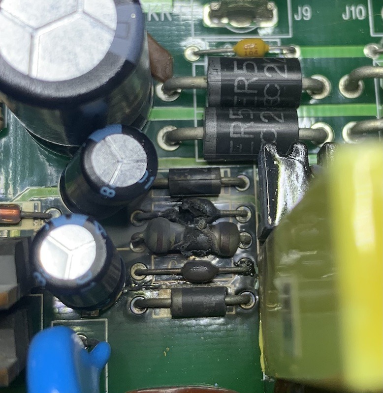

Hi, I have a set of PSB bookshelf speakers with subwoofer. The subwoofer is the Alpha Subzero1 (pictured).
The subwoofer is not working at all so I removed the power supply / amplifier board from the unit and discovered several destroyed components where the red oval is (pictured):
The components appear to be 1W resistor, a couple Tantalum capacitors and a couple of power diodes. The damage has extended to the PCB where a copper trace in that area of the board has lifted.
My question is whether or not I should try to repair this board or just abandon the idea and buy a new subwoofer? Thanks for your thoughts.

I would agree, robmack, that the board is not worth fixing - although I would have broken the news more gently. 😉

This is good and honest feedback. I'm also peeved that there are no service manuals or schematics for this speaker to be found because I could fix it if they were available. I guess I'm in the market for a new powered subwoofer. Maybe I can recycle this as a passive subwoofer, who knows.

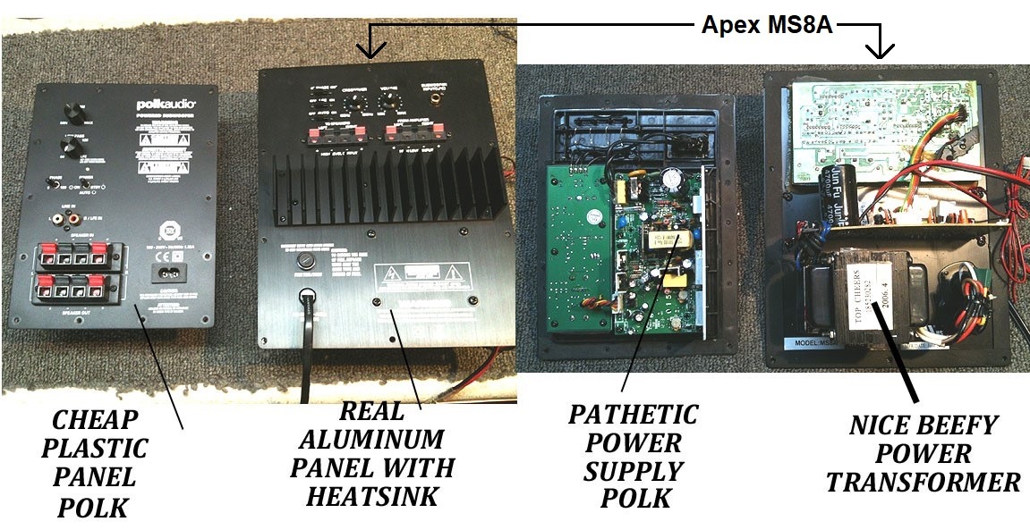

For me, it has nothing to do with a cheap "Chinese SMPS" and more to do with the fact it's the lowest end PSB sub they ever made. Even if it was a 5 minute 5$ repair, I'd just take the driver out and sell it. You could also just turn it into a passive sub if you have another amplifier already.
The trouble with these 'toss away' junky things is the cheapening caused by those lousy SMPS power supplies.This is good and honest feedback. I'm also peeved that there are no service manuals or schematics for this speaker to be found because I could fix it if they were available. I guess I'm in the market for a new powered subwoofer. Maybe I can recycle this as a passive subwoofer, who knows.
I've seen plenty of them come across my service bench at the shop - all brands.
Initially, they used a linear power supply before the cheapening started.
Those linear (traditional power transformer) supplies cost more, but the reliability and service life are much better.
A relatively expensive Polk sub, (popular brand) lasted 2 years and crapped out. - SMPS failure.
So, I replaced the whole plate amp with a linear-powered one.
It's been working fine for years now, the customer is happy.
Of course, I had to do some minor modifying - opening up the mounting hole.
See photos...
Look at the price point between those two devices though. Nevermind the extra carbon emissions from shipping a transformer across the planet.
Also looking by it, the Polk is class D so it doesn't need heatsinks - it's not that they left them out because they we're cheap.
My subwoofer set up cost me about 400$. Yorkville AP1200 bridges for 8R - 950WRMS powering a 15" passive car sub and driven by a Behringer CX2310 crossover set to 10Hz... Works better than any powered sub I've seen anywhere near that price point.
The Subwoofer the OP is asking about sells for about 100$CAD on the used market.
