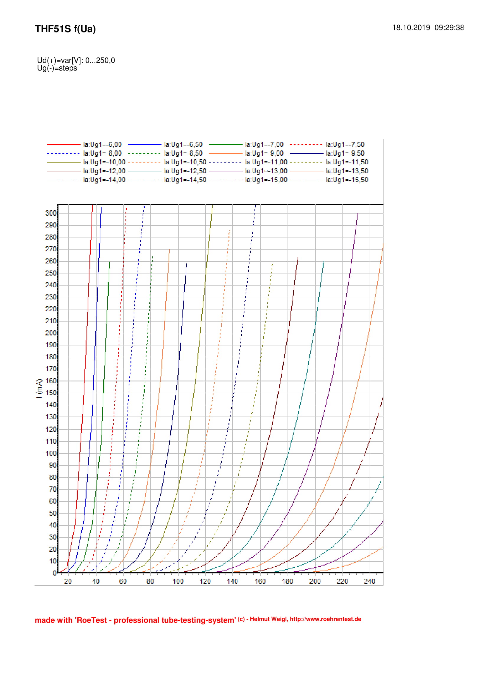

Tokin SIT THF51S curves high tension low current
Here some infos about THF51S curves at low current high tension measured with ROE TEST by Helmut Weigl. More interesting the link in which Helmut analyzes the four samples I sent him
http://www.roehrentest.de/SIT_EN.pdf

very nice information , is there a similar test with the THf51S avalaible with low voltage , high current ? 🙂
Unfortunately not. ROE test was created to analyze the behavior of the valves, therefore the maximum current is limited to 300ma.
If further tests are positive, my idea would be to create a two-stage hybrid amplifier SE (input transformer, valve maybe DHT, interstage transformer, THF51S, output transformer) using the THF51S high voltage and 200 / 300ma to get 15 / 20 watts. Dave Slagle of Intact Audio has already produced transformers similar to your Tango FG50S and could design "ad hoc" for this need

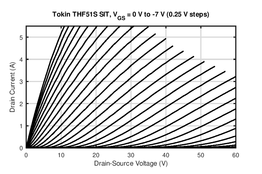

THF51 curves data
I couldn't find any good curve traces from THF51 out there. Here are mine, maybe they are useful for others. The data are in the ZIP attachment.
I was not sure about the THF51 power / voltage / current limits. If someone could shine some light on this, I might run the traces a bit further into the "hot" area.

Yes, I saw those. These data were measured with a curve tracer designed for tubes, so the current range was quite limited. That's why I wanted to get better data at higher currents.

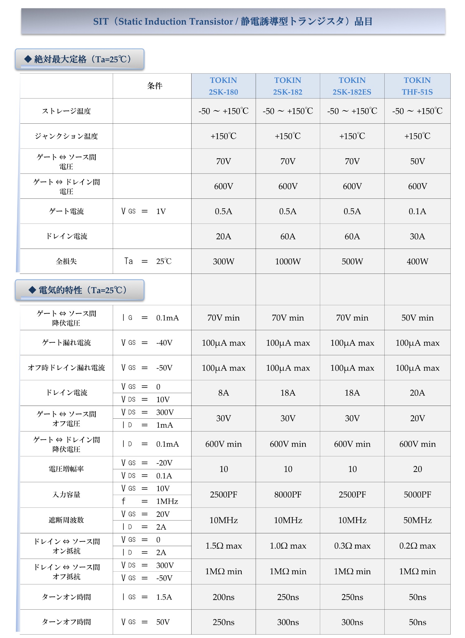

THF-51S
Pmax = 400 Watt's
Vmax=600V
Imax=30A

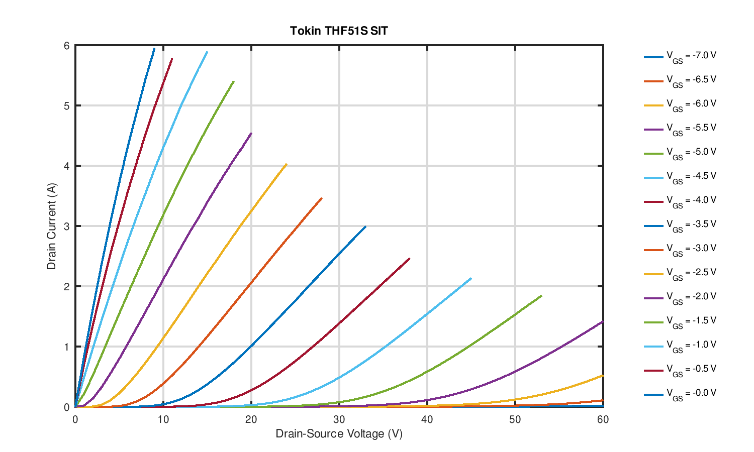

Perfect, thanks! I couldn't take my parts up to 400 W because the heatsink was getting very hot, and I didn't have the guts to take it higher than 200 W (about 90°C heatsink temperature). What is the 150°C spec in the table? Max. heatsink temperature, or max. part temperature? I attached the updated data.
These parts are great! I want to build something with them...
