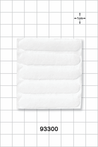

I’ve used (as part of a rewire kit) a square cotton pad like those used for makeup removal. Merely placed into the arm, it worked very well.
