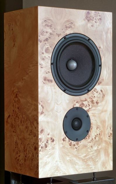

I'm very interested in Tony Gee's Plutone speaker.
I have problems finding any reviews of them.
Do any herre know if there is any review of these speakers?

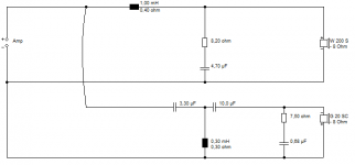

No idea about reviews, but if you are willing to shell out for these excellent drivers in a big reflex box, I don't think you will go far wrong.
Humble Homemade Hifi - Plutone

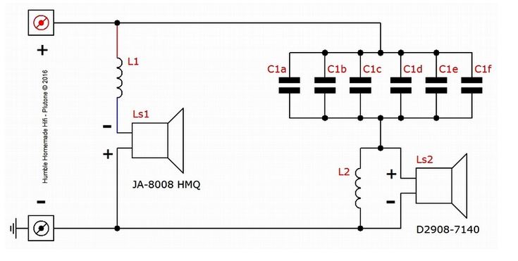

TBH, I think the crossover is overly simplistic, and won't play well with classical music. But an excellent Jazz speaker. It's probably 1.2mH coil on the bass and 3.3uF and 0.3mH coil on the tweeter.
Just buy aircore coils and some reasonable single capacitor and it'll sound good. Improvements might come later on crossover. It's quite John Devore Orangutan or Snell or Audionote IMO. Sort of thing I like doing.

Well, TBH, and I could be wrong on this, but I think it's highly unlikely the 6 capacitors in parallel will do better than one reasonably competent one. 🙂

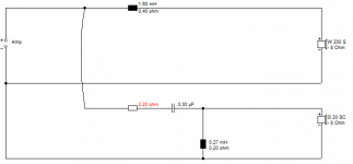

It looks like Troels needs a notch filter to achieve this in Quattro. Blue line without notch, red line with notch.
- but Tony doesn't need notch filter to achieve this
Could it be that the cabinet design makes it unnecessary to have this notch filter?
It's 1 big fancy cap with 5 smaller and not all the same "flavor caps" in parallel. Too much fairy dust for me 🙂
C1a = Intertechnik Audyn True Copper Max / 630VDC or Duelund Coherent Audio Copper Silver Hybrid / 100VDC
C1b = Foil bypass cap / 3000VDC
C1c = Foil bypass cap / 3000VDC
C1d = Foil bypass cap / 3000VDC
C1e = Foil bypass cap / 3000VDC
C1f = Foil bypass cap / 3000VDC
It uses extraordinarily expensive components (€3,390 for a matched pair without wood) in a budget 2 way speaker configuration using an unbraced, undamped cabinet that adds nice sounds to the output from the drivers according to the author. The damping for the air appears to be carefully arranged where it will be least effective as seems to be visible in the impedance trace. The appeal of such a speaker is likely to be extremely limited but, given there is clearly a market for Audio Note-type speakers, I wouldn't expect it to be zero. It will be interesting to know what you think after you have heard it.I'm very interested in Tony Gee's Plutone speaker.

Review (in dutch only, sorry) by a sound engineer who listen to all types of music including classical and jazz:

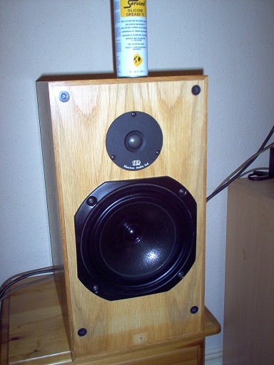

I've been down this road myself. Below is the Robin Marshall Monitor Audio R300-MD, with a SEAS 19TAF/G metal dome. The original circuit didn't quite float my boat. And I favour a 3rd order near BW3 these days, smoother and flatter power response, but less immediate of course. All is compromise.

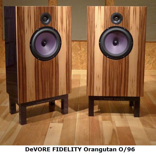

John DeVore claims never to use resistors in his crossovers, but do we believe him? 😉
The notch was used only on previous version of JA8008:
"Midwoofer crossover could be simplified with the new JA8008-HMQ driver as the RC circuit across L2021 could be omitted." from current Quattro page.
