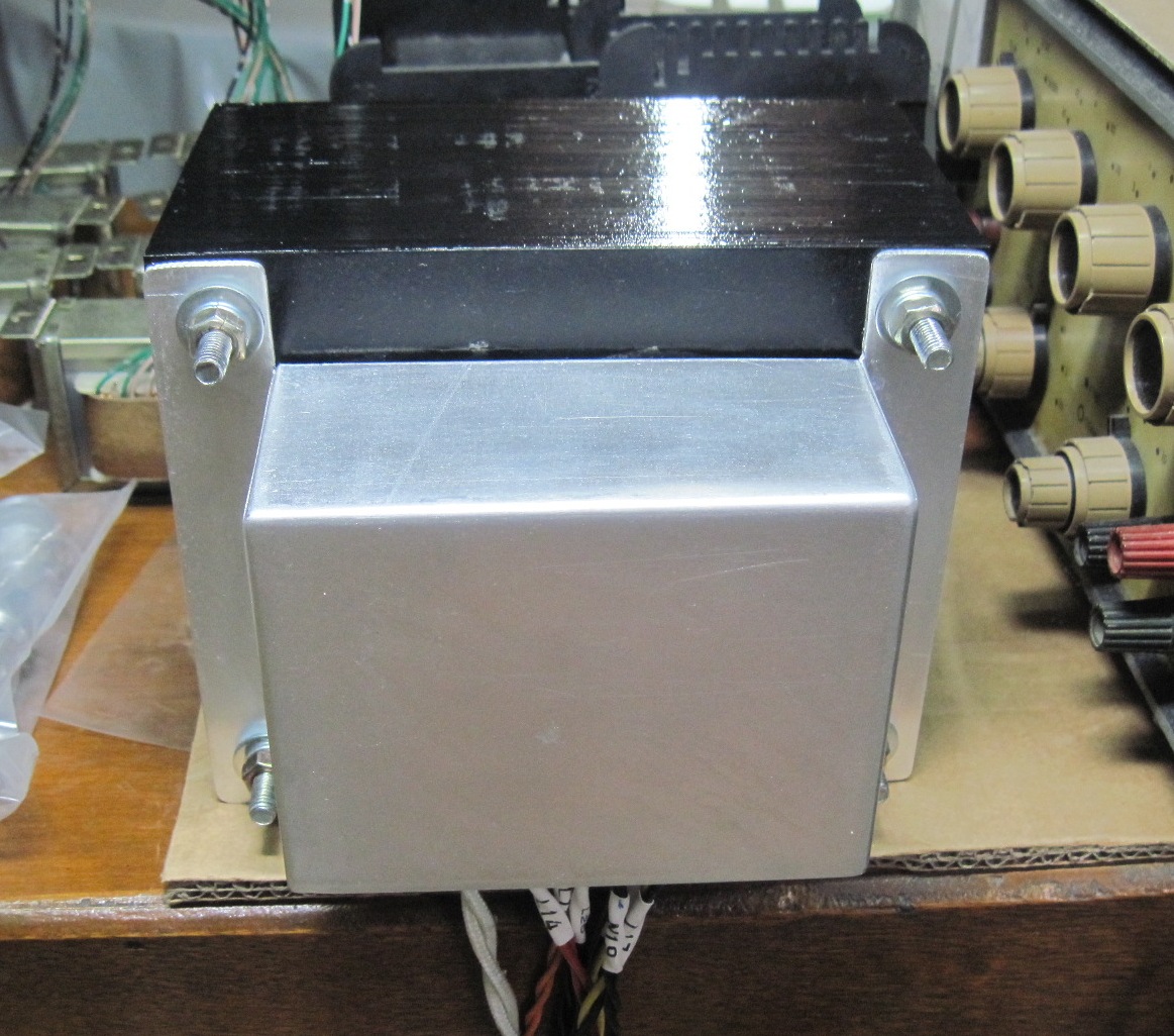

this is a power traffo using a 2inch center leg stacked to 3 1/4 inch DEECO silicon steel (noss) irons..
specs are as follows:
primary: 220 volts 60hz.
secondary1: 250volts at 2amps.
secondary2: 100volts at 0.5amps
secondary3: 12.6volts at 10 amps
secondary5&6: 6.3 volts at 3 amps
completed, there are 3 chokes sitting on top, 1/2inch, 5/8 inch, aqnd 3/4 inch.
testing prior to dipping in polyuretahne varnish

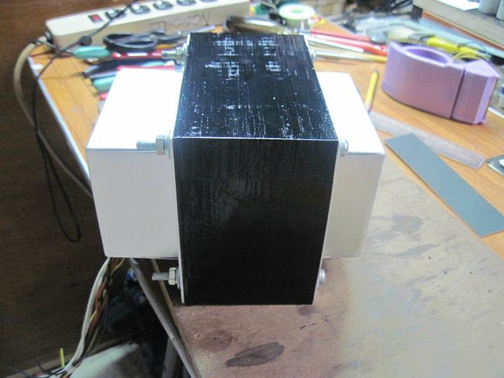

Big? not really, core is a 1 1/4inch squared, core rating of about 75VA,
primary at 220volts,60hz, 950 turns of #24 magnet wire, layer wound.
secondary1 at 120volts, 0.4 amps, 570 turns of #27 magnet wire, layer wound
secondary2&3 at 6.3volts center tapped, 3.0amps, 28turns of #18 magnet wire..

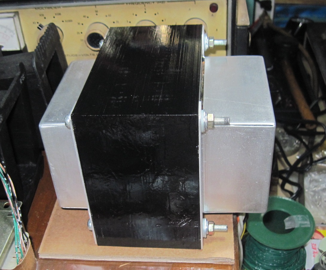

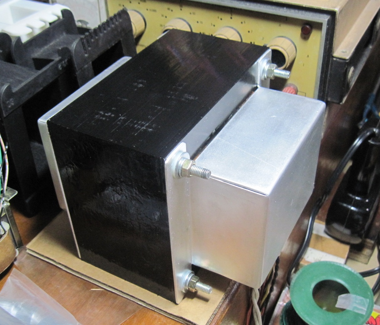

update:
after painting the traffo, i had some aluminum covers made, since no end bells can be found anywhere for 2inch cores that i know of:
