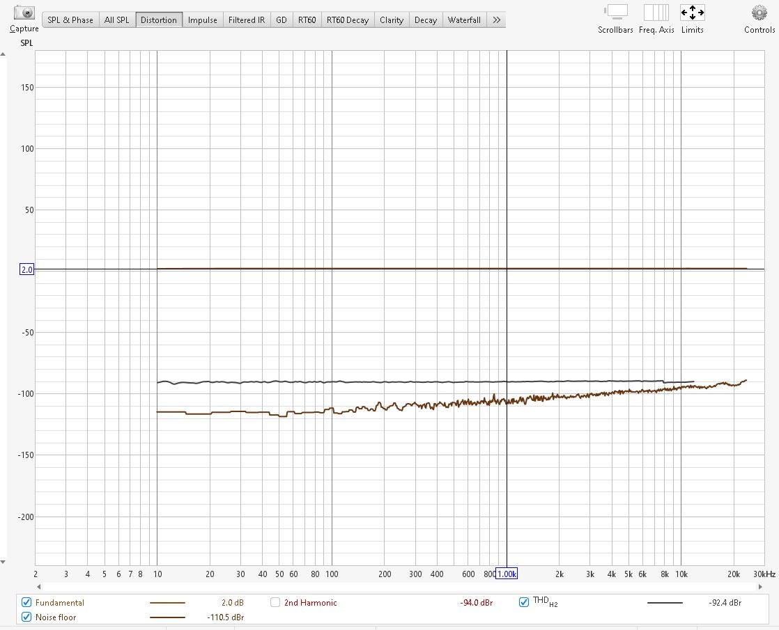

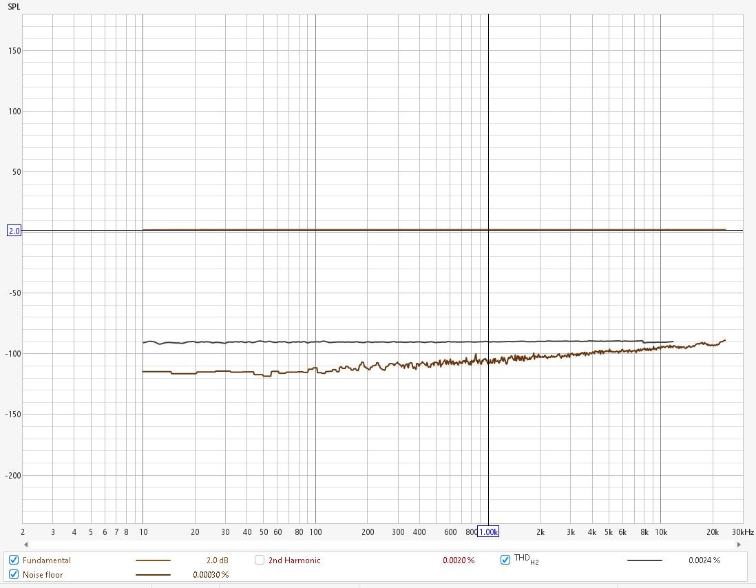

I tried the REW and it's very good, I took some measurements and please I would like to ask you how to measure the dynamic response of an audio unit, etc the sound card or a preamp?
Here are the measurement of my SSL sound card. The -110.5 dBr is the dynamic range?

I concur with the REW+soundcard/audio interface approach for budget distortion measurements. Your soundcard seems to be pretty good - certainly suitable for assessing distortion of many DIY audio projects. You probably want to plot more harmonics, though. There is no guarantee that H2 is the dominant distortion, and it is useful to see how fast the harmonics fall-off with frequency.

The dynamic range is defined as the ratio of the amplitude of the maximum possible signal (without distortion) of the device to the noise floor of the device.
So, first find the maximum signal that can output the device without distortion (for example +15 dB with a distortion of 0.1%).
Then find the noise floor, for example -110 dB.
The dynamic range is then, 125 dB (+15 - (-110) = 125dB).
