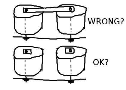

I have two toroids I need to mount, so I would like to understand this problem correctly in order to avoid it. I have drawn very rough sketch on how I understand deduikertjes connected his and how I would connect mine - is the drawing correct?
I won't be using any metalbar on top of the toroids - so they will only be connected on the bottom plate.

You are kind of right....The clamps don't have to be magnetic, as long as it's electrically conductive, then it will act as a single winding seen from the transformers point of wiev.
If yo use non-electrically conductive material, there will be no problems, Elvee's solution is also useful, and cviller's as well. Just no short circuits
