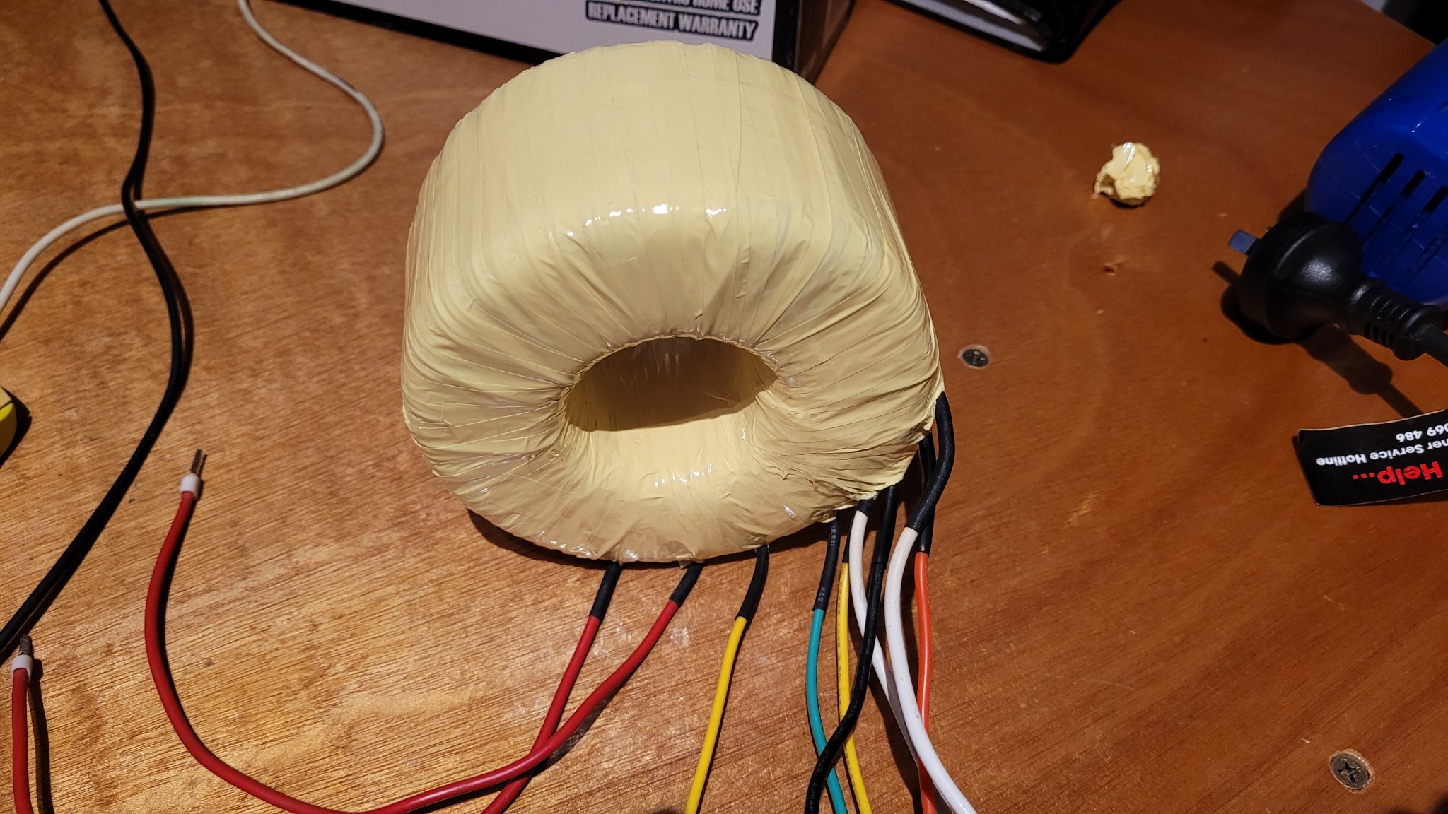

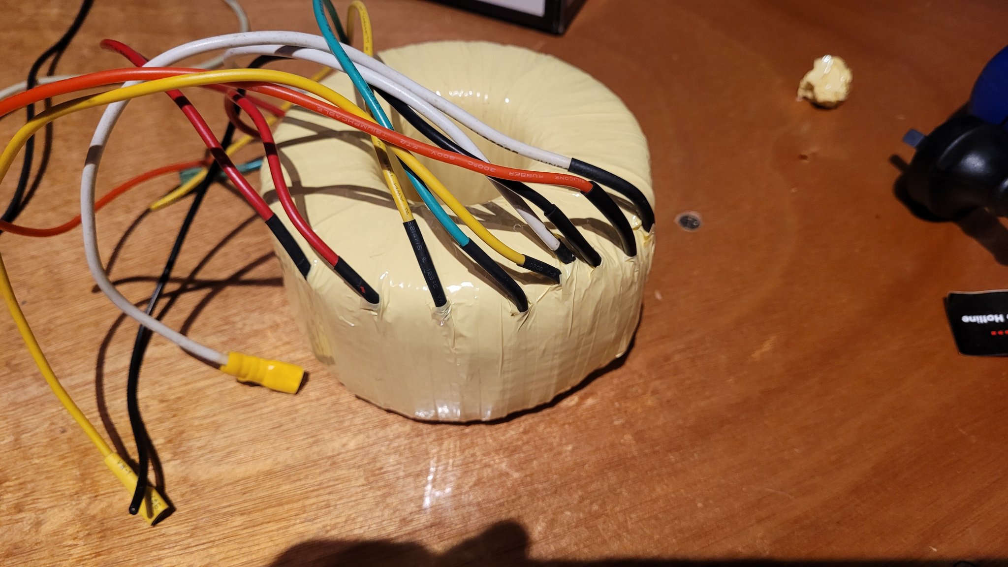

G'day Guys,
I've finally received all the bits and had some time and patience to do this one.
Everything went well. the old insulation behaved nicely and rewound back on without too much difficulty.
I did a horiztonal layer of #56 around the outside just to make sure all of the old insulation wasn't going to move.

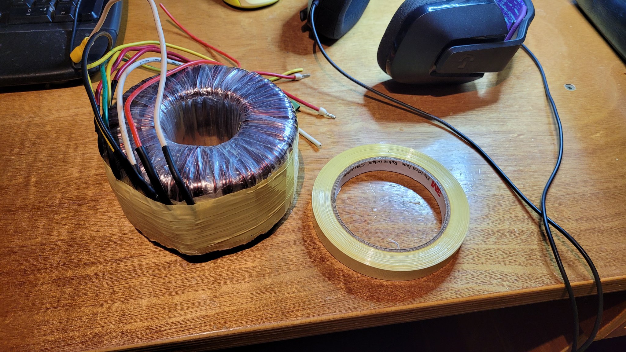

I would still like to do a full layer of #56 just to make damn certain the insulation wont fail. However I have a dilema.
As can be seen from the photo, the roll of $56 tape clearly won't fit through the centre of the donut.
The best I've come up with so far is to simply uncoil the required length of tape and feed it through in the same way I had to with the original clear insulation.
This seems unlikely to work as the chances of NOT creating a sticky mess seem incredibly low.....
Anybody have any suggestions for how I might get around this?

Rewound piece of tape on a smaller core, perhaps on a strip of cardboard or squash it and use as a shuttle.how I might get around this
Because that yellow tape is adhesive, you can wrap it a couple of turns at a time. That stuff will stay, especially when stuck to itself. It takes more time and a little more material than doing it as a single piece but you don’t have to fight it.
i will compress that tape roll to form an oval so it fits the toroid hole...

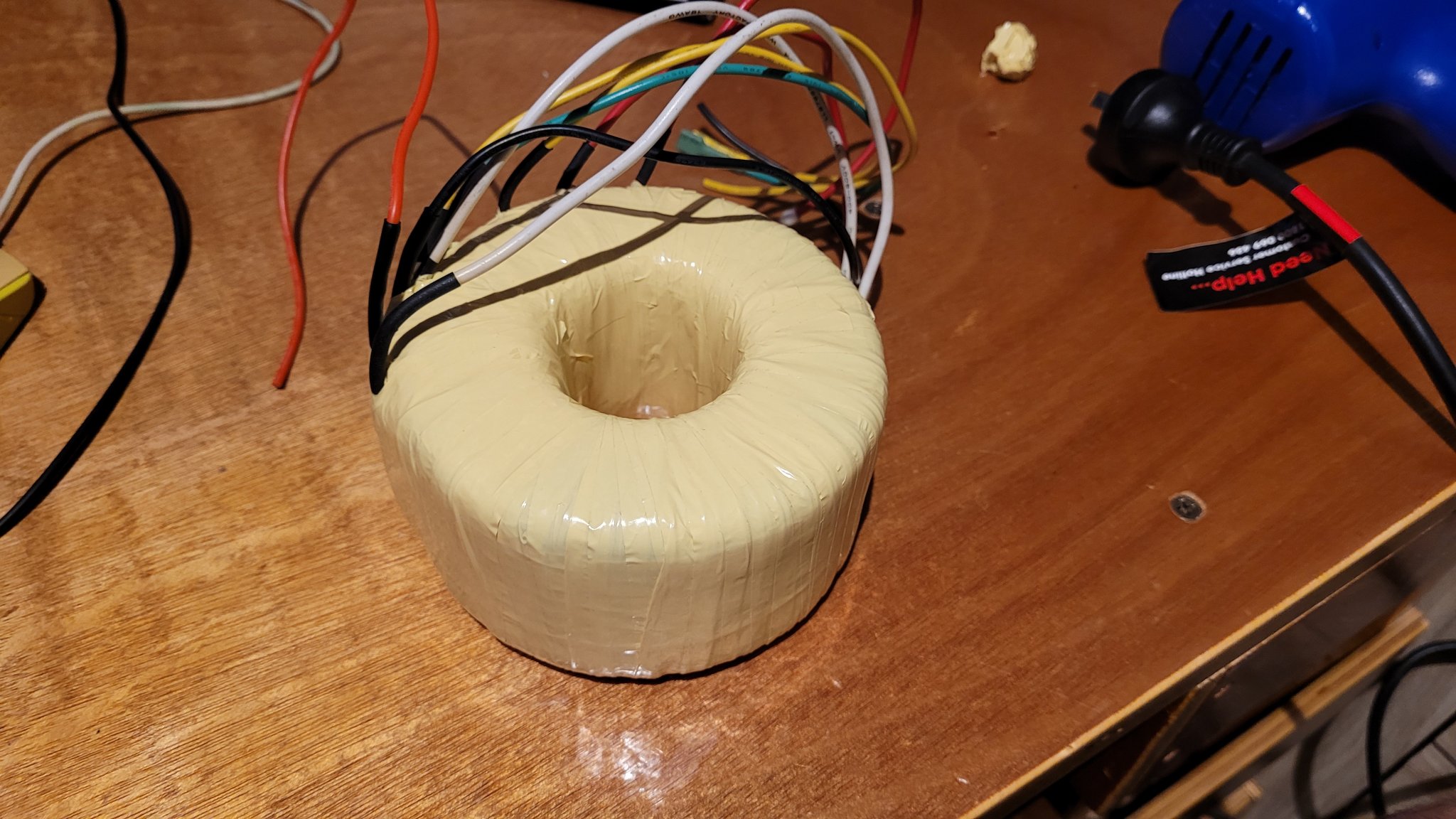

Great suggestions Tony and Naresh.
Sadly a day late as I got 3/4 of the way through last night using 1m or so sections of tape.
I should have the job finished tonight if there aren't too many interruptions.

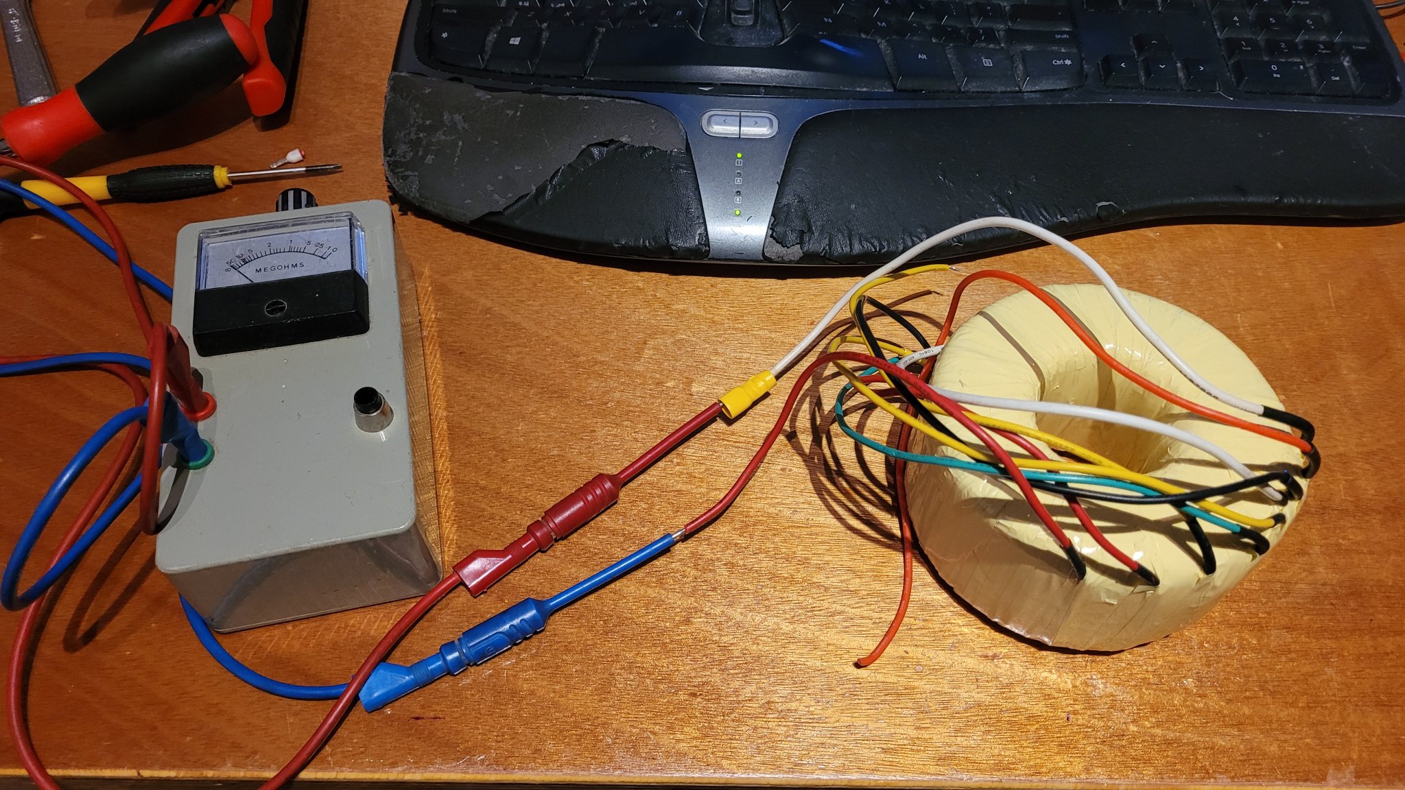

Thanks for the advice Elvee,
I finally got back around to this project. I have an old analog megger my dad made some 40 years ago.
I had to replace the battery holder which had corroded terminals after these decades.
Calibrated to read 0R with the leads shorted. I tested with a 2M2 resistor to verify it still works and reads properly.
Across all combinations of primary to secondary or secondary to secondary, I get circa 50M at 690vdc.
I am thinking that means I am good to go. I believe the standard is >1M @ 230/240vac.
