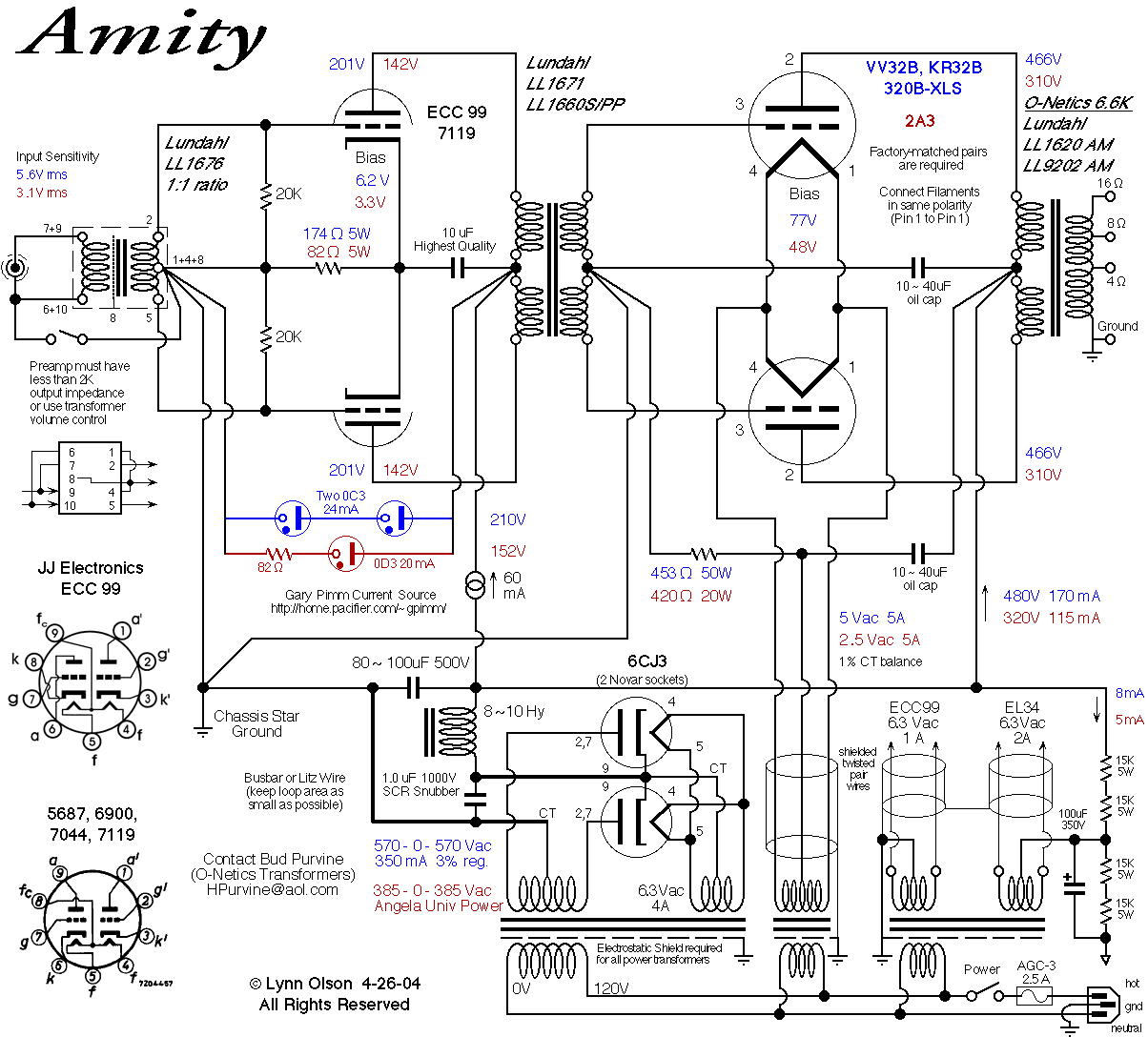

Sorry I forgot to put this in my previous post.
Whether this interstage transformer suitable for the Amity??
PRODUCT PAGE
PRODUCT PAGE
IMHO, you could always make RC-coupled stage and improve it to transformer-coupled stage when you are ready. This way you can compare how different coupling methods sound on your amp and what you like better.
And since Lundhal are "the knee" in the quality curve if you can afford it - go for them, you won't be disappointed.
Costs aside, go for a bifilar interstage. Monolith would be a proven choice that performed head and shoulders above any layered winding technique. They just have too many stray paths to resonate. Phase response is just as important as frequency response. I found the Lundahl to produce reasonable FR end-to-end, but when you look at the balance of phase from one end to the other, it was all over the place. Onetics was even worse.
