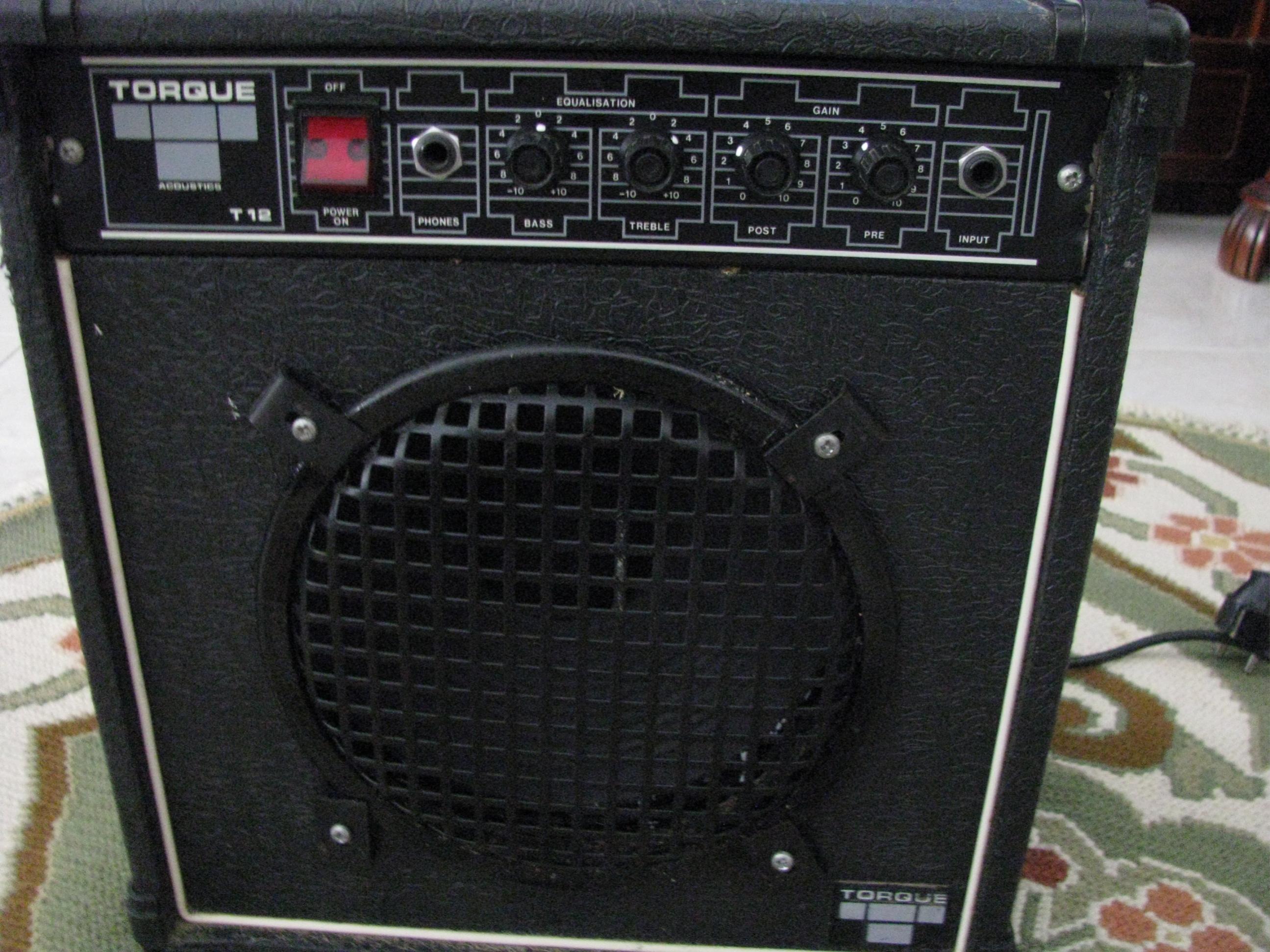

I need help getting the schematic diagram of the Torque Acoustics amplifier - T12

Being an older amplifier the design is simple. The main issues were capacitors ageing or leaking.
If you shared the issue, someone may be able to help.
Torque were made by a company called Edgeworth Electronics in Darlington.

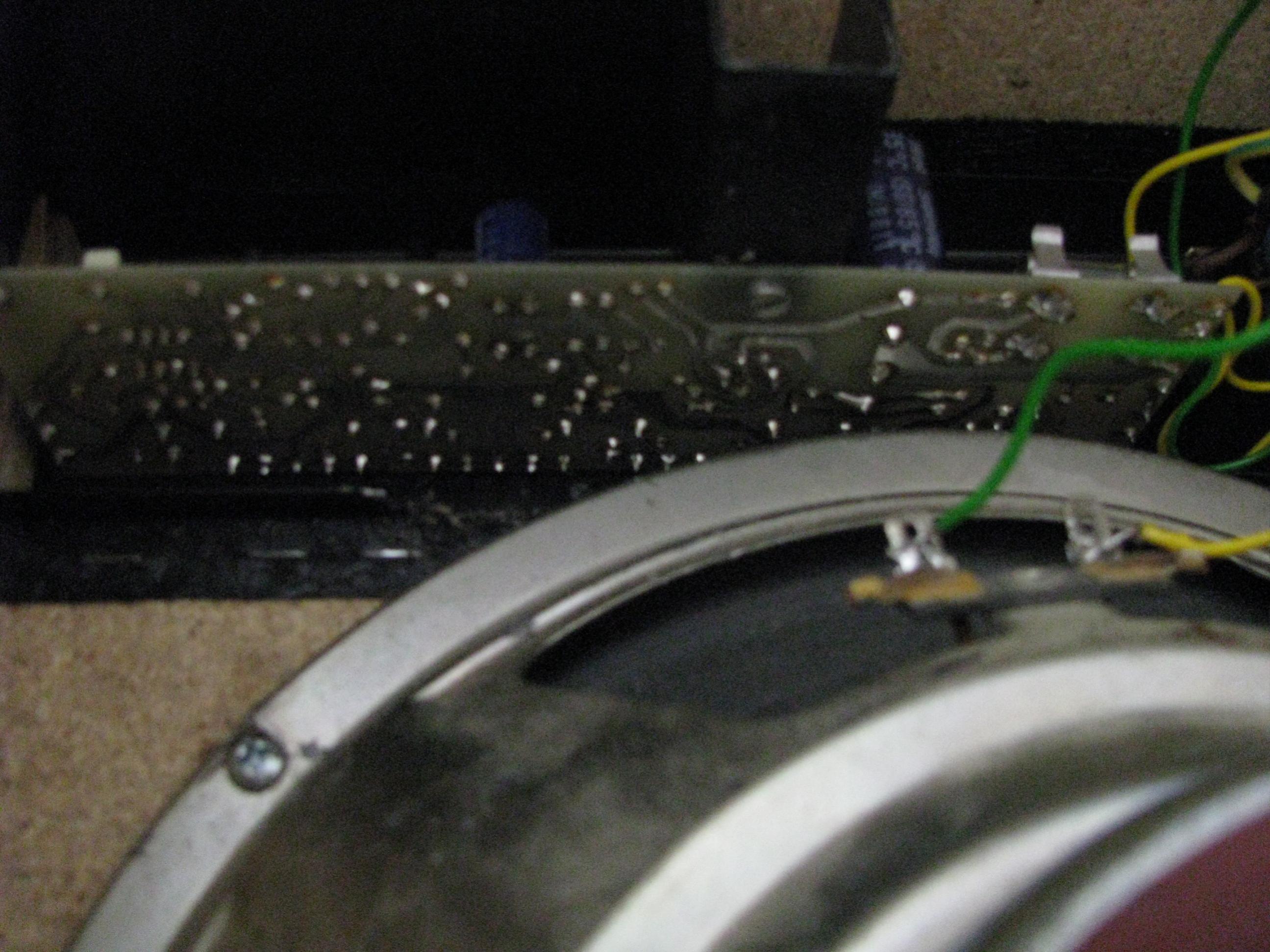

Can you provide a photograph of the amplifier PCB. I do not recognise the model number T12, but I may have a schematic for it.

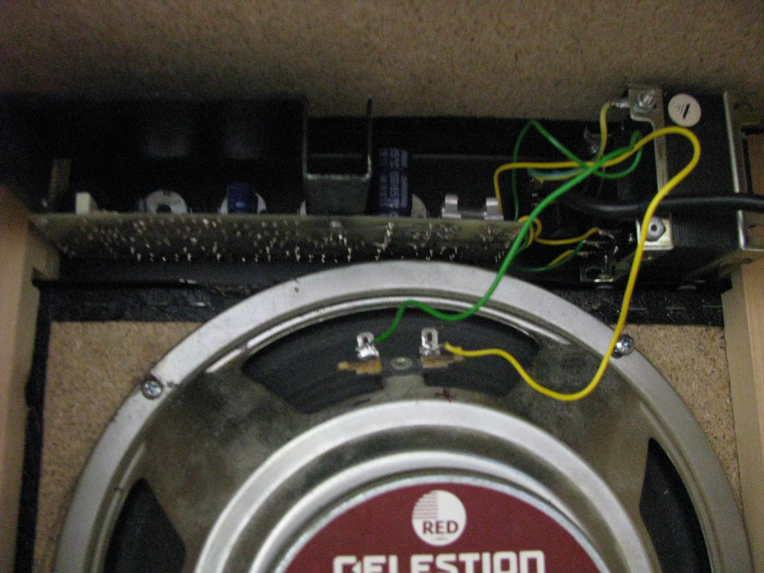

At the suggestion of his colleague, Kevinaston 1, public the photos that were possible of the equipment, without disassembling it, in addition to say that the loudspeaker (Celestion tube 10) is not the original and more the power intregrado (TDA 2030), was replaced by TDA 2050.

The TDA2050 produces more current than a TDA2030 but you will get no more power output from it as the speaker impedance and supply rails limit the power.
Did you check for dry joints on the TDA chip?

Sorry Julio,
All the schematics I have for Torque/Edgeworth are discrete output devices; I never serviced the later ones.
Edgeworth Electronics, who made Torque amplifiers were at Kellaw Road Yarm Road Industrial Estate, Co Durham, Darlington, DL1 4YA.
Jim Edgeworth retired and sold the company designs and name to a Chinese company in 2005.
I doubt you will find any service data, unless some old person like me has kept any archived copies of schematics.

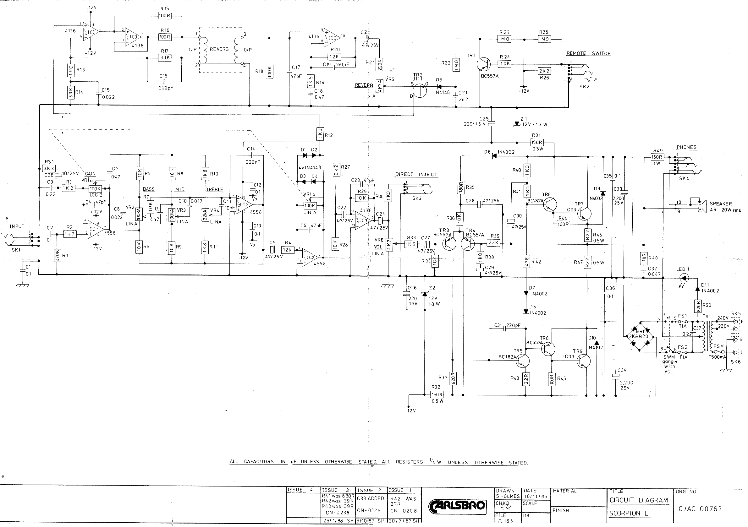

Short answer: forget it.In addition to that the amplifier is fully functional, my aim to get the scheme of it is that I want to introduce a reverb system, and also make use and include it in the front panel of a Phaser, put This would make it much easier to analyze the original scheme than to make a diagram from the board.
Original amp is a simple and good practice amplifier, 15W (TDA2030) with an 8" speaker .
A way too large 10" speaker was clumsily added, it does not even fit available space abd frame reaches PCB, where it may even short tracks, reaches both sides of cabinet wood, will sound muffled because of way too small acoustic size and to boot sound exits through original 8" hole, go figure.
As of a schematic of the 100W ones, I faintly remember having seen one, long ago.
As basic as can be generic Linn type power amp, think "RCA 70" and its myriad fmily.
So differential input pair (NPN or PNP), Class A gain stage, a.k.a. VAS, reverse polarity from input pair (so PNP or NPN respectively), load made out of 2 bootstrapped resistors, bias coming from 2 diodes + 1 resistor around 100 ohm orif they were fancy, an "amplified transistor", might even include a bias pot,go figure, a couple NPN-PNP TO220 class drivers , think TIP31-32 class, 50W amps saved a buck and used marginal TO92 ones (think BC630-640 class) and a coupke 2N3055 in the70s 80s or maybe complementary types in the 90s.
VERY generic and if you can repair one type, you can repair them all, no schematic really needed.
I bet experienced JonSnell can repair any of them, no schematic, one hand tied behind his back and while watching some Football on TV 🙂
PS: search for same era Carlsbro amp schematics, should be very close, being British and aiming to same market, think Cobra 90 and such.

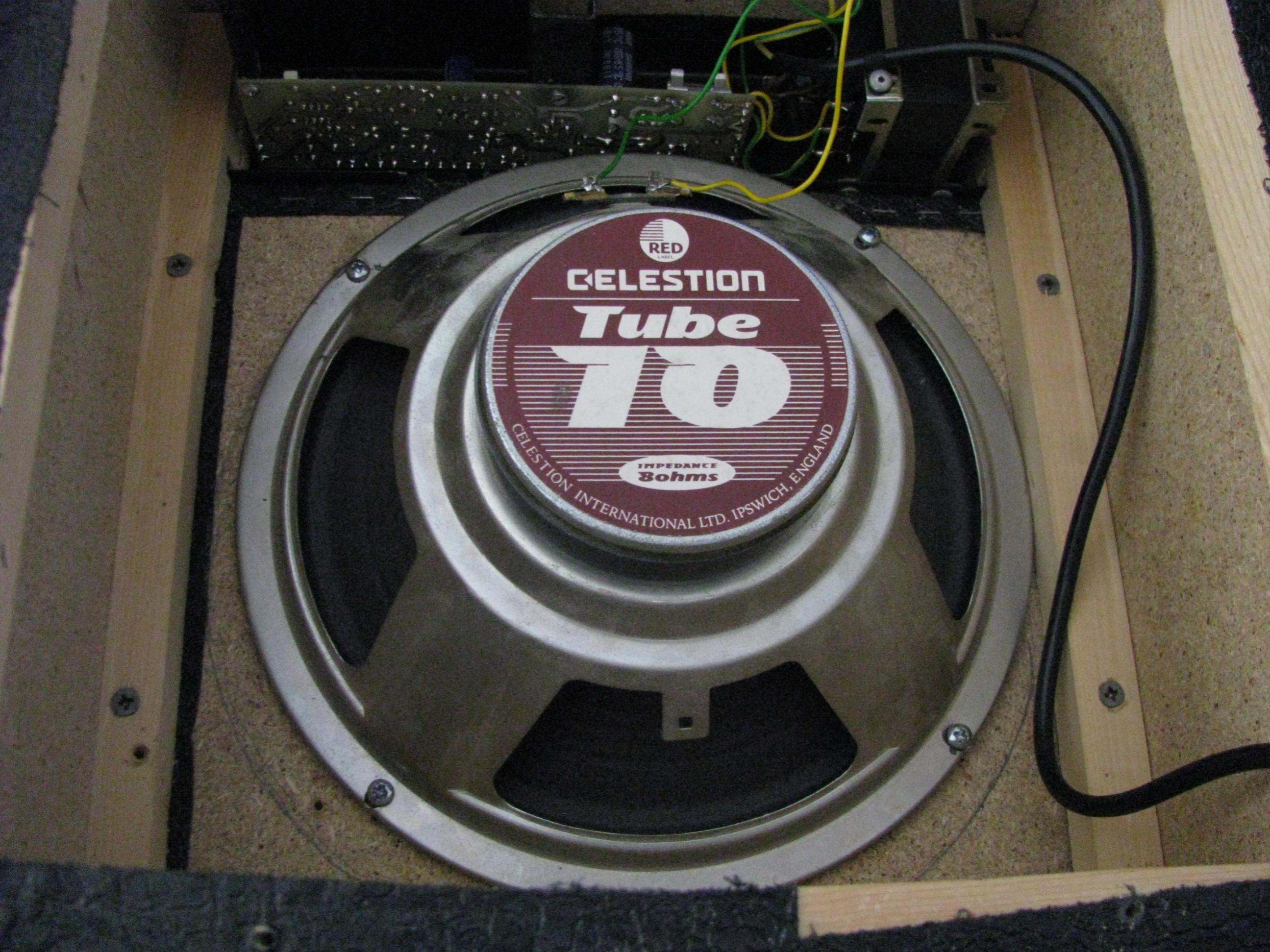

Hi everyone, I thank you for your opinions and recommendations. As for the comment from JMFahey, because the inclusion of Celetion Tube 10, required some DIY, but this only happened, because the original Torque 12 speaker, has a very limited response in the higher range. The use of the TDA2050 includes increasing the supply voltage from the original 15.4 V AC to 17.5 V AC, which in DC is practically the safe use limit of the TDA 2050.
As for the inclusion of a reverb line, why not? The amplifier itself is too basic, so any improvement is always a plus, given that the power has gone up a bit and some effects are always welcome.
Changes to the enclosure to include the 10 "speaker included widening the enclosure hole as well as cutting off part of the chassis to allow it to fit smoothly.
The result was satisfactory even though it has the limitations of an adaptation. As for reverb and tremolo, I'm still back from the project.
The home-made reverb line, with a small 8-ohm speaker, acts as a drive and a piezo as a receiver.

My thanks to JMFahey for the Calsbro diagram, Torque 12 is still more basic, much more basic, but the final way to get what you want is to go through several trials, as mentioned before, after results, given as yet I built the PCBs, I have no results to disclose.
