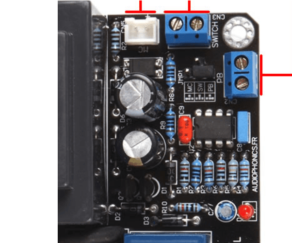

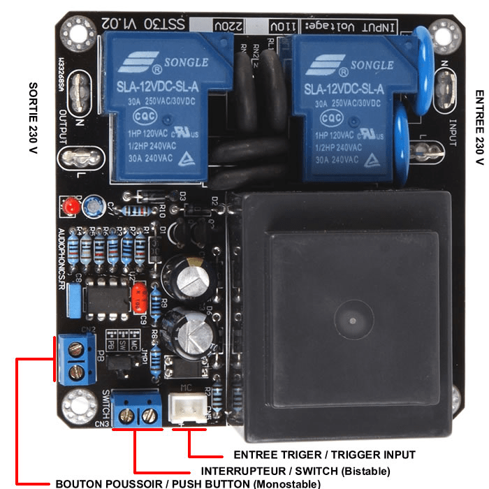

Hi. I've built myself an amplifier, and am happy with the results. In terms of switching on/off I run 230V mains into an Audiophonics soft start module, which has "switching by fugitive pushbutton low amperage or by trigger 2-12V".
So I have a push button switch attached to the +/- contacts of the soft start module "switch" connection (it also has separate +/- 'button' & 'trigger' connections).
I'd like to replace the push button with a touch switch, but I don't understand enough to feel I can ask the right questions.
I bought a non capacitive touch sensor switch - this needs a 3 - 30v DC supply. The sensor has 3 connections DC + In, Gnd, DC Out. I have connected it in place of the push button - well I connected the soft start 'switch +' to the DC + In, and the ss - to DC Out. This allowed the amp to power up, but no on/off unless I switch on/off at the mains.

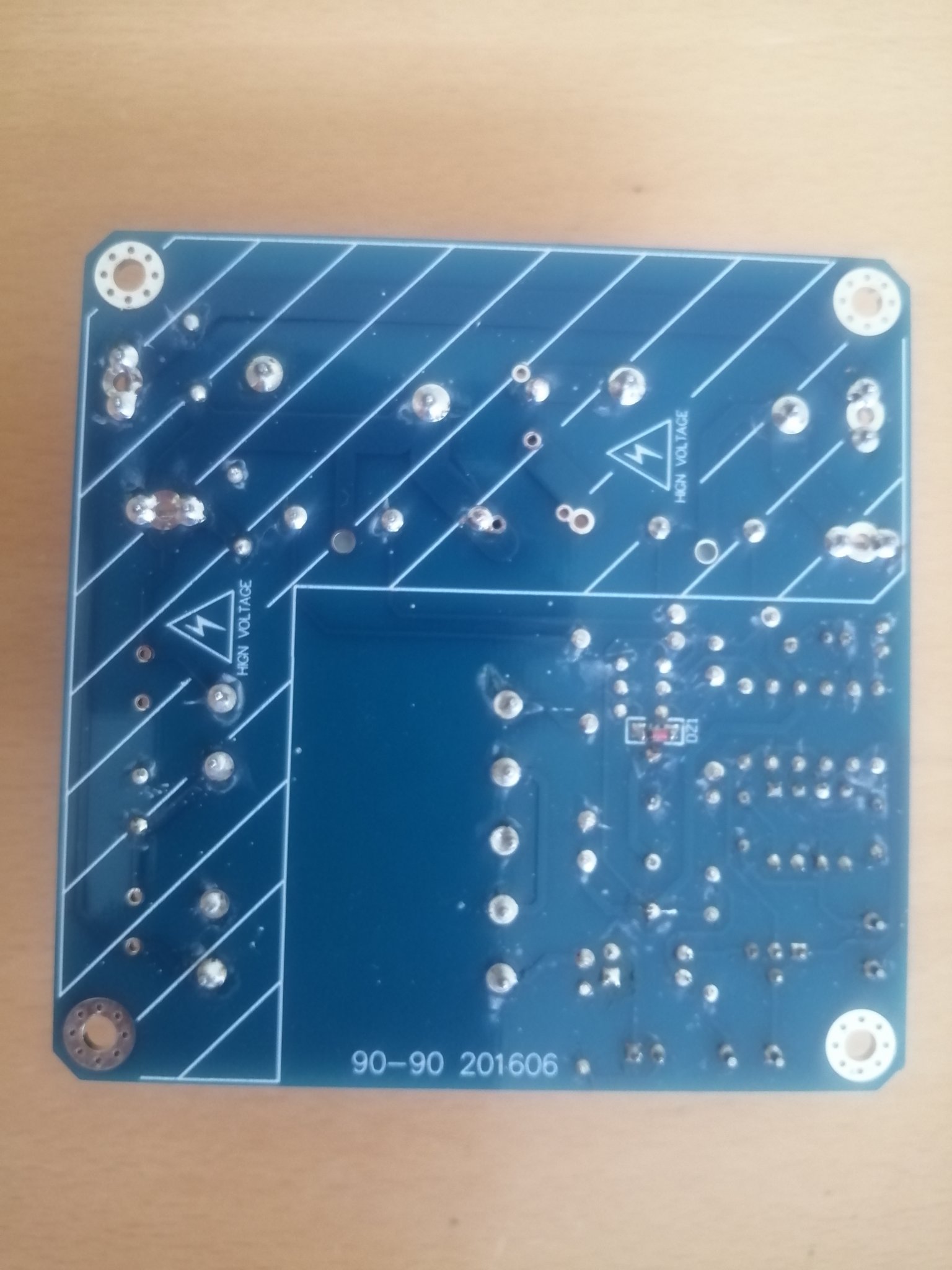

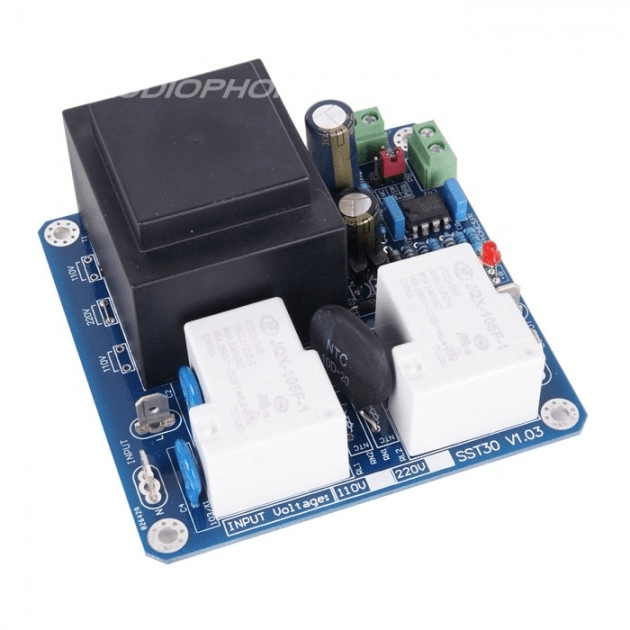

Hi Chris - the Audiophonics soft start module has SST30 V1. 03 written on the PCB. I won't be home for a little while, so will test then. I'm not sure the soft start has a +12v DC out. I'll try to get a pic, and post it in this thread.
Not sure this helps...
