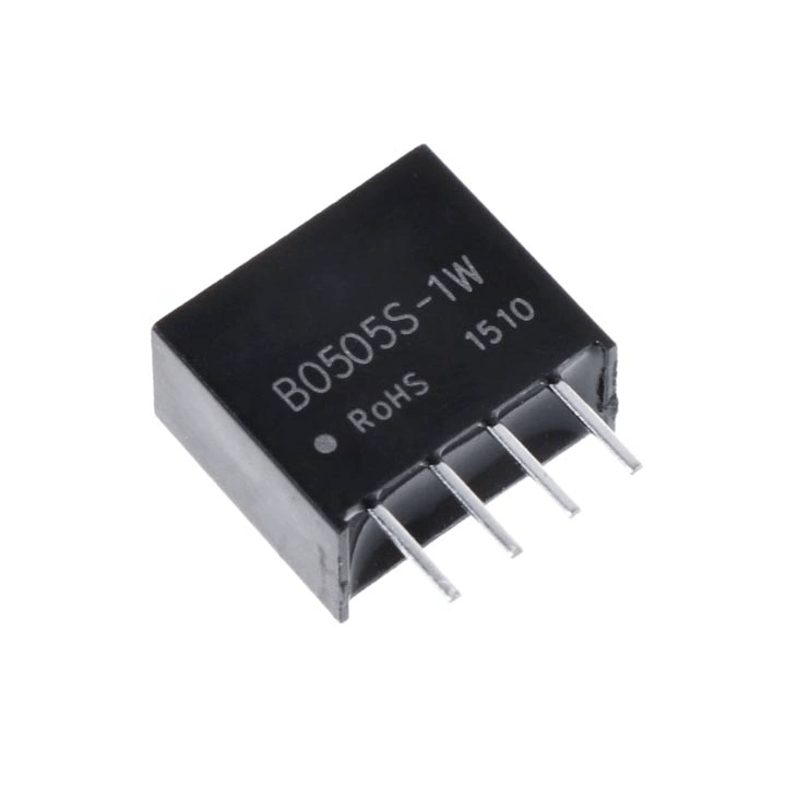

Hello,
If you use Bluetooth module, you need an isolated dc-dc converter for it.
I have built a portable speaker with PAM8610 and it is incredibile hissless.
wait so I still need to have this even when I have two separate power sources and you mean this one right ?an isolated dc-dc converter

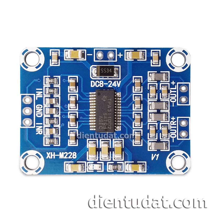

I have an extract same board like this and it still hisses a little bit even when the bluetooh module is not plugging inTPA3110 is using ferrite bead whereas 3118 needs LC filter. Both their noise performance are the same.
Since you're using battery, 3110 have lower quiescent current; hence longer playback time.
I thought this already have ferrite bead on it
If you had different power supplies for Bluetooth module and for amplifier, you don't need isolated dc-dc, but don't connect GND to each other (from power supplies) .wait so I still need to have this even when I have two separate power sources and you mean this one right ?
Thank You

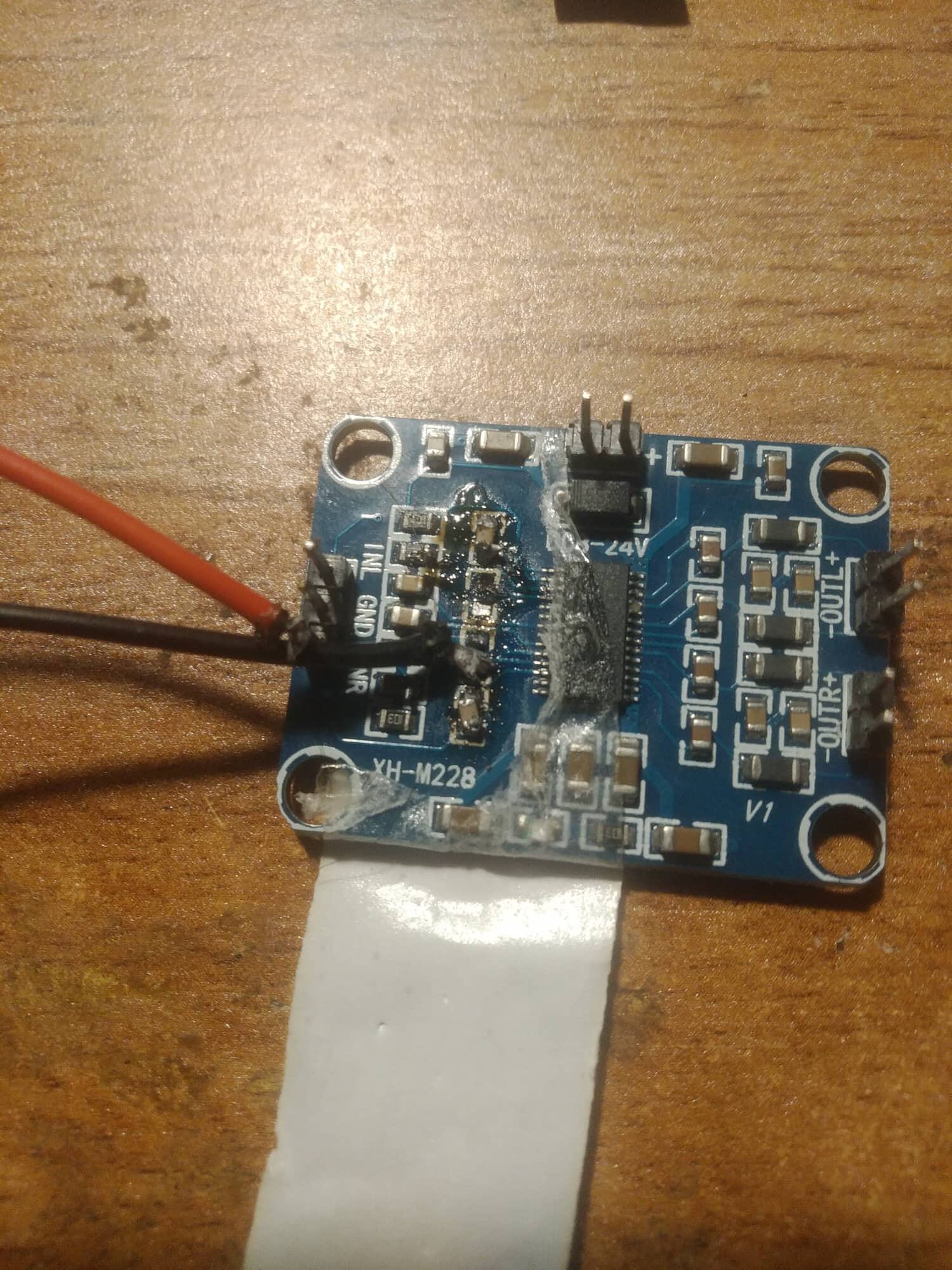

Have you terminate pin 3 & 4 and pin 11 & 12 together when listen to noise?
Do you have knowledge on differential input and soldering skills?
Based on the datasheet, pins 3 and 4 are LINP and LINN, while pins 11 and 12 are RINP and RINN. The hissing noise is really silenced by pairing them up. But what does this mean?Have you terminate pin 3 & 4 and pin 11 & 12 together when listen to noise?

That means the amp is quiet and working fine.Based on the datasheet, pins 3 and 4 are LINP and LINN, while pins 11 and 12 are RINP and RINN. The hissing noise is really silenced by pairing them up. But what does this mean?
The ground loop likely causes the hissing, to solve that you have to use the amp's differential input.can you explain more about the differential input in this case .thanks
LINP and LINN are connect to ceramic cap, after the ceramic cap are it's signal and ground.
Cut out the ground traces that connect the ceramic cap and wire to the BT board's analog ground.

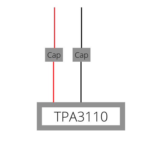

Hello, and thank you for your response. I'm a newbie, and I can't imagine the circuit you just described.LINP and LINN are connect to ceramic cap, after the ceramic cap are it's signal and ground.
It would be better if you could draw a diagram for me.
Thank you very much.
Pin 11 and 12 connect to ceramic cap, right?do you mean wire pin 11 and 12 straight to the bt module pin
do you mean to connect them like this ?Pin 11 and 12 connect to ceramic cap, right?

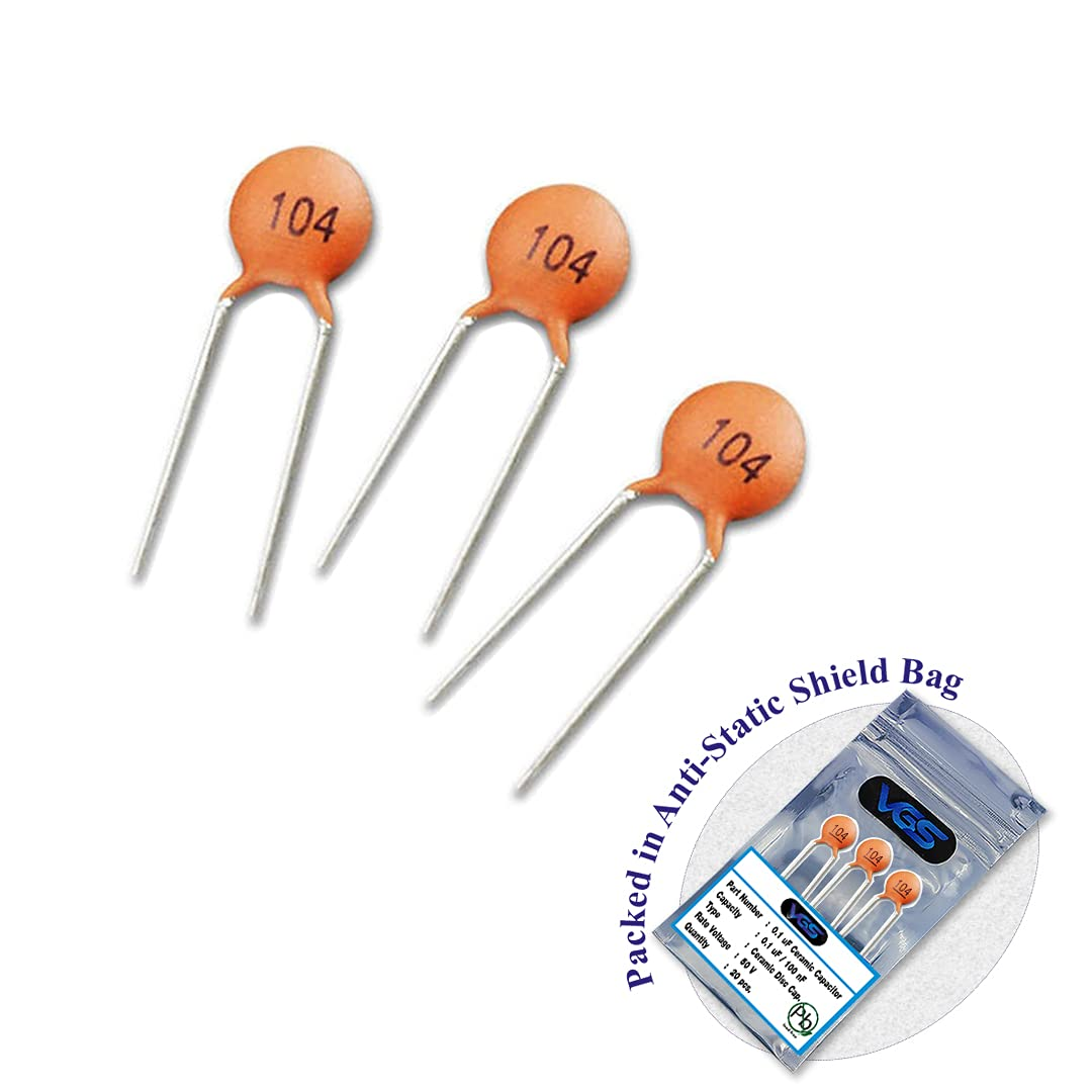

I tried to wire the capacitor like this, and also like this :
With this ceramic cap :
and connect the output straight to the 3-pin audio out of the BT module.
There was no noise at all with the second method when the BT module was not connected to the amp board. The hiss becomes louder when I connect the BT module to the amp. The noise is almost inaudible with the first method of connecting the cap. and suffers from the same issue as my previous attempt.

These 4 ceramic cap connected to LINN LINP RINN and RINP.
I disconnect the RINN from its cap to test it. The hissing noise was not audible but when i connect it straight to The BT module ground the noise get louder than before. So whats wrong here?These 4 ceramic cap connected to LINN LINP RINN and RINP.
