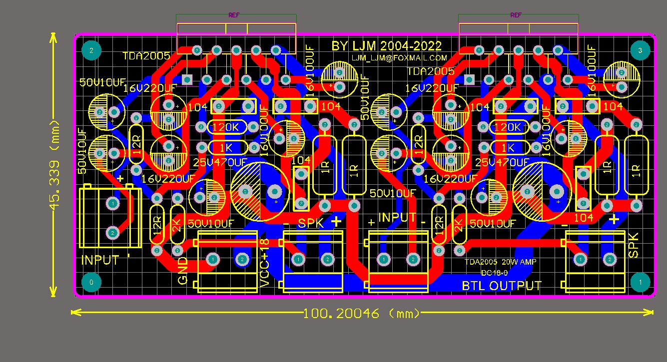

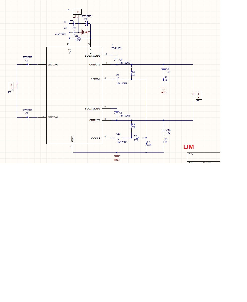

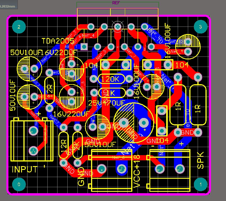

I think many people are making tpa3116. I think it is a relatively high distortion. The voltage is very low. An amplifier with low power. I didn't find it useful. I think tda2005 can achieve better results. Cheaper cost. It is also easier to make. I will spare a little time.
About 20 minutes. Design data. Then upload it here. I expect that a total of one CPU radiator is enough for stereo. No fan is required. It can meet the BTL voltage of output + -15v.
The standard circuit adopts bootstrap boost capacitor

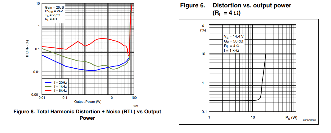

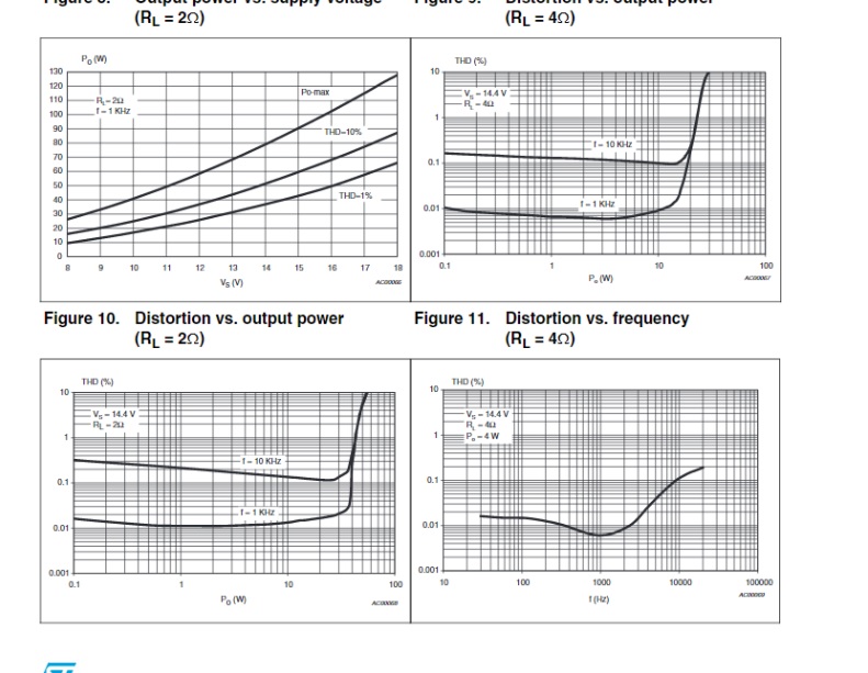

In fact, the distortion of TDA chip is lower than you think.View attachment 1071675

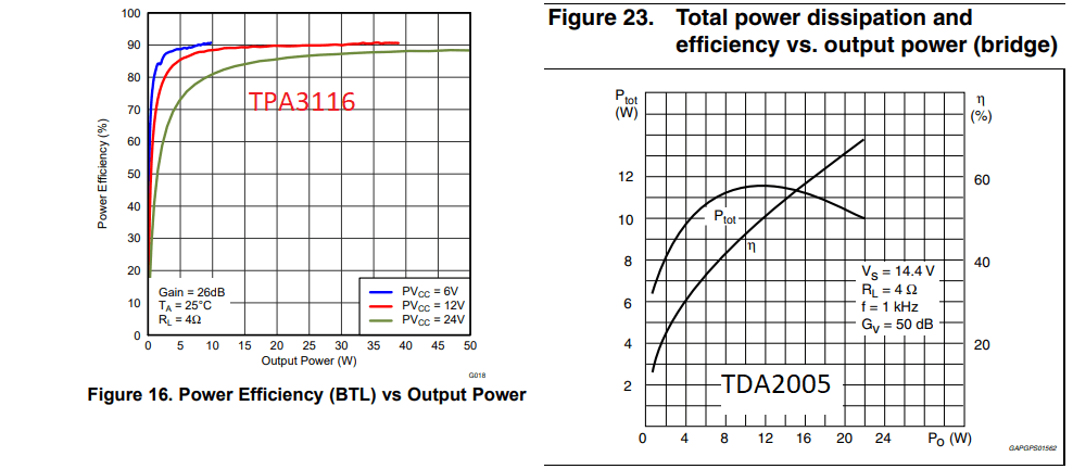

Loses in efficiency and output power.
TDA2005 THD+N >0.2% vs TPA3116 <0.1%.
Including tda2005, tda2050 and TDA2030A.
I even think that the performance of all class D amplifiers in the world is far lower than that of TDA2030A.
Of course, I don't sell TDA2030A. But I have heard the voice of TDA2030A. Very good.
And its price is very cheap. About $0.20. And it's very simple. There is almost no heat.
It may be for these reasons. It is not recommended by merchants.
I'll be there for a while. Perform APSYS two measurement on tda2005.
Then publish the data. Tda3116 data will also be released.
