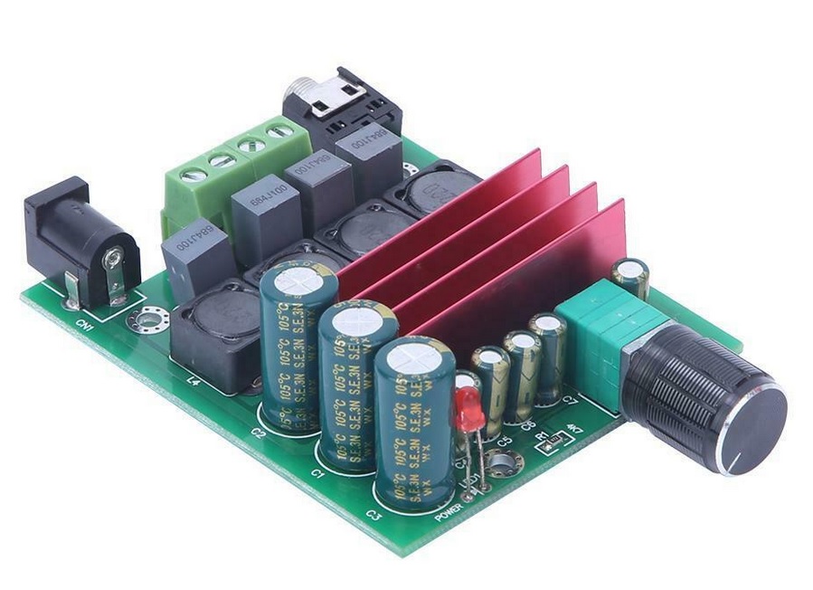

One of my TPA3116 amps (1st photo) has electrolytic input caps so it would be easier to modify as my other amps with smd components. Perhaps one day …

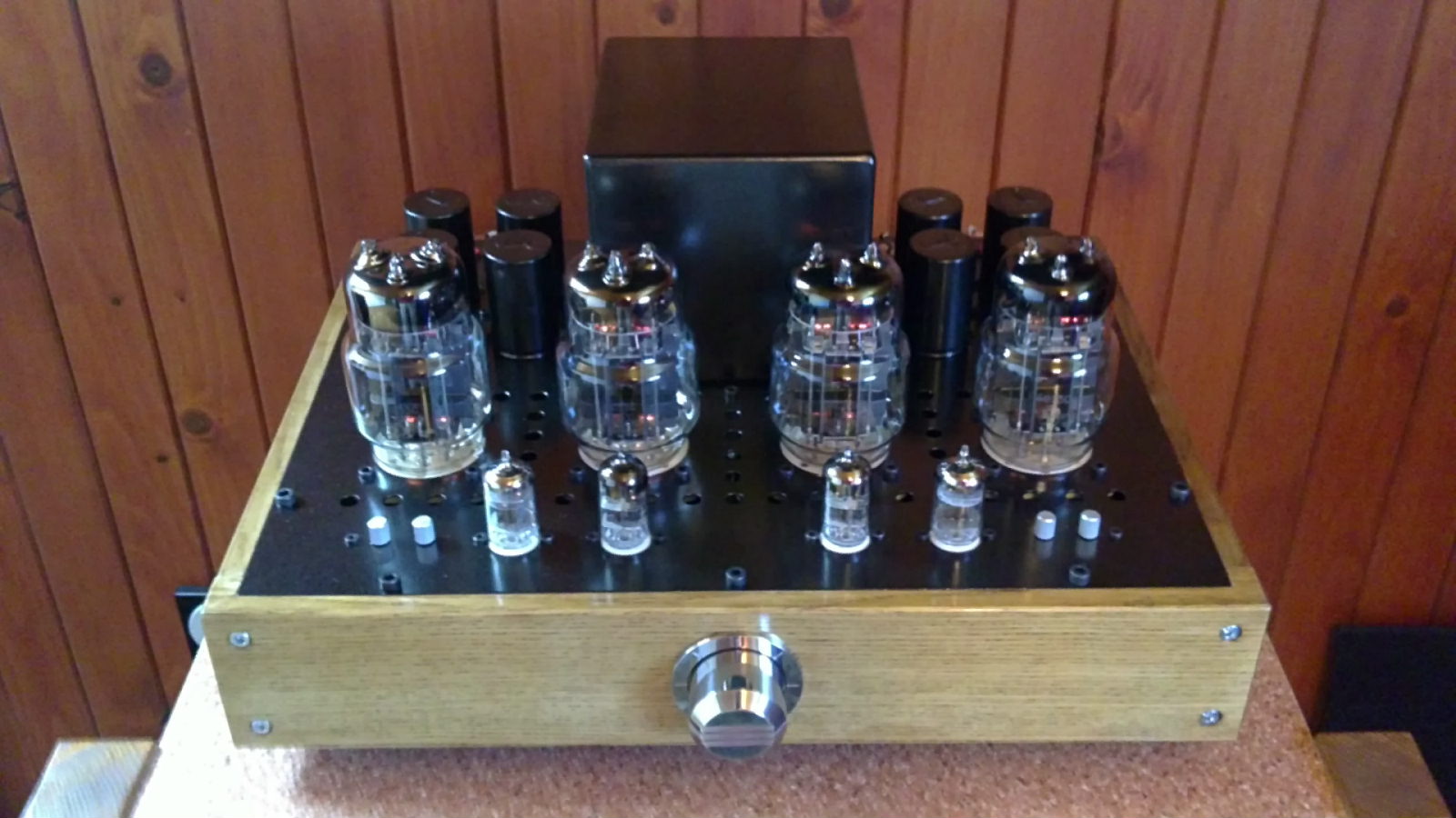

I gave this amp to my friend to compare it with his amp (2nd photo). Next day he called me if I have some time to give him a visit to do some listening tests together. At the same day he also ordered a bunch of TPA amps from eBay.

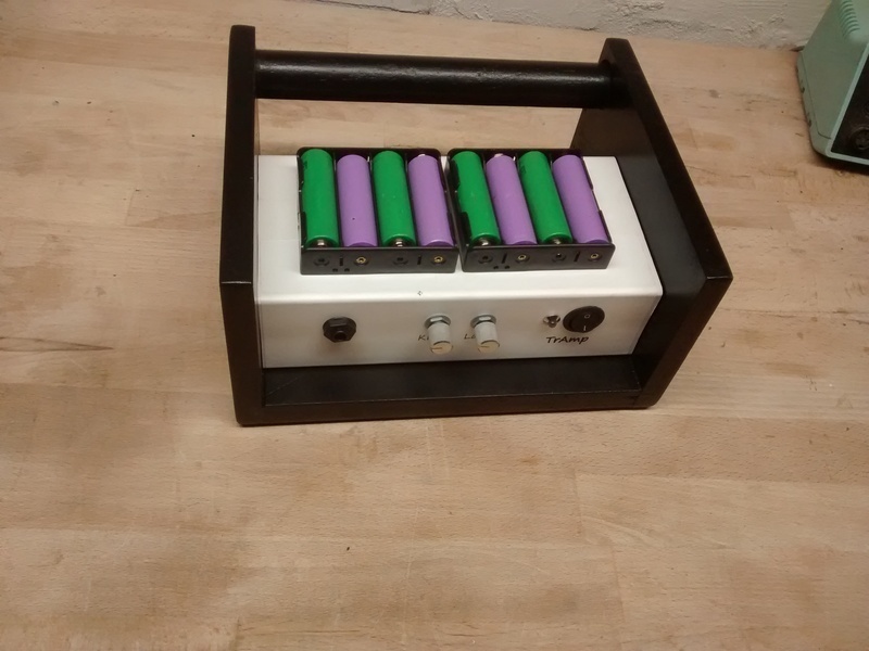

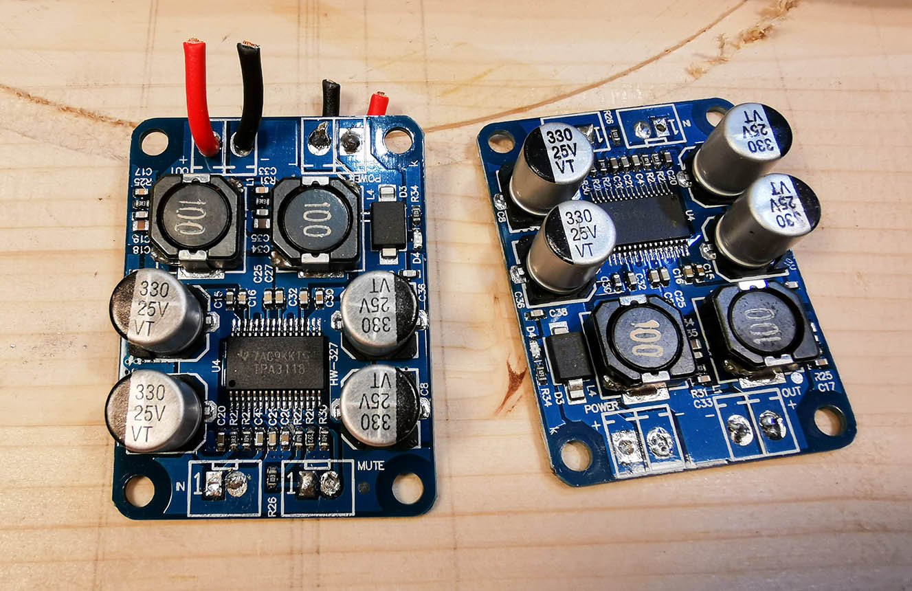

Same here. I use 8S1 Li-Ion 18650 salvaged from notebook accus powering my TPA3251 50W amp. Put them into simple 4S1-battery holders. No charge balancing but on-board uC-contolled deep discharge protection. They are charged in a 4slot XTAR charger with single slot control making charge balancing redundant.
