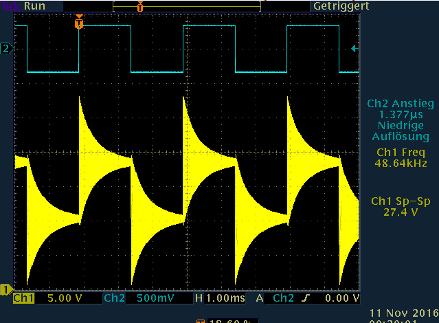

Did you ever find a square response plot of TPA-3255? Not? TI-people are smart you see!
I append a square plot of the original TPA-3255 EVM I captured in 2016. This started me investigating post-filter-feedback. Resulting in a much friendlier pulse response.

Wow this is amazing information.Did you ever find a square response plot of TPA-3255? Not? TI-people are smart you see!

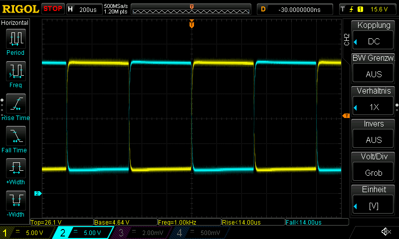

I did apply a square wave however the 50kHz oscillation I see is constant - not decaying like in your plots.
Do you have any tips on reducing the oscillation?
Yes, but as I am too busy at the moment I will come back later. Any way, a persistant oscillation must not occur and may be caused by a poor/faulty (layout?) design.Wow this is amazing information.
