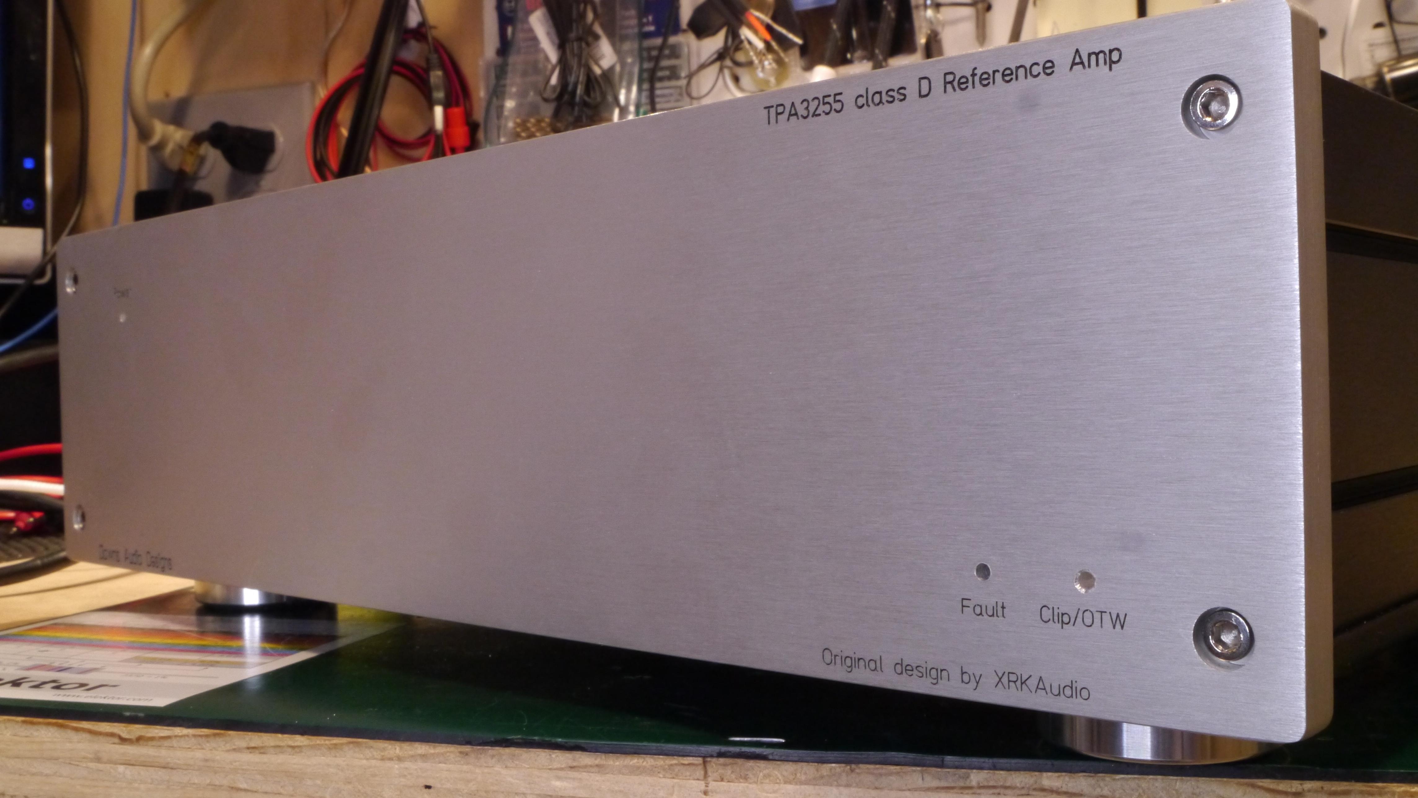

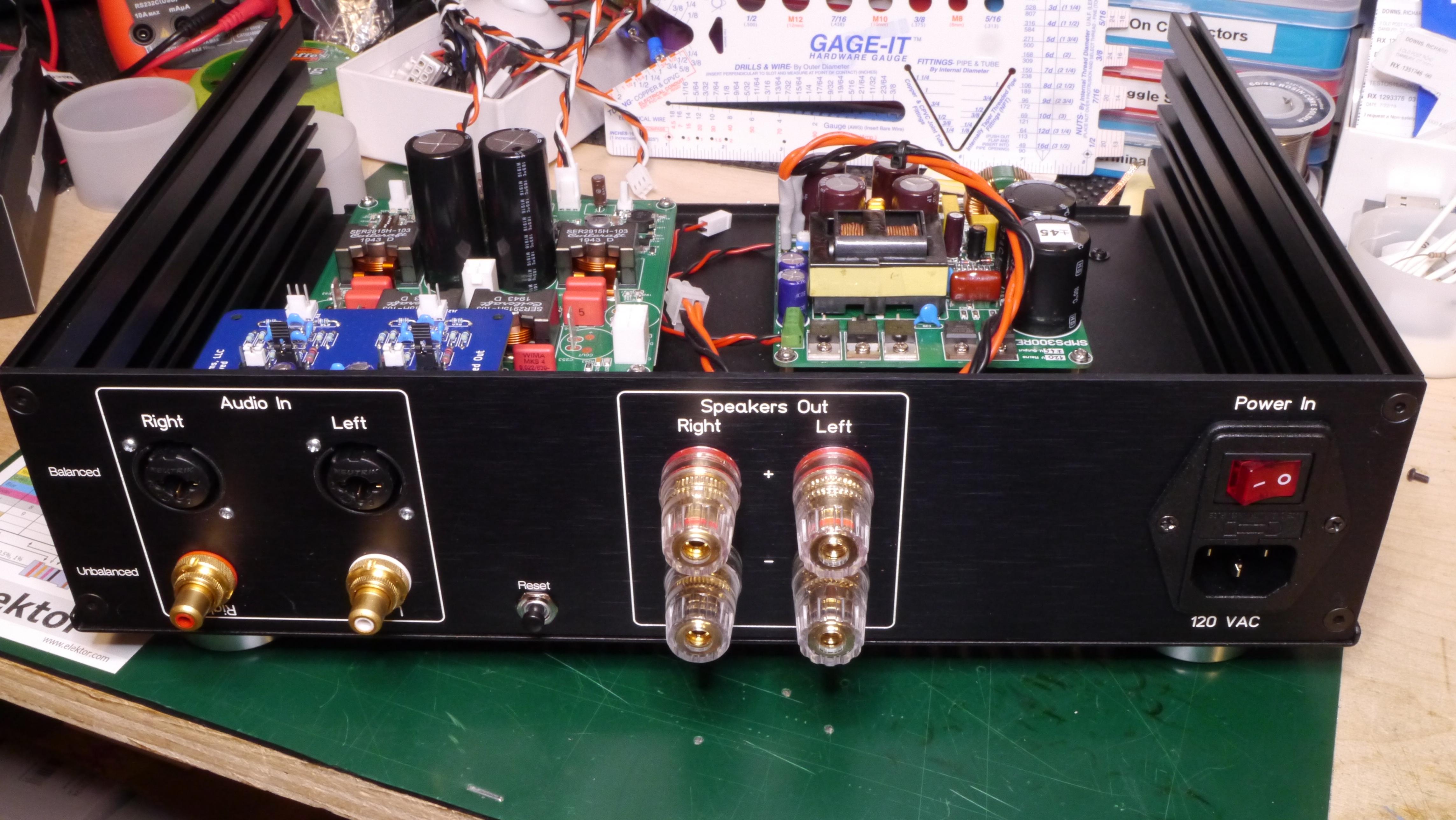

Redjr has provided files to allow us to make professional looking front/rear panels that look like this:
867116d1597094895-class-amp-photo-gallery-p1020239-jpg
867119d1597094994-class-amp-photo-gallery-p1020268-jpg

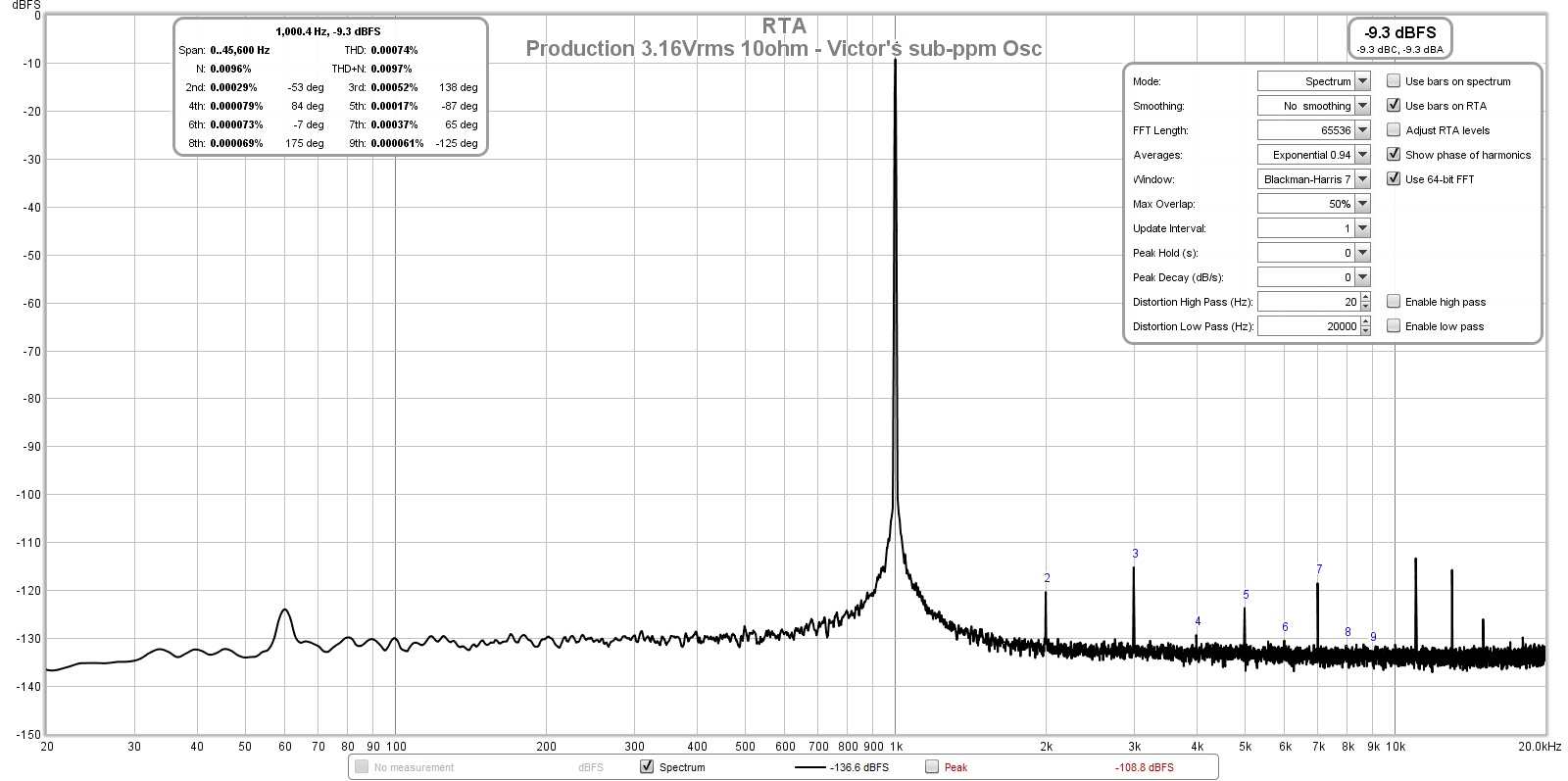

Edit April 23, 2020: The first production verification amp was tested at the reference condition of 10W into 10ohms at 1khz and achieved 0.0011%THD vs the TI specified 0.0021%THD with PFFB enabled:
837048d1587662608-tpa3255-reference-design-class-amp-gb-tpa3255-v002-10-0vrms-10ohms-fft-pffb-victors-osc-jpg
The 1W case at 3.16Vrms at 10ohms gives 0.00074%THD:
837049d1587662608-tpa3255-reference-design-class-amp-gb-tpa3255-v002-3-16vrms-10ohms-fft-pffb-victors-osc-jpg

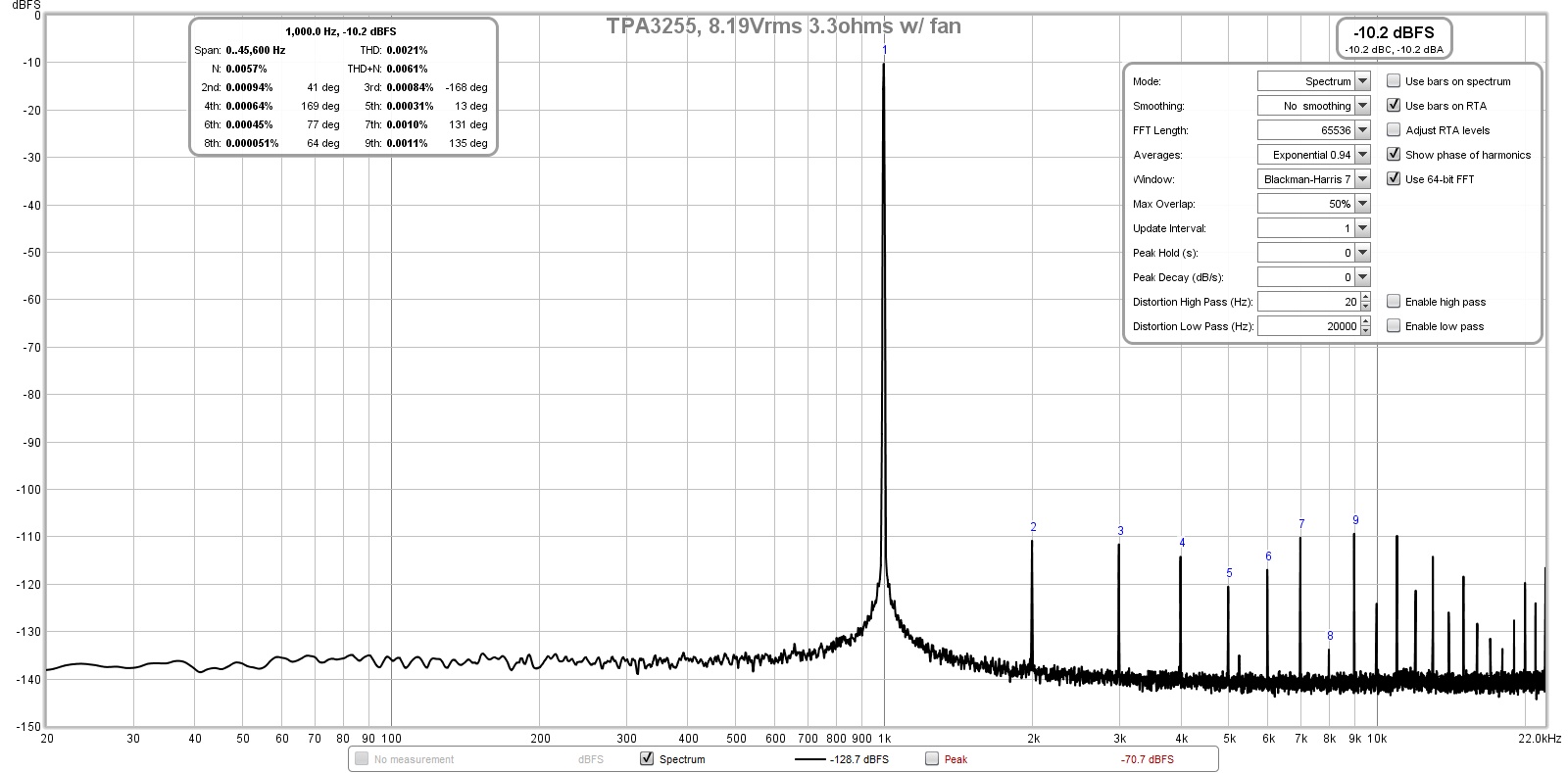

Final Test w/ correct current limit programming resistor, showing FFT at 20.3W rms into 3.3 ohms showing THD is 0.0021%:
794180d1573531774-tpa3255-reference-design-class-amp-gb-tpa3255-3e-amp-8-19vrms-3-3ohms-r121-22k-jpg

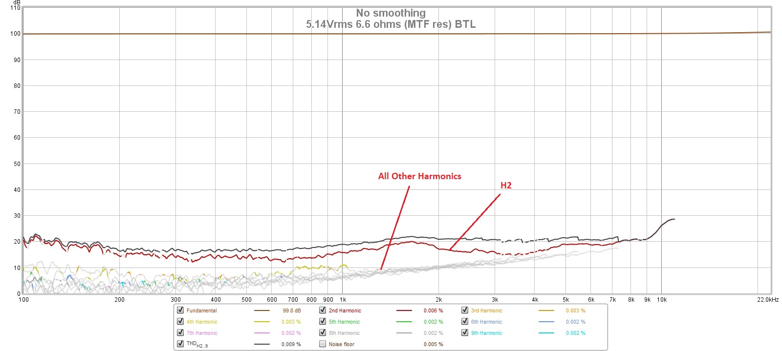

Edit Oct 31, 2019: THD and all-orders of harmonic distortion up to H9 vs Freq up to 10k for 5.6Vrms into 4 ohm load:
783516d1569420234-tpa3255-reference-design-class-amp-gb-tpa3255-rev0b-5-14vrms-6-6ohms-btl-sweep-jpg

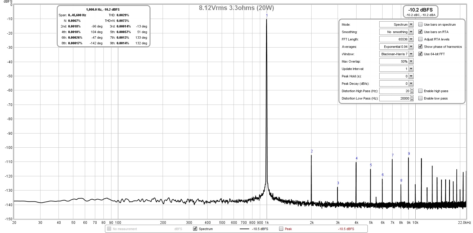

Edit Oct 7, 2019: 20W into 3.3ohms FFT looks very nice. Dominant second order harmonic distortion and dominant even orders. About 0.0024% to 0.0029% THD and noise floor is very low. This is with 12v battery feeding 800w DC-DC step up to 51v:
784656d1569792221-tpa3255-reference-design-class-amp-gb-tpa3255-v0b-8-12vrms-3-3ohms-fft-jpg

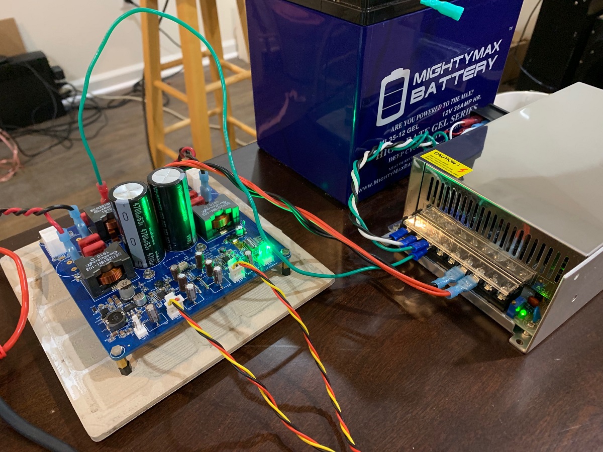

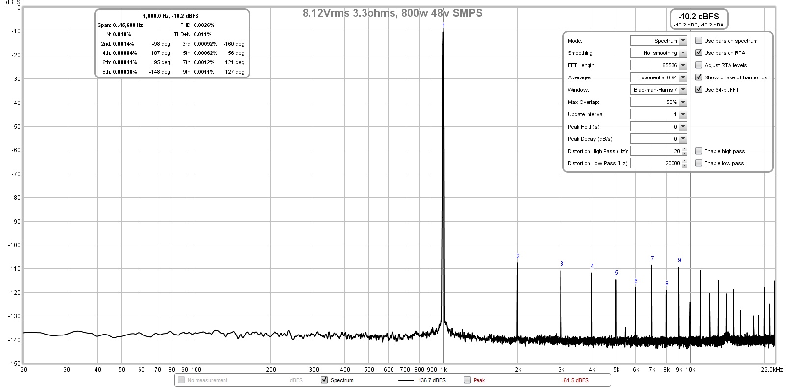

This is with 120VAC wall plug powering an 800w (48vdc adjusted to 50v) SMPS (Aliexpress $44 LED PSU), also 20w into 3.3ohm load:
785019d1569942762-tpa3255-reference-design-class-amp-gb-tpa3255-v0b-8-14vrms-50v-800w-smps-fft-02-jpg
Setup with 800w SMPS:
784970d1569915442-tpa3255-reference-design-class-amp-gb-tpa3255-v0b-8-12vrms-setuup-50v-800w-smps-aifeng-clc-jpg

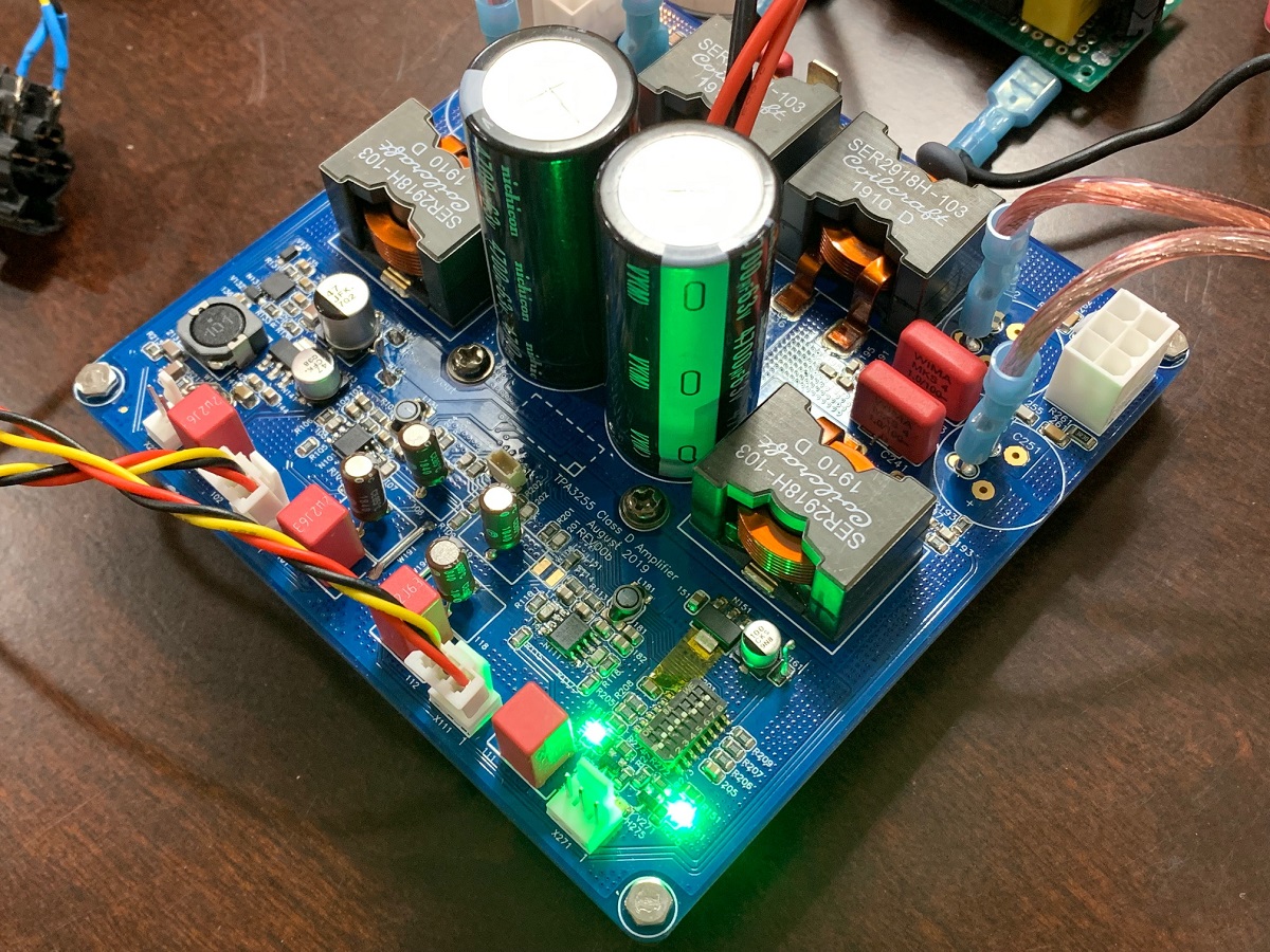

Edit Sept 27, 2019: The amp is up and running! Sounds great and measurements are very promising.
783331d1569353432-tpa3255-reference-design-class-amp-gb-tpa3255-test-success-03-jpg

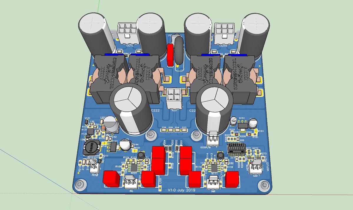

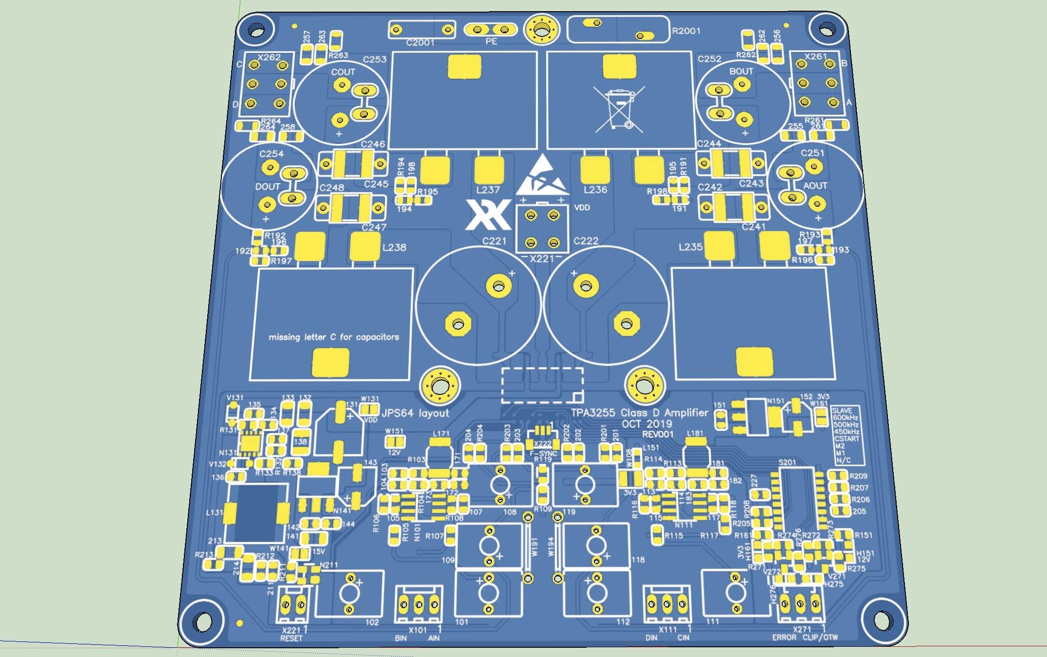

Edit Aug 17, 2019: latest 3d render with improvements (listed here) included:
775839d1566058237-tpa3255-reference-design-class-amp-gb-f6578a48-52aa-4283-aa4e-e2efbc5affbf-jpeg

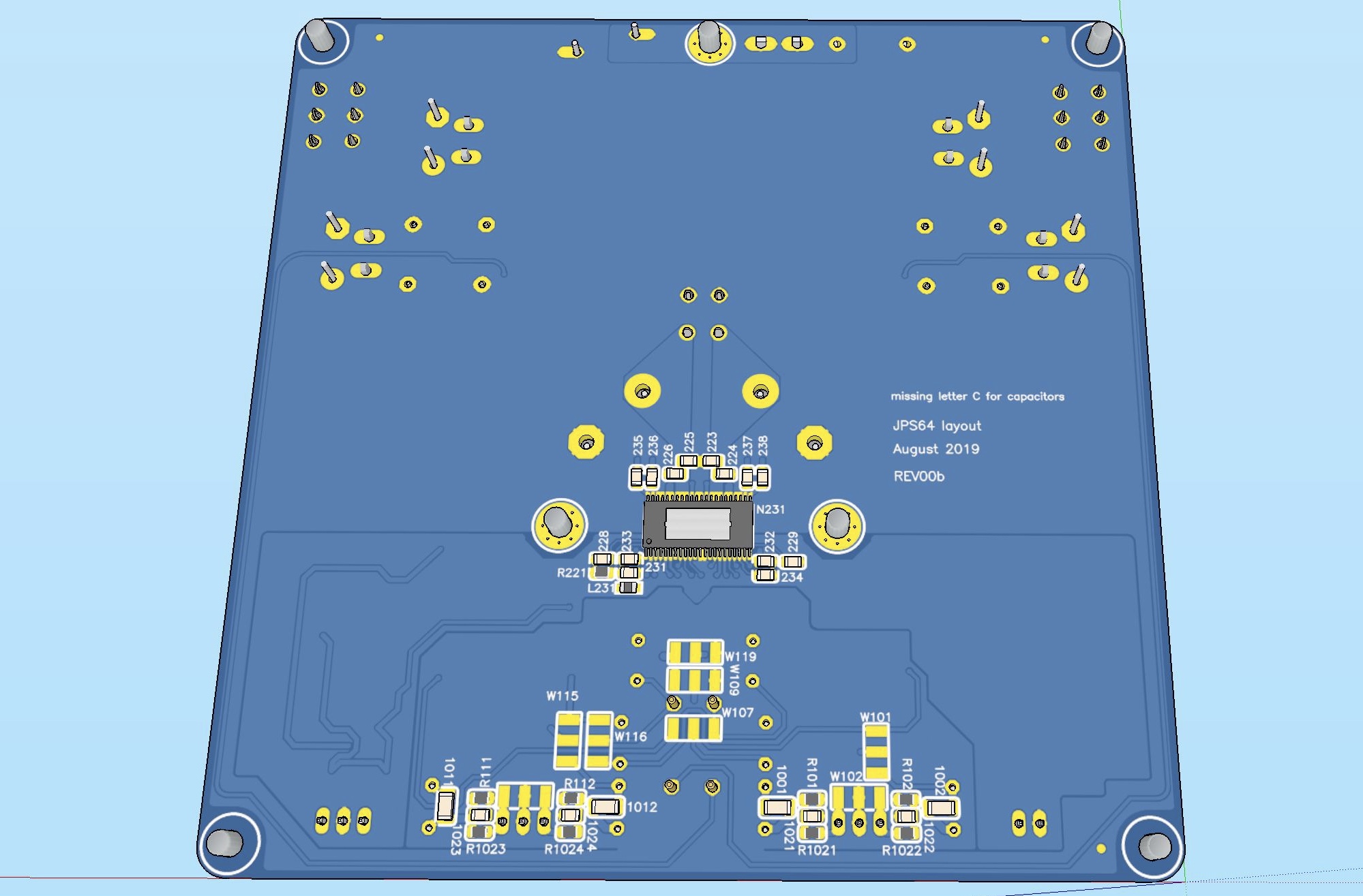

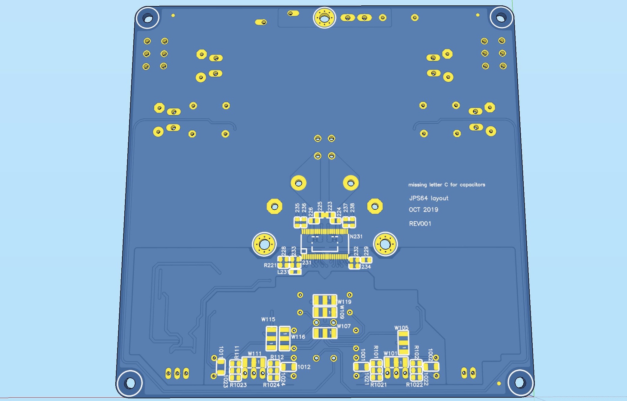

Latest bottomside of PCB (note extensive use of groundplane and large short triangular traces for power input and bulk caps all connected to Vdd pins):
775838d1566058237-tpa3255-reference-design-class-amp-gb-ede8becc-1d12-4494-85de-af340f7e4115-jpeg

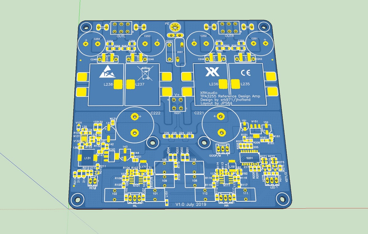

3D render of TPA3255 Reference Design with components populated (top)
771900d1564643487-tpa3255-reference-design-class-amp-gb-tpa3255-3d-top-jpg

So I have been working with JPS64 and Jhofland to develop a new Class D amp based on the TI Reference design, but with some tweaks to make it even better. The design philosophy is to keep the amp more general to allow the user to select SE, BTL, or PBTL operating modes rather than force the user to the typical BTL-only offerings available on eBay/Aliexpress. The TPA3255 when operated in SE mode provides for 4 channels of output, and the audio quallity is very high as the harmonic distortion vs frequency is flat rather than rising (as is the case for BTL). It is also a good thing to keep the possibility of balanced input for the amp to enable a nice quiet drive for folks with high end DACs or preamps. We also added some nice features to make the amp easier to use and more reliable. Like Molex Minfit Jr connectors for quick and reliable connections rather than screw terminal blocks. An NTC ground lifted chassis ground Faston spade is also provided, as well as a header block to allow master/slave operation and also carrier frequency selection. Basically, all optional features are kept to allow the user the widest latitude of how they want to apply the amp.
We are also mounting the main TPA3255 chip on the bottom side so that its thermal pad faces down towards the mounting surface. In this way, the board just needs to be mounted to a metal chassis with the usual standoffs and a small thermal conductor block (aluminum or copper) can be used to mount this amp inside a sealed (non-ventilated) chassis, yet still permit adequate cooling. It eliminates the need for a separate heatsink element. Of course, the amp uses only the best symmetric star-grounding-centric layout methododologies that you have come to know and love from JPS64. Don't forget the thousands of via-stitched traces for extra low impedance current paths. Finally, the crown-jewel of the design is use of premium high current CoilCraft flat copper wire shielded inductors. Those of you familiar with souped-up TPA3116's will reognize these as the ultimate inductors for Class D amps. They look cool too.
The design ended up at a generous 120mm x 124mm and will be 2.0mm thick with 2oz copper traces and ENIG finish. Typical JPS64 via stitching now covered with solder mask (tented vias) to reduce solder bridges. An on-board DC-DC converter provides the necessary 12v auxilary voltage for operation. Maximum power supply voltages is 51vdc single-rail. Typical 48vdc SMPS are perfect for powering this amp. If you already have a 400VA trafo that can make 48v to 51vdc, it can work very well too.
Schematic is in the PDF file below. Board is 120mm x 120mm with four M3 bolt holes offset 4mm from the corners or 112mm x 112mm CTC.

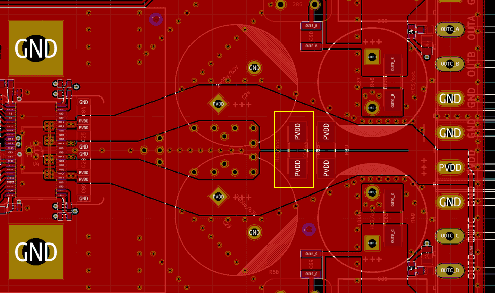

In the sense that it will be less sensitive to load impedance, yes. The reduction in THD per se, not sure. At the same time, PFFB is what Bruno did with the Ncore and they are great. To have this option would be a reason for me to want these boards. It is just a couple of passive components anyways.

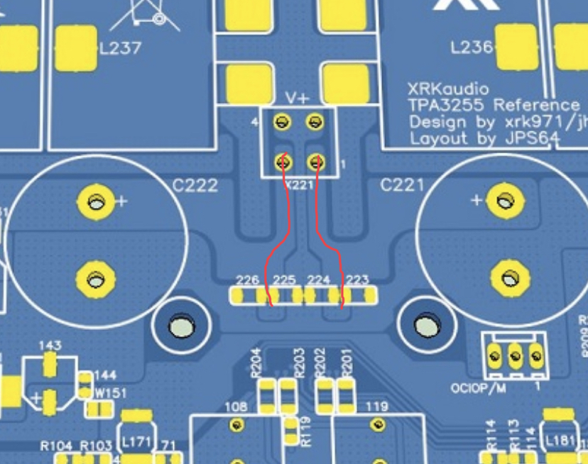

I find this layout a bit "suboptimal" in terms of power supply bulk capacitor connection. I also suspect some THD penalties due to inductor cross coupling when mounted like this. (Beside that, the power connector is labeled misleading, as the top pins are "negative")
Measurements will show.
Founder of XSA-Labs
Joined 2012
DrMord,
Thanks for your feedback. Regarding the bulk caps, I looked at the layout and do not see any possible way to get the pins closer to the caps!? Those traces go from the big double layer stitched via power bus to a trace going about as directly as possible to the power supply input pins. Please share how you would do it to improve?
Thanks,
X
As the return path is also frequency depended both +/- should be together as close as possible to minimize loop area. (Things that work for slow signals like Class-A Audio may not work in switching applications. Also star-ground might make things worse than better.
I'd suggest routing the power via the bulk caps so the current path goes from connector to bulk cap to mlcc to power pins. And make sure every GND+Supply pin on the 3255's (where the 4 MLCCs are) is connected equal to this.

I lastely made it like so:
attachment.php
The split before the bulk caps is usually not needed, back in the days we wanted to see if this will have any effect on cross-talk/channel imbalance.
Dr Mord,
The bulk caps are reservoir caps, they can be connected to the same fat low impedance PVDD trace and off to the side as a branch. They do not need to come before between the PSU pins and MLCC caps, which are the ones doing the filtering and are indeed mounted right on the pins (just on opposite side of double layer sandwich and connected by the via stitching). We have essentially the same routing and I would argue that distance from the PSU connector is even shorter on our layout rather than a long traverse from the back. I am still quite happy with the star ground in the physical centroid of the board. The low level analog ground plane is off to the front edge where it avoids interaction with the large currents near the central star ground. JPS64 has a lot of experience designing high speed digital (30Ghz), mixed analog and digital, plus power circuits. I am pretty confidant that we are in good hands with his design. Thanks for your comments though.
Here is our path from PSU pins for PVDD to the IC inlet pins - note that the 4 MLCC SMT filter caps are essentially in same place as on yours. Bulk reservoir caps are off on a short low impedance branch to the side and as close as possible.

I am testing out a commercial TPA3255 amp at present and find that using a 35Ahr deep cycle gel cell battery for 12v to 51v conversion with DC-DC step up (800w) and homemade CLC filter (47uF and 10uH Coilcraft SER flat copper wire choke and 47u) the amp is silent with no source playing. It also isolates the amp from the Oscope’s (or other instrument) ground. Useful for measurement tools that are grounded.
This is turning out to be a pretty nice PSU for this amp actually.

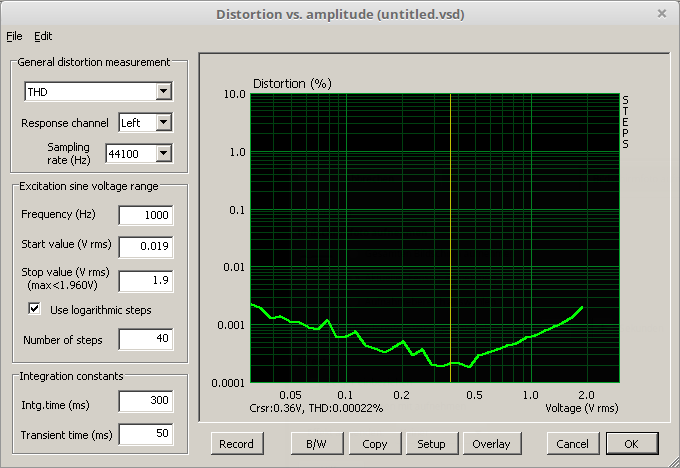

For measurements of Class D amps, do you use an antialiasing filter on the measurement input lead? I was warned that applying usual techniques for measuring analog Class A and Class AB amps to Class D May have problems.
This is how I measure my amps:
Howto - Distortion Measurements with REW
like Doktor Mord I am doing these measurements with an USB-Soundcard (EMU-202) feeding its symmetrical line input via a symm resistor divider from the full bridged output of the class-d-amp to be tested.
There has been no need for filtering the clock residual for measurements - at least with my EMU interfaces.
And the DAC output of these interfaces is imho good enough so there is no need for extra low THD signal sources - with their fixed single operating frequency and restricted level stability.
16bit soundcards like the Behringer are restricted to 96dB dyn range, while 24bit soundcards usually play in the +110dB league.
