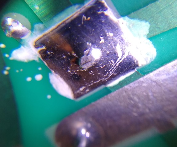

I bought this amp used several years ago, and it's wonderful. However, it died on a gig last night, and I need it for another gig on Thursday. I've purchased and downloaded the service manual with the schematics, but the parts list page for the preamp stage is wrong.. it's a duplicate of the parts listing for the power output stage.
In any case, here's the symptom, and I've never had an amp do this before. I'm hoping someone can point me to where to start searching for the cause..
While playing, it started to buzz very loudly and steadily, and turning the output volume and preamp gain down all the way didn't reduce the loud steady buzzing sound at all. I powered off the amp (I use it as a right channel in a small-room keyboard rig) and continued and limped through the gig using an SWR bass amp I use for the other channel and low end. I powered up the Trace a few more times throughout the gig, hoping it had just overheated or something. Upon power up, it sounded great... for a few seconds, then the loud steady buzz started up again. I gave up.
Sooo... I'm about to open the amp up, schematics in hand, and have a good 'scope, multimeter, function generator, and good soldering skills. What I don't have is a lot of experience troubleshooting. Any help would be GREATLY appreciated.

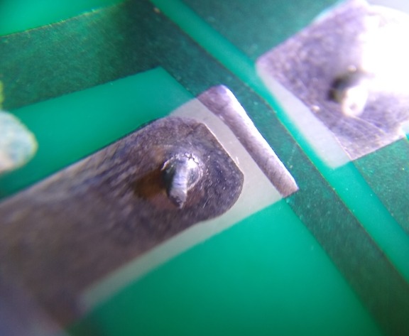

WOW... you are GOOD!Check C8 & C9 have not come loose from the pcboard.
Took me a while to see it, but yes, there's a definite bad solder joint/crack there, obvious under magnification.
Also... the ground connection has a good amount of corrosion surrounding it. What would cause that?
I've cleaned off and will reapply new thermal paste between the heat sink and case. There's a thermal pad (I think) without any compound on it between the heat sink and the power IC1, a TDA1514A, which has a metal surface mating to that pad. No thermal paste there. Is that correct? Just want to make sure prior to reassembly.
I can't tell you how much I appreciate the help. Hopefully, this was the problem!

@JonSnell Electronic - You nailed it in one! Amp is back together and has been sounding great for the past half hour. Thank you VERY much. Don't know where you're based, but if you're ever in the Syracuse, NY area, refreshing beverages and great food are on me!

Thank you for your generous offer but I am in Great Britain. Pleased to help.@JonSnell Electronic - You nailed it in one! Amp is back together and has been sounding great for the past half hour. Thank you VERY much. Don't know where you're based, but if you're ever in the Syracuse, NY area, refreshing beverages and great food are on me!
The capacitors are heavy, the amp vibrates when in use and the solder joints crack.
It is as simple as that.
Enjoy that bit of history and play on.
