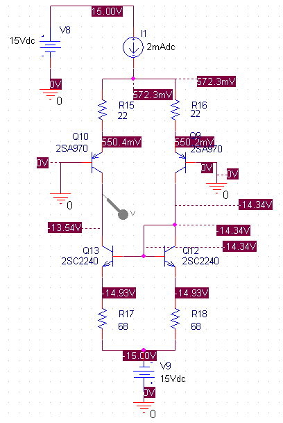

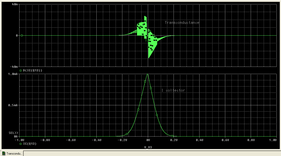

Hello,
I'm trying to find transconductance of an input differential pair because in Douglas Self's book, he starts calculations for VAS capacitor, knowing the transconductance (gm):
High Freq Gain = gm / (2*pi*f*Cvas)
When I simulate a simple pair in SPICE, there isn't problem, as you can see in attached files. If I simulate an active load pair, in the same configuration, the plot is wrong (see last picture)

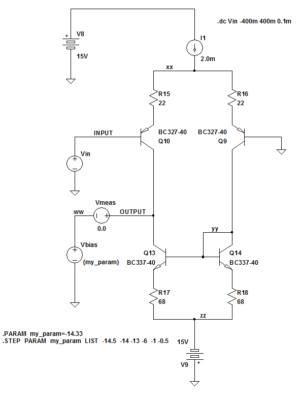

Oops, you have plotted the collector current of Q10, and the derivative of Ic(Q10) with respect to Vin. But that's not quite right: what you really want is to look at the output current of this four transistor stage. Output current is difference between Ic(Q10) and Ic(Q13). Transconductance is the derivative of the output current with respect to Vin.
One way to plot these with SPICE is to use a 0V voltage source as a current meter ("Vmeas" in the schematic below). Connect it to the correct bias voltage -- node ww is biased at the same voltage as node yy -- and Bob's your uncle.
Now plot the output current {namely I(Vmeas) } and the derivative of the output current {namely d(I(Vmeas))/d(Vin) }. Presto, you get the expected results, matching jony's hand calculation within the error tolerance of his (kT/q) number. When launching your SPICE simulation, don't forget to use a very small voltage stepsize (100 microvolts in my example) to ensure a smooth output curve.

You’re absolutely right. One of my problems was I had not set the required sampling precision necessary for the derivative.

Thanks to you, I have got the right figure as you can see in the attachment. (The schematic is slightly different because I’m using OrCAD 16.2 software)

A transconductance is a voltage controlled current source. Since a current source, by definition, outputs a current independent of its terminal voltages, transconductance should be constant and independent of bias voltage, to the first order.
Commanding LTSPICE to vary the bias voltage via the "STEP PARAM" statement, we see this is indeed so (simulation results attached): Transconductance is constant and independent of bias voltage, to the first order. Second order effects, such as finite output conductance ("the Early effect") and finite Beta, cause transconductance to vary slightly with bias point. Slightly.

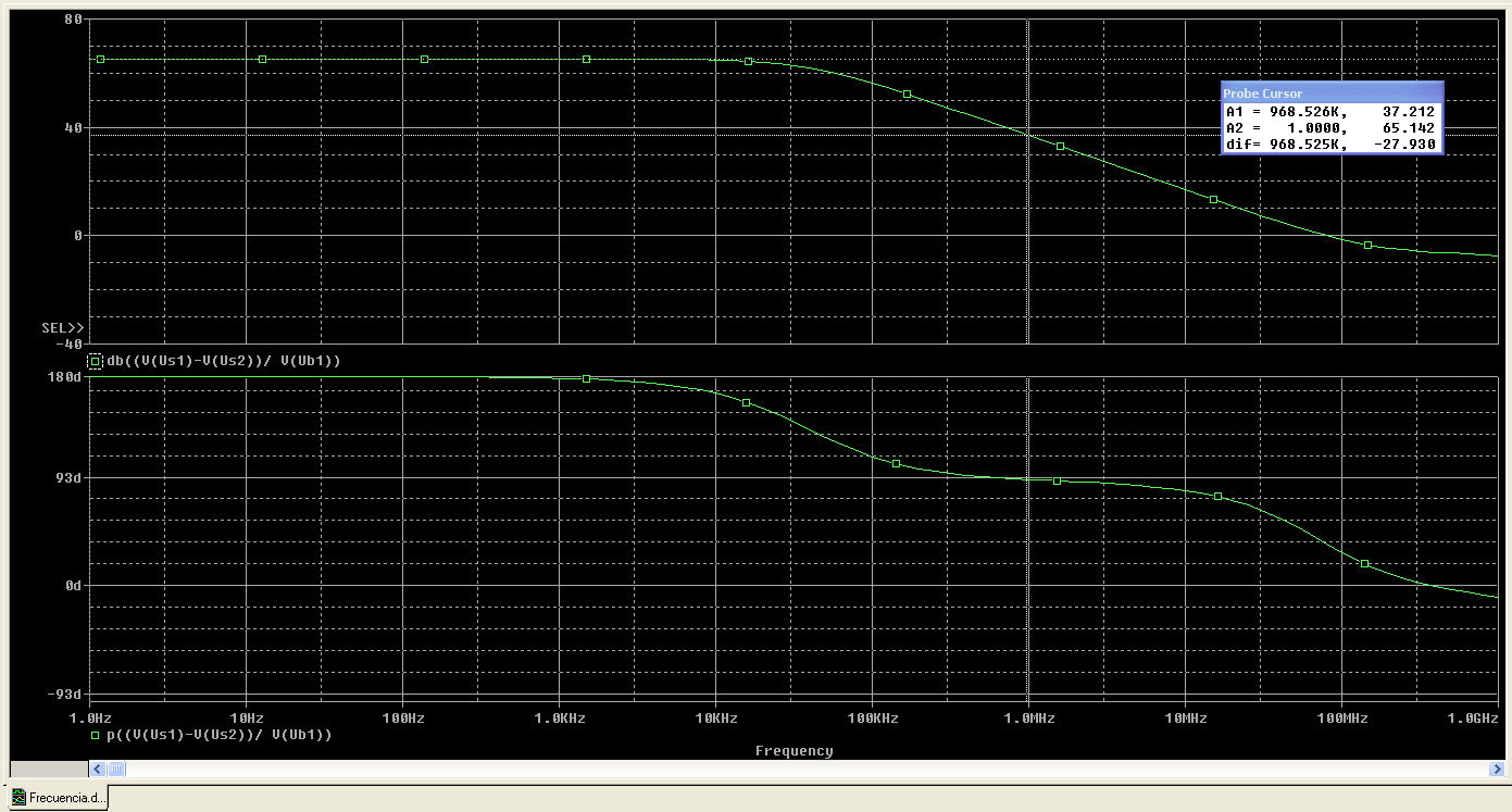

Hi sameerdhiman,
You can see the performance as regards frecuency in this way:
You draw the schematic with “Vac Source” (not “Vsin”).
Run “Ac Sweep/noise” (remember to set RELTOL = 1E-10 in simulation options)
And finally, you can see gain and phase, if you plot this curves:
Gain -> db((V(Us1)-V(Us2))/ V(Ub1))
where Us1 and Us2 are voltage across collector of differential transistors and Ub1 is voltage across base of left leg transistor as you can see in schematics
Phase -> p((V(Us1)-V(Us2))/ V(Ub1))
You have to obtain curves in a similar way they are in the attachment
As far as I know, the important thing is to know the transconductance, because a differential pair is a transconductance amplifier, not a voltage amplifier and the goal is to obtain a fine and linear current to drive VAS stage. VAS stage is a transresistance amplifier, it absorbs current and gives voltage (The opposite of transconductance). I suppose this analysis is better for knowing frequency performance.
I’m sure other people (transistormarkj, jony…) in this forum can give you a better info.
