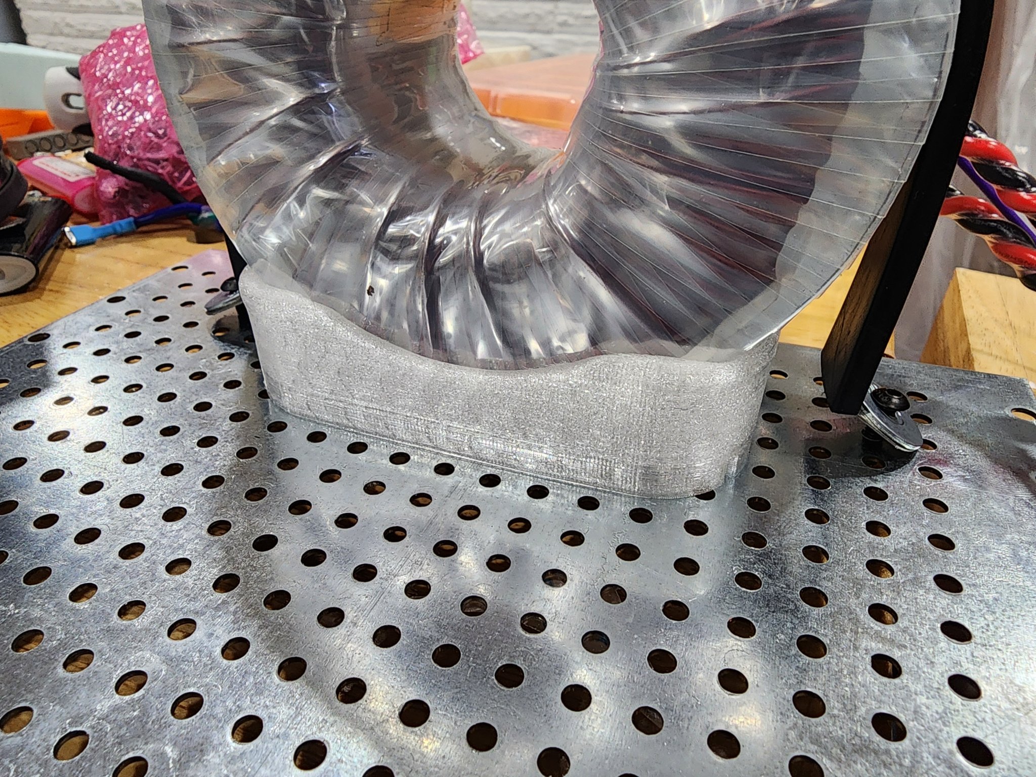

UPDATE NOTE: If you want to use an Antek 400VA transformer with this seat, you do need to use some 10-15mm spacers for the 130mm pipe strap. The slightly larger diameter of the 400VA over the 300VA transformer means there's a gap that exists between the chassis perforated plate and the strap ends. If you don't care what it looks like, then spacers really aren't needed as they don't increase the strength of the "grip". You do need to use longer M4 bolts (M4 10-12mm work for a 300VA, but 20-25mm are needed for 400VA. The spacers just make a cleaner look is all by flattening the tabs (see pics at end of this post and associated ZIP file with the 11mm spacer 3D file). Don't buy 150mm straps and think they'll fix the issue as those are too long. Stick with 130mm and either use spacers, or live with floating tabs (secure as a rock with either option).

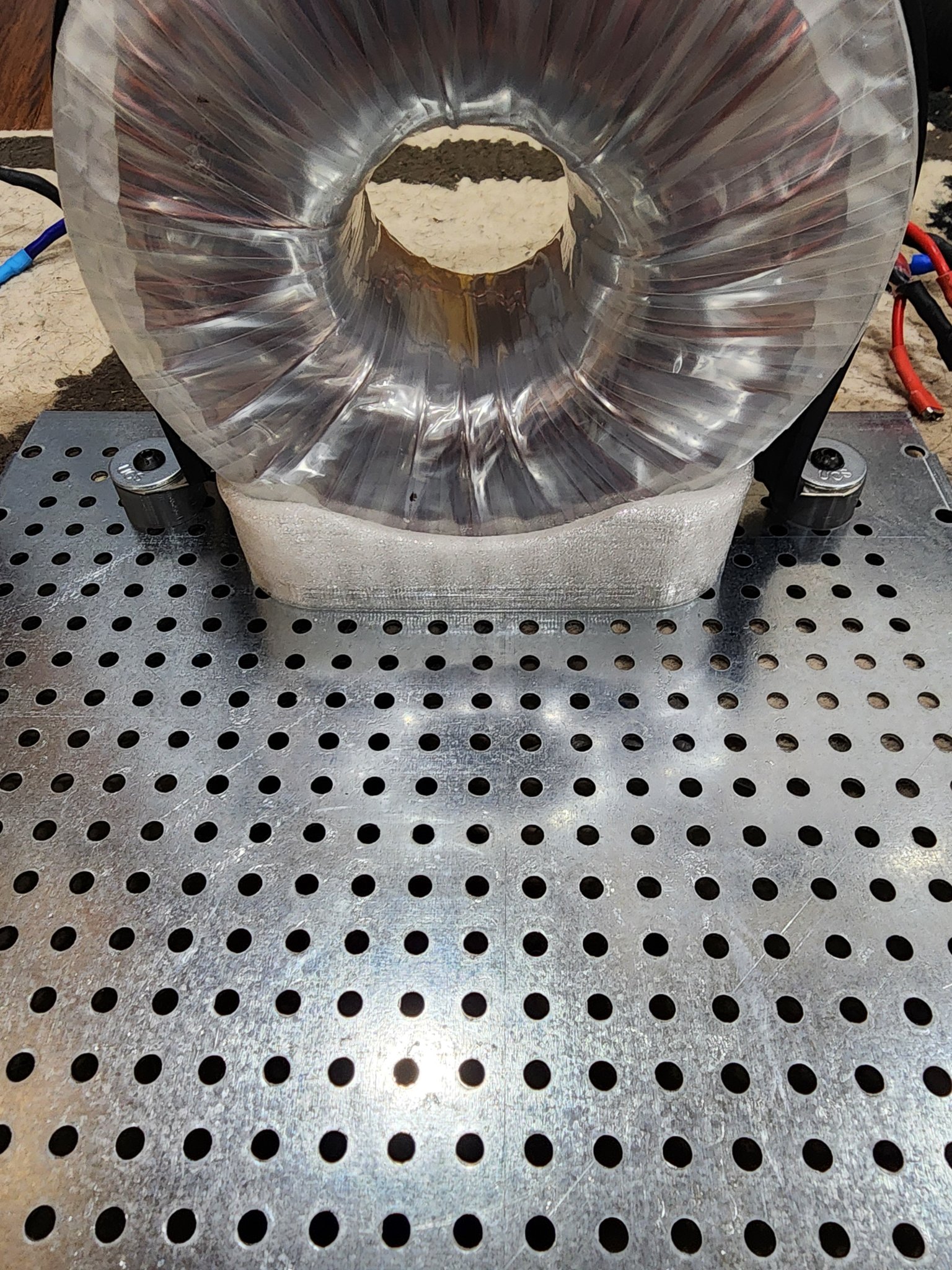

Here's a 400VA using 20mm M4 bolts without spacers. Still crazy secure, but kinda looks "janky". (not that anyone sees this once case is closed up)
Here's what the 400VA transformner looks like using 11mm 3D printed spacers. Just looks better, but no more, or less secure. Purely cosmetic.

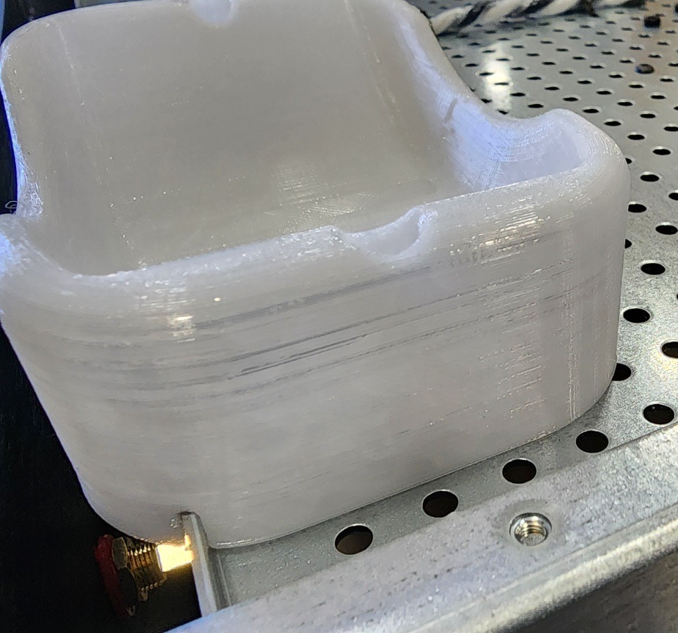

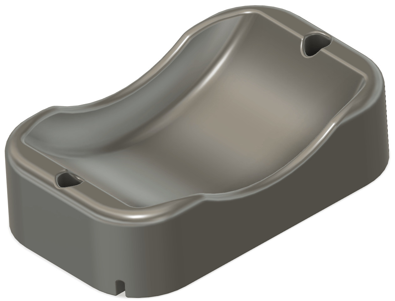

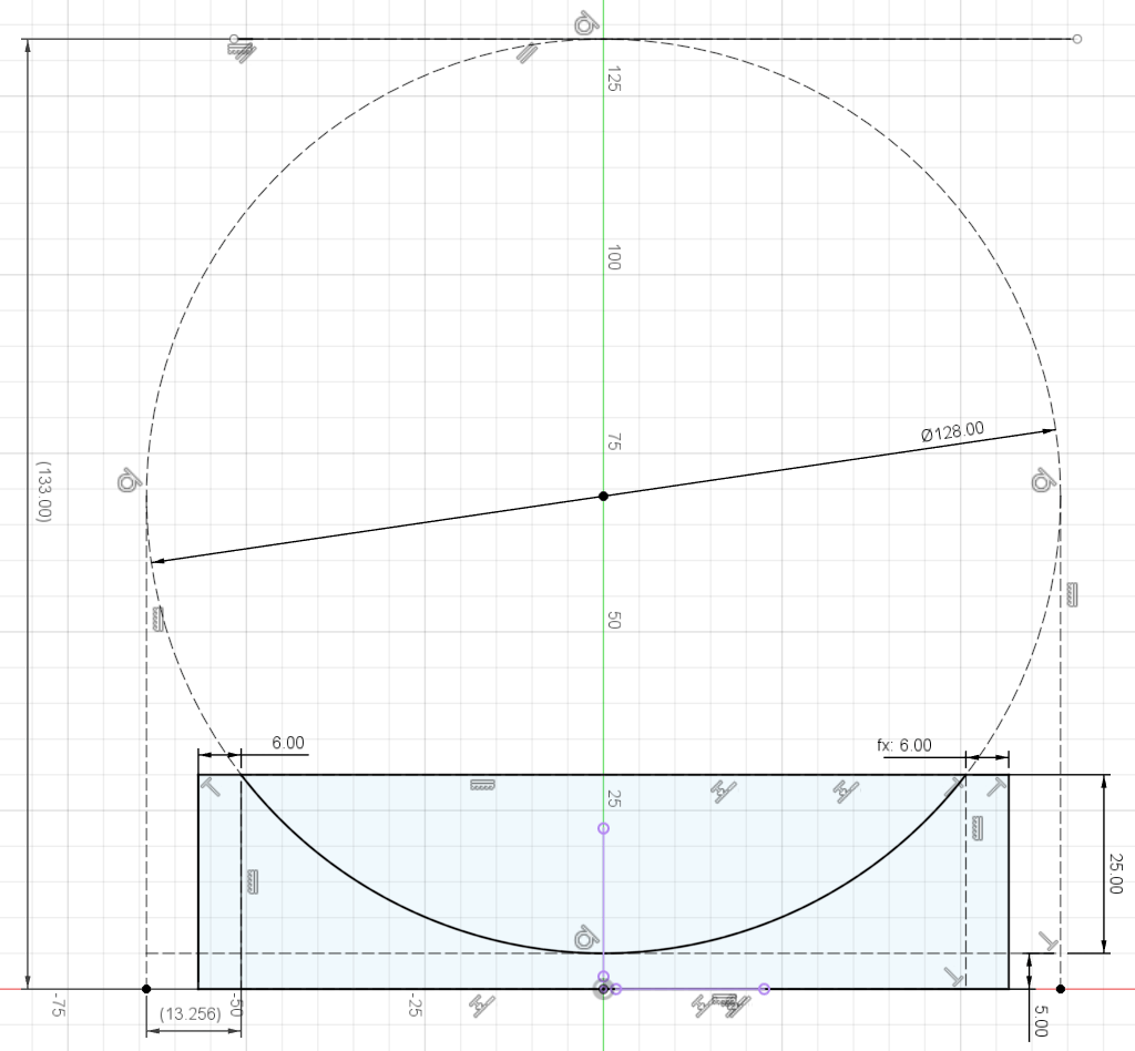

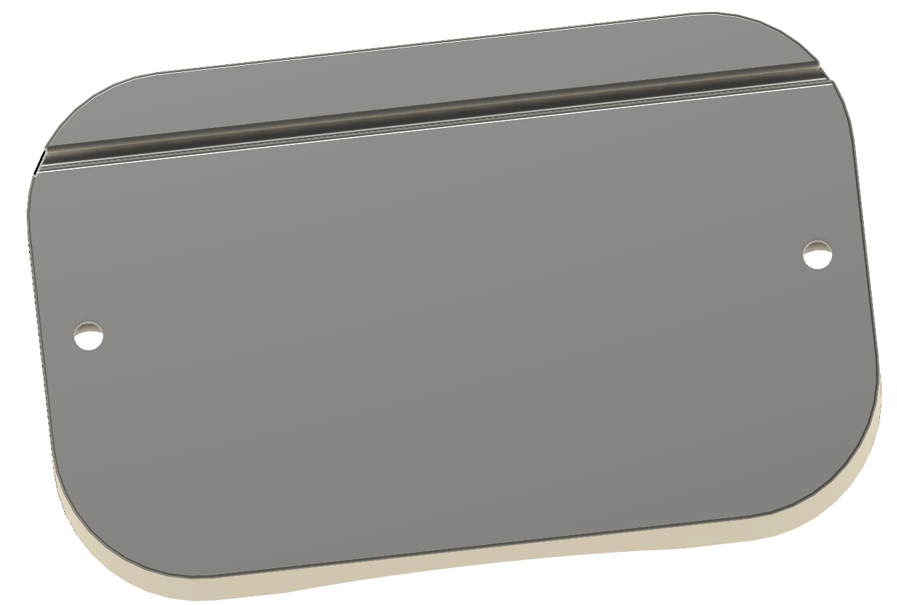

- Version 1 - Original Design, no slot for "lip up" perforated plate orientation. [I don't see any reason to use this since Version 2, does what this does and more. However, maybe being 2mm closer to the bottom is beneficial for a few folks.]
- Version 2 - 2mm Taller (allows more squish and squeeze) and has a slot to allow for "lip up" orientation of perforated plate if you go that route. Pics below are of version 2 showing the slot.

- NOTE: If you want to use a 400VA transformer you'll need M4 x 20mm bolts (25mm also works). Spacers are not a requirement, but will certainly make it look more professional. Spacer print is attached below, or use any spacer that is between 10-15mm.

- With your three hands (yeah, a third hand would help as its tricky), put the other end of the strap on compressing the transformer into the squishy seat to get the nut to thread.
- Tighten it all up nice and tight....all done.
