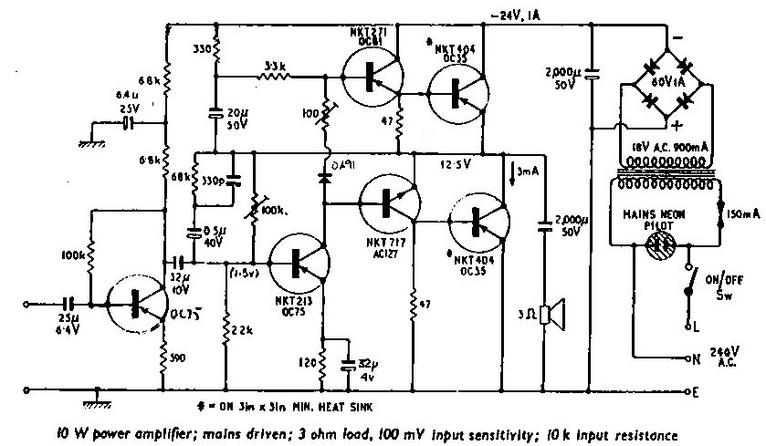

Why do you need transformers. You can make a Germanium amplifier without them. What power do you want? Would 10 watts be enough?
How about this one? 10 Watts into 3 ohms. I don't know where it came from but I've made a few. I think it was originally an amplifier for an organ but works well on guitar with a suitable preamp.

Thanks much for the post -- from what I know (not much) this looks to be single ended OC35 OTL amp that is directly coupled (no interstage xformer required). Right? Can't read all the transistors -- could you help out there? How did the overdrive sound? Very interesting. thx again.

Yes you're right Moonbird. First and second transistors, are OC75 or NKT (Newmarket) 213, upper driver (PNP) OC81 or NKT271. Lower driver (NPN) AC127 or NKT717. Outputs can be any of these OC35, OC36, OC28, OC29 or NKT404. There are also many other alternatives which can be used. Never tried overdriving it, we were after clean then - before fuzz etc.
