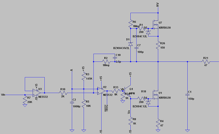

Thanks for help.
Here is the schematic. It is a high voltage amp , only one half of bridge shown.
I have now inserted a resistor divider before base of Q1 , but , i think it would be even better to use a base resistor and diode at emitter - base instead.
Lukas.
Thanks for help.
Lukas.
I would delete R34, it wastes half your drive voltage. A diode from E to B probably is best.
You could also put a diode in series with the protection zener on U1 so that the transistor E can swing down to the - supply which would avoid the problem altogether, but I don't know what the allowed neg voltage on the FET gate is.
If you can increase R33 to limit opamp saturation that would also be good.
Have you simulated this? How do the curves look for Vbe?
Jan Didden
Jan Didden
