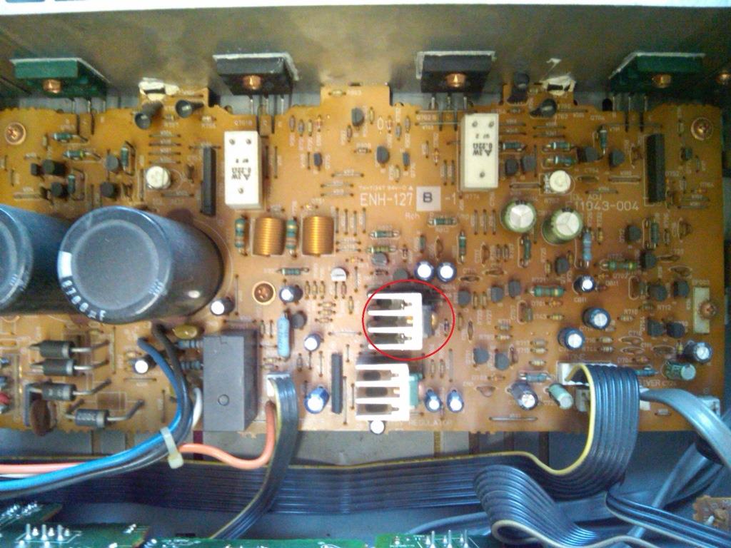

hi, i got an early 90's solid state amp and , still working but the transistor (type 2sd2061 Rohm) just after power supply (circled in red on the photo)
and since i like the simple way it was designed i'd like to upgrade some components to improve the sound, so i'm here to ask some help about which components i can and i cannot modify
but before i've got to fix the excess heating transistor

hi Mooly thanks for your answer, you think so (i'm not an expert) but it's hot it's burning when touching it, and it leave black marks on the top and ont pcb,
i've dissassembled it and tested it with multimeter diode mode and it's ok
i've looked around it and nothing seems burned
Almost certainly its OK and the discolouration of the PCB is a normal chemical reaction to the heat. The only thing to check on parts like this is that the heat hasn't caused the soldering of the leads to crack and become intermittent.
Look at the middle leg of this power transistor. The solder has a ring around it where it has cracked due to heat. Very common problem generally.
Not an unusual problem with Japanese amps from those days,I have seen lots of discoloured PCB-s due to excess heat (worse, the transistor legs melting out of the board). If it concerns you, replace the heatsink with a bigger-black anodized- one (if you can fit it in).
ok, thanks again Mooly i think you were right, i've seen on another site with an amp from the same mark and serie that that this specific transistor got an over heating problem with the years.

When checking heat and pretty much everything - dc offset, even noise and distortion, try comparing it against another identical or similar component. Like in your case the regulator transistor, the other heat sink below it is presumably for the other voltage rail. If they're the same temperature I won't care too much, even a 5 to 10 degree difference if it is explainable. But if one is cool and the other is scorching hot and they perform a similar task with similar designed power dissipation, yes then worry.
But then again it isn't unusual if the amp designer decides to give the positive regulator the additional job of running the digital and control circuit. A DAC can add a few watts and consequently more °C to the regulator.
