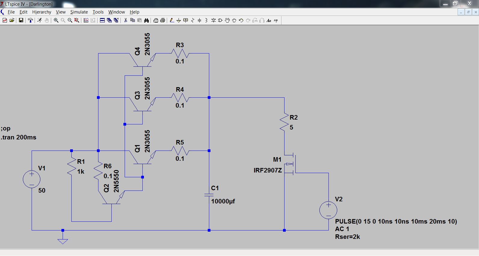

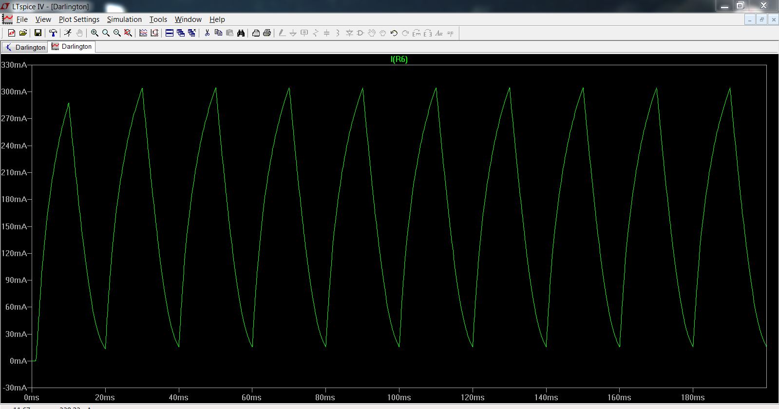

I ran a quick sim too for curiosity on a darlington set up. Not the identical circuit but non the less....
Driver current was over 10 times your 25ma. Don't under estimate the operating conditions. I saw afterwards you have 70v ish rails. You need higher spec devices than the TIP's imo. They are not robust. Also simulation doesn't allow for the beta droop at high currents, in other words the gain of real devices will be lower than the sim suggests.

This is a power supply for a class-D amp. It's described in more detail, including the schematic (old version at least) and results of sims in post #6 of that thread.
I can't say why you are getting larger currents. Maybe it is because you are simulating something that is very different that my circuit??? I have posted an updated version in the thread about the CM, post #10.

I was simulating a varying load on the rail and monitoring the driver current, which all sprouted from the question of what the "turn off" resistor did in post #1
