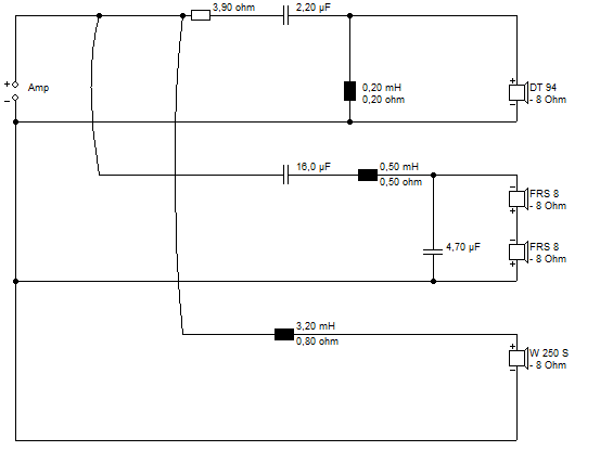

An idiosyncratic design with bathroom tiles (an idea tried out by Joachim Gerhard too...) and huge stuffing. Might be possible to add a reflex tube for more bass. Or a sub-woofer.
Am deeply interested in the crossover. A low bafflestep design here by Solen.ca:
Relies on impedance correction to work.

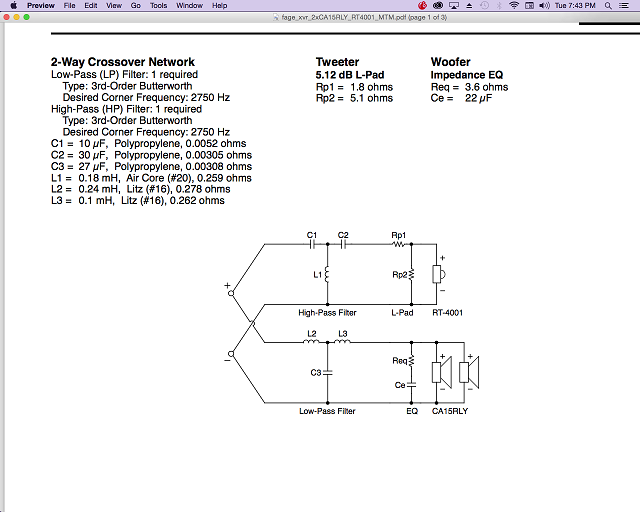

I finally got Soundeasy set up and I took some measurements. I don't know how much I trust the data under 1k, but above 1k it seemed pretty repeatable. This indicates pretty poor tweeter matching, but interestingly, the flatter response is the tweeter that was pushed in. Once I get a little more fluent with Soundeasy I'll start testing the individual drivers.
