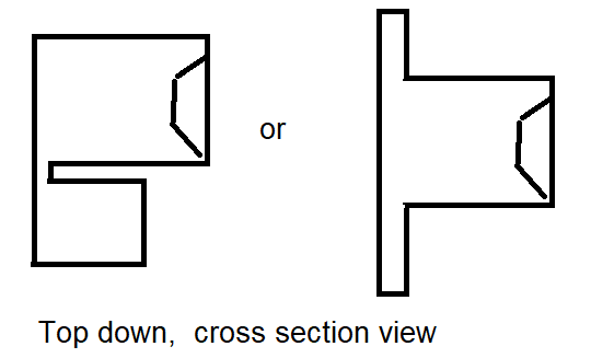

With that said, I can increase the volume using odd size extensions to the enclosure, but I think my ideas would create more problems even if the total volume is identical, right?

P.P.S. If you you wish to extend the 1.35 ft³ volume, then I would avoid the narrow passageway to the additional chamber shown in your left hand diagram.

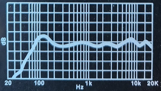

Without getting too weird with the shape (back is a little taller than the front) I got 1.53 cu ft.
The original box 2.06cu ft, Tunning frequency 40hz. Fs is 138hz.
If I adjust the port to tune it to 50hz+ and 1.53cu ft. I have a pretty good idea of what happens bellow Fs (it's covered in detail in 100's subwoofer guides)
This is a full range woofer high end rolls off around 9khz.
How much will smaller enclosure, tuned higher affect the response graph from Fs and up (138hz-9khz).
Am I going to lose sensitivity and add spikes/dips in the response?
Or should I keep it at 1.35 ft³ with the aperiodic design you suggested?

I'm sorry, but I can't predict the effect on the response of tuning the smaller enclosure to 50 Hz - that would call for an expert like GM!
I can predict that, if the 12" driver is running full range, the aperiodic enclosure will provide an upper bass performance that is resonant free, resulting in good transient response and an 'open' sound. This is especially beneficial in providing clarity to deep male voices.
The external subwoofer wll take care of the lower bass frequencies.
You could experiment in three stages. Stop at the stage where you think the sound balance is satisfactory.
