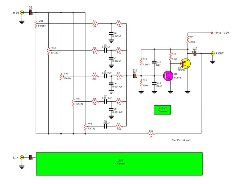

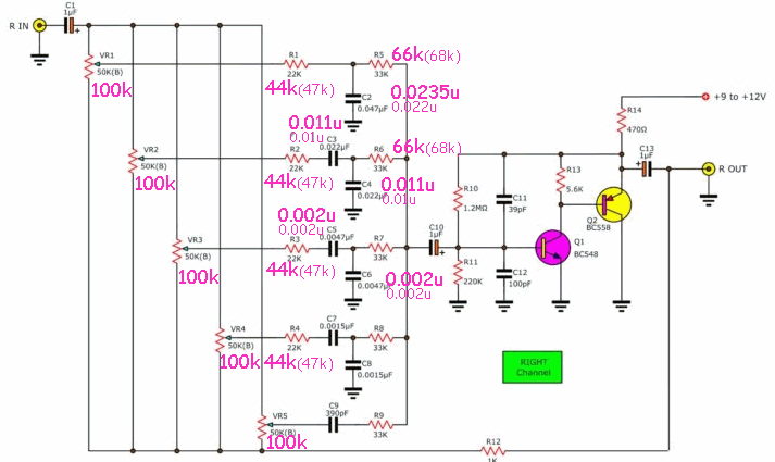

Ok still need help. In this circuit diagram he has used 50K trim pots.
If I was to use 100 K trimpots in the same circuit VR1 to VR5. what caps and resistors would I need to change ?. A simple red circle would do.
And by what factor. If this doubt is clarified I can start entering up various ideas in the simulator and see the results.
Fiar enough I just needed a pointer. You saved me a few hours of reading and a lot of head scratching. For which I am much obliged.

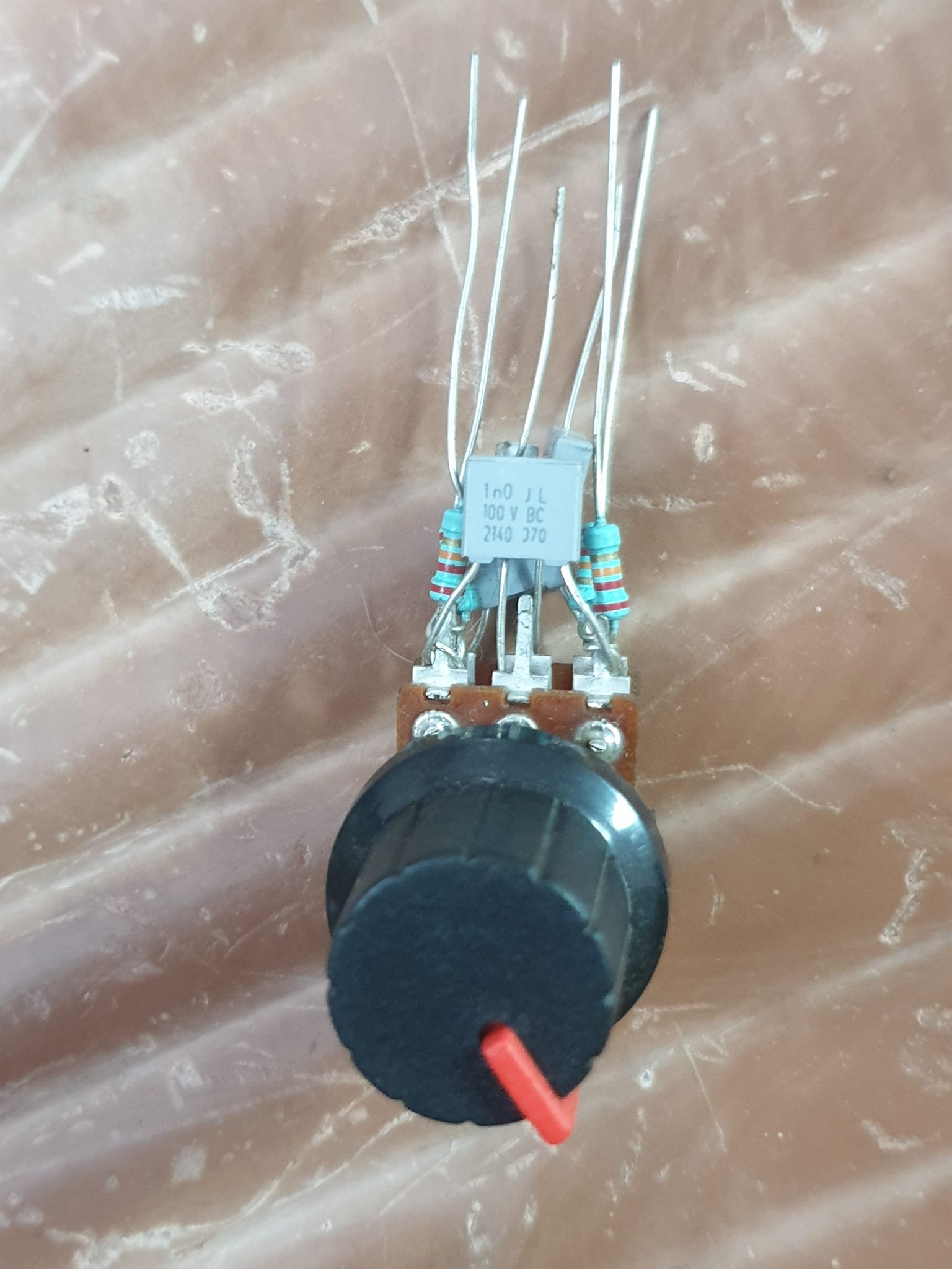

So I have come up with this idea. For testing.
I will have 5 knobs or 10.
Each knob has 4 caps and 4 resistors. Double gang knob. So 2 caps and 2 resistors per channel.
Each knob is designed to work with a specific freq.
So knob 1 = 2000Hz.
Knob 2= 4000Hz
Knob 3- 8000 Hz
And so on.
Each circuit is tested in the simulator and then on the scope.
This will let me confirm I have the right Trim Pot value. And its doing what it should.
I will add the schematic for this knob in a bit. I also need to confirm that they behave as they should when chained together.
