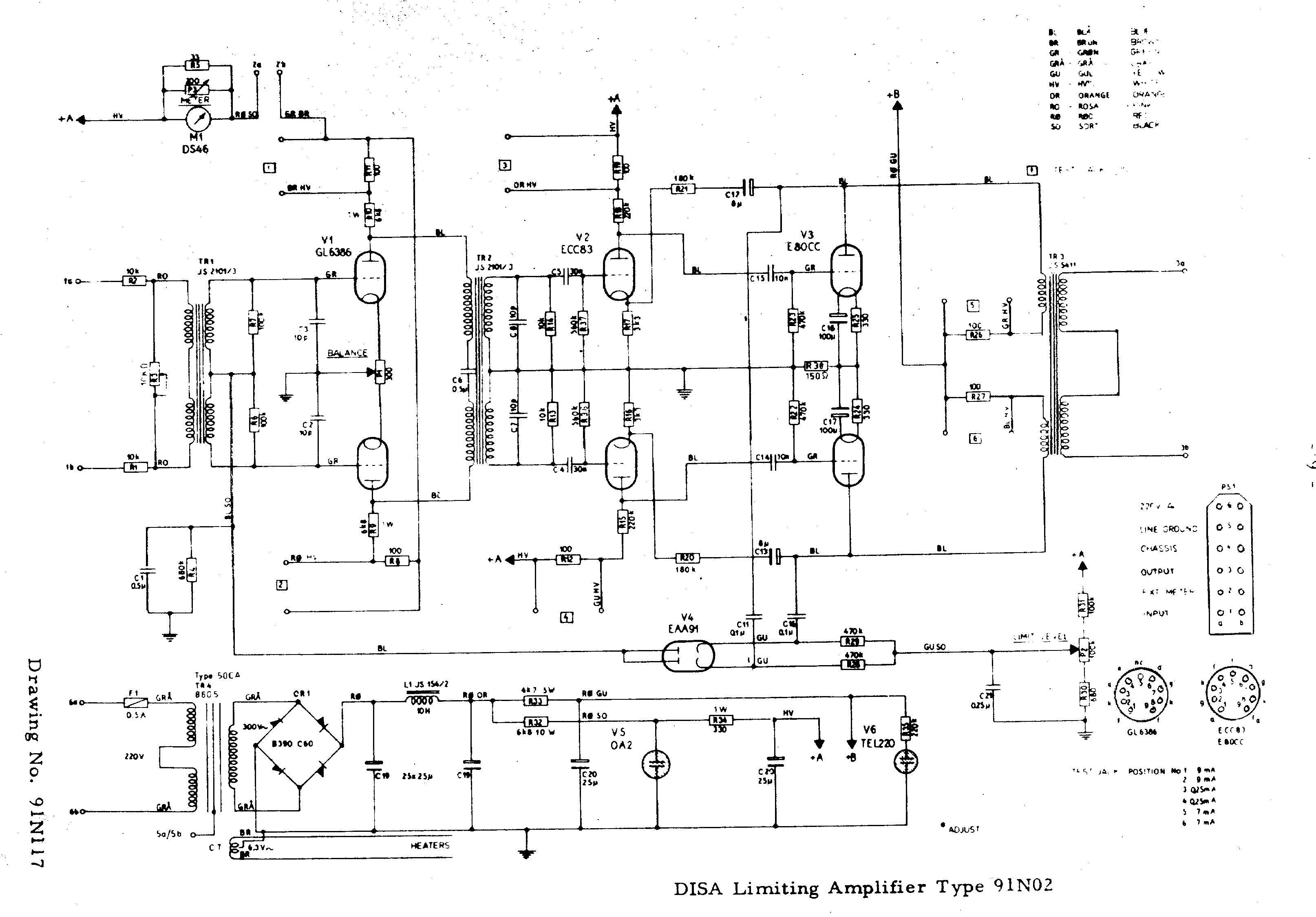

Perhaps the single biggest design challenge in using a valve as a variable resistor is that changing the resistance changes the dc operating conditions and it needs to be biased to some quiescent current in order to act as a variable resistor. This means the control voltage appears in the output signal. In a synth with relatively slow moving control voltages this is not a problem and can be reduced by using a low value coupling capacitor.
In a compressor, where you probably want a fast attack time and good low frequency response, this is a problem and manifests itself as a thump in the output. Vari-mu compressors have exactly the same problem. The classic solution is to run a balanced pair of tubes so the thump cancels in their output. That is why most vari-mu compressors have a 'balance' control to minimise thump.

Re the original question: I think if you used a vari-mu triode you would end up reinventing the vari-mu compressor, and if you used an ordinary triode it just wouldn't work very well. Audio tubes are designed for linearity, that means they try to minimise variations in mu, gm and Rp with current, so they don't work too well as VCAs or voltage controlled resistors. The 12AU7 is pretty nonlinear by audio standards.

The only parameter that is relatively constant in most small signal triodes is mu. Both gm and rp vary over a wide range with operating current. A vari-mu compressor does not work by varying mu; it works by varying the stage gain which it achieves by varying gm which it achieves by altering the grid bias voltage. I guess vari-gm did not sound so good to the marketing men of the day or maybe they were just trying to deliberately obscure the way it actually works.

Well I'm gonna build something, one of the two -- whether it's the DISA limiting compressor on Gyraf's site that Manley huh
What about making a cheap opto cell with auto resistors from Radio Shack like throwing something together really quick and easy with parts that are available but I don't have to purchase online I eat I can have it done today for testing (the opto-cell that is)
What can I make w/ Cadmium-Sulfide Photocells + some LEDs? *Yes Money is an issue -- but still Quality trumps spending additional money. The whole point of me saying I wanted to use the parts I already had available was because I have so many parts -- I need to start using them. Period. Well I'm down to try different ways of achieving our goal here -- which is in-fact having an Audio Compressor/Limiter based on vacuum tubes. I am not a purist so semiconductors are wekocme (specially in regulation of the supply). All-in-all I just want to get this project done + ready to test so I can be used in the studio asap. So again. I'm up to anyone's ideas + imagination.
I will do some reading today on the Vari-Mu design + study the DISA schematic I posted above. I will also try my handout on making a cheap Photo-resistor (like T4B) w/ the photocells I mentioned ^above^.
