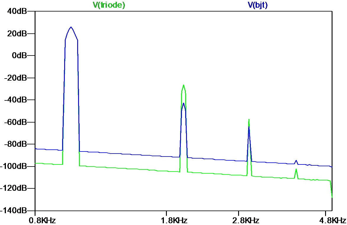

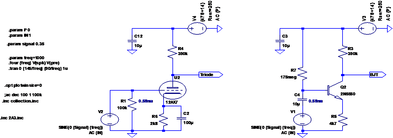

I know it's only spice but here's a comparison between a common cathode amplifier using 12AX7 and a common emitter amplifier using a typical BJT. The BJT has to biassed differently because it is not a depletion type device. It also has an unbypassed emitter resistor in order to match the gain of the two devices.
So - same B+, same signal, same gain and same bias current. From an FFT perspective the BJT beats out the triode.

The voltage at the plate of the tube and collector of the BJT is just over 200V. hmmmm, that's actually too high for the BJT I've used.
Joined 2009
I think it's better to remove the input capacitor in the BJT circuit so that the two circuits are DC coupled. Otherwise the triode one will have better performance at low frequencies.
Isn't the BJT going to have higher output impedance in this configuration ?
However more to the point, who is ever going to run the BJT in a way to achieve the slightly better performance ? I suggest no one.

A 175M bias resistor ? The bias is hopelessly inaccurate.
Bias should never depend on device hfe.

Nothing especially new or surprising there: for a long time now (at least 40yrs), transistor amps have soundly beaten tube ones on specs.So - same B+, same signal, same gain and same bias current. From an FFT perspective the BJT beats out the triode.
It is as difficult to find a solid state amp doing worst than 0.1% THD as it is finding a tube one doing better than that.
The reason is simple: transistors may be intrinsically more non-linear than tubes, but they also have a much higher transconductance, and can tolerate a much higher level of local degeneration for the same stage gain.
The result is a higher (apparent) linearity. To compare likes and likes, another configuration or tube type might be required.

You need to look at the higher harmonics, not just 2nd, 3rd & 4th. Low feedback around a BJT stage may sound bad. High feedback may be clinical sounding with the 2nd H gone too. FETs are very close to the best triodes (pentodes actually), just higher gm, so you can linearize them further as an option.
But 2nd harmonic is what 300B buyers are paying (dearly) for, more linearity would sound clinical.
I noticed that in the original FFT plot the fourth and presumably higher order components of the BJT were higher than the Triode. This suggests that the BJT stage will sound worse than the Triode in this setup.

No, simply no: while it is true that the output conductance of a common emitter stage falls if the emitter degeneration is increased, it will always remain two orders of magnitude lower than the collector load resistance required for proper output biasing.If we use emitter degeneration then the impedance rises and the ability to drive the next stage falls.
A Bjt is nothing like a triode, more like a pentode for the output characteristic at least.
This means that the output impedance will always be dominated by the physical collector resistor (unless an active load arrangement is used).
You can mimic triode operation by lowering the collector load if that particularly bugs you.
Otherwise, you can resort to typical semiconductor techniques and add a follower: additional transistors are almost free...
I did the same thing earlier this year with 140v and 12ax7 vs 2N5551.
I biased the transistor 470k and 7.5v zener supply.
