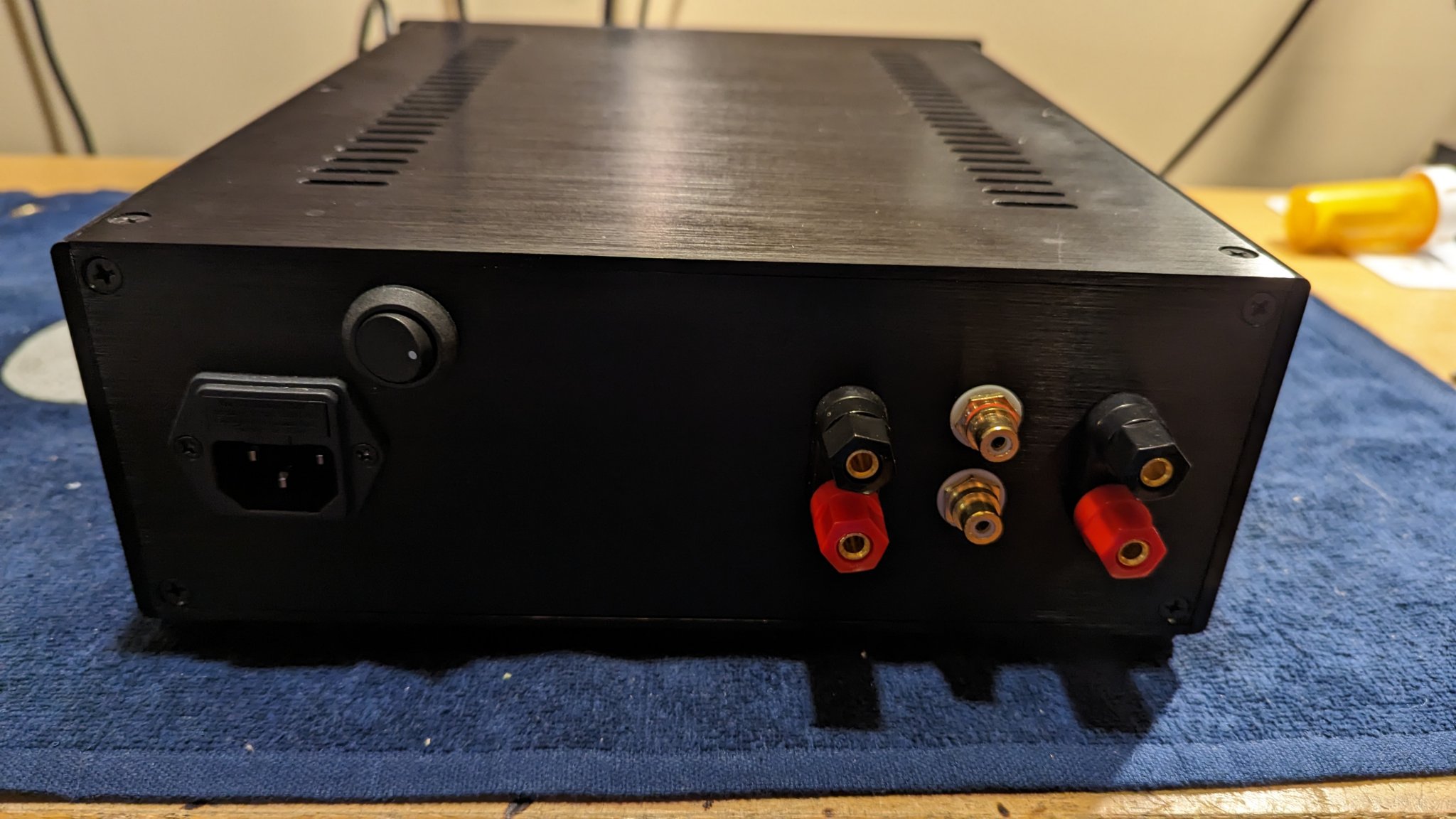

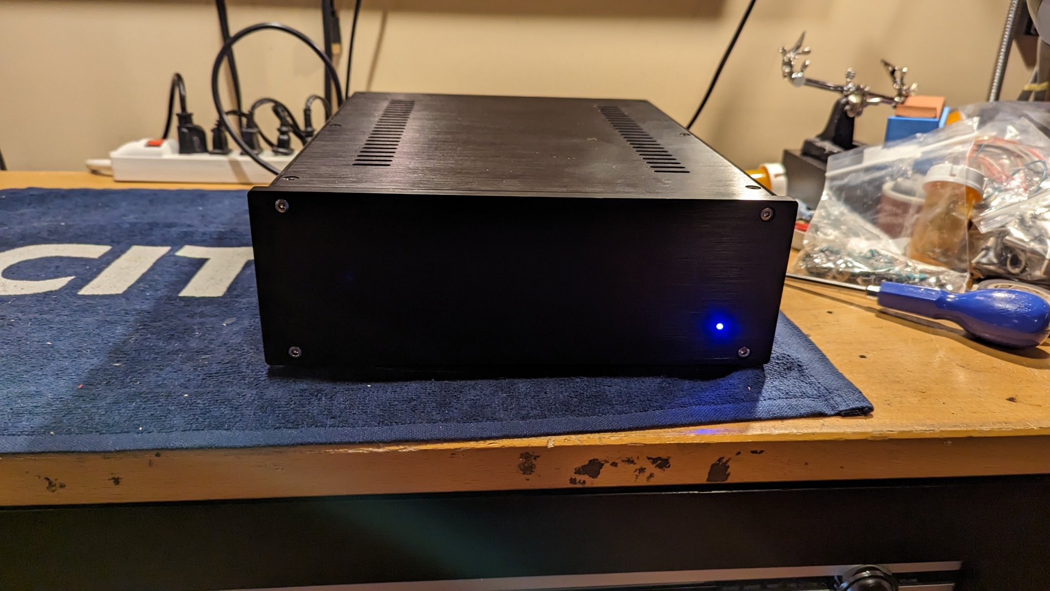

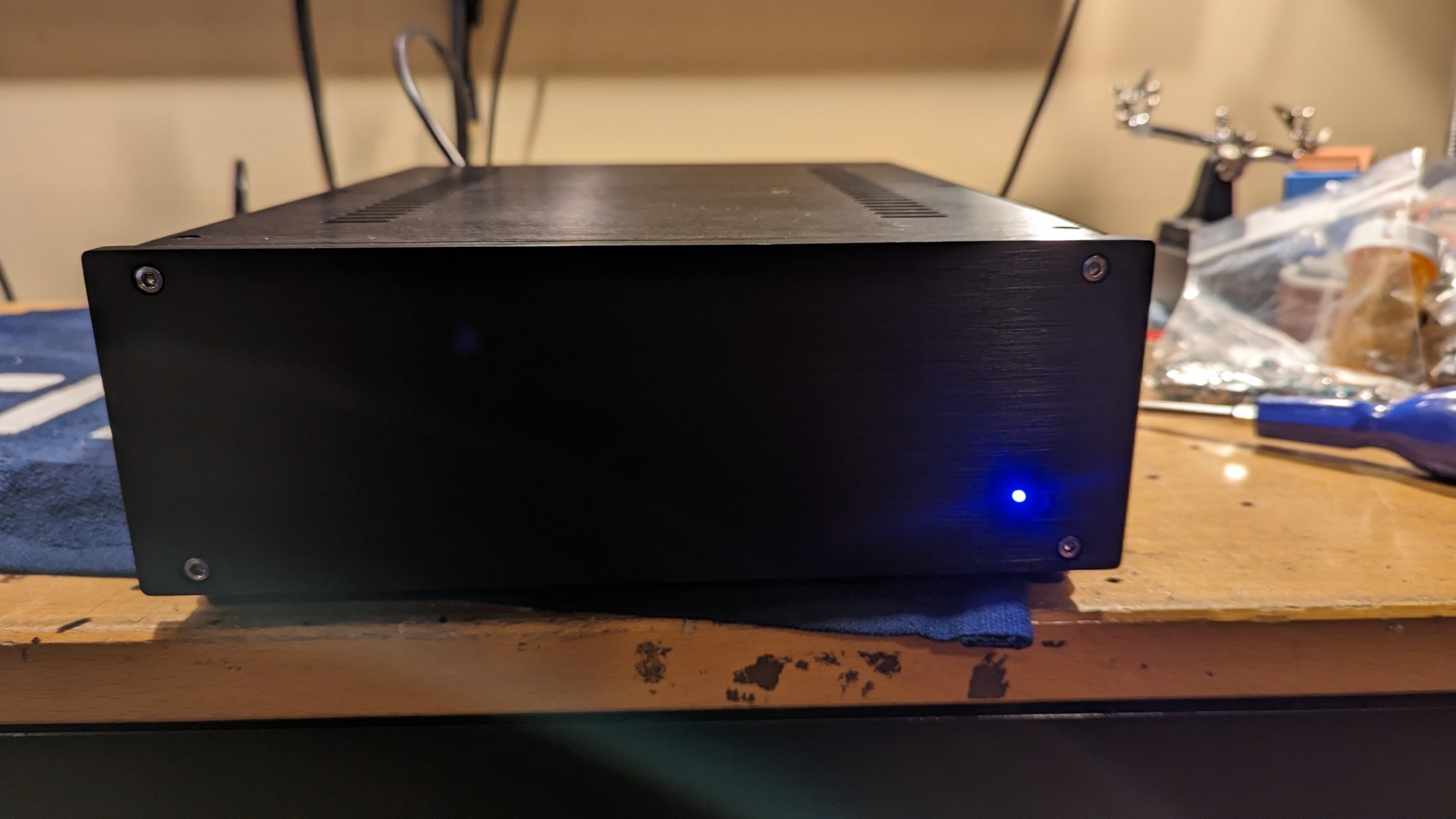

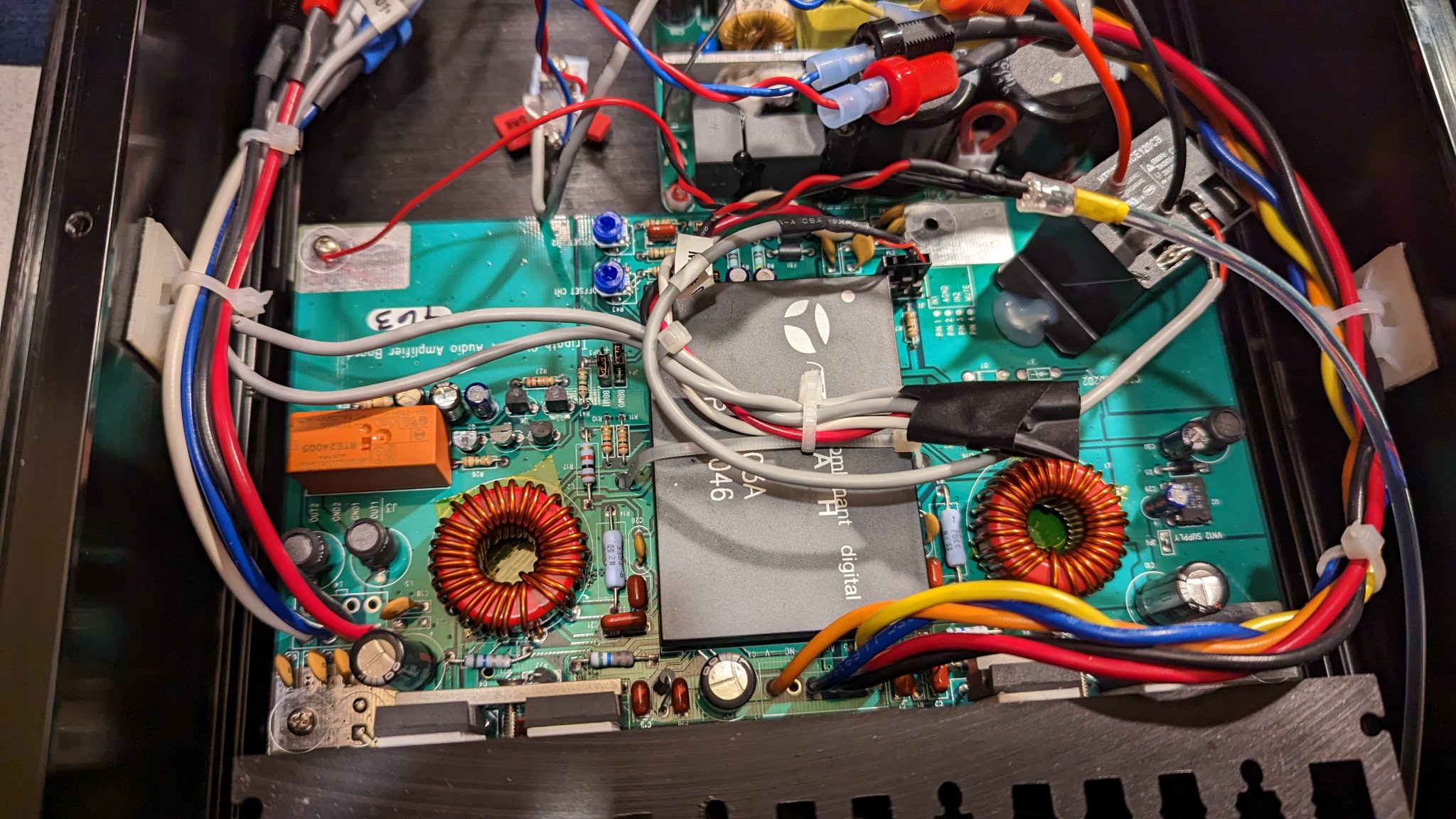

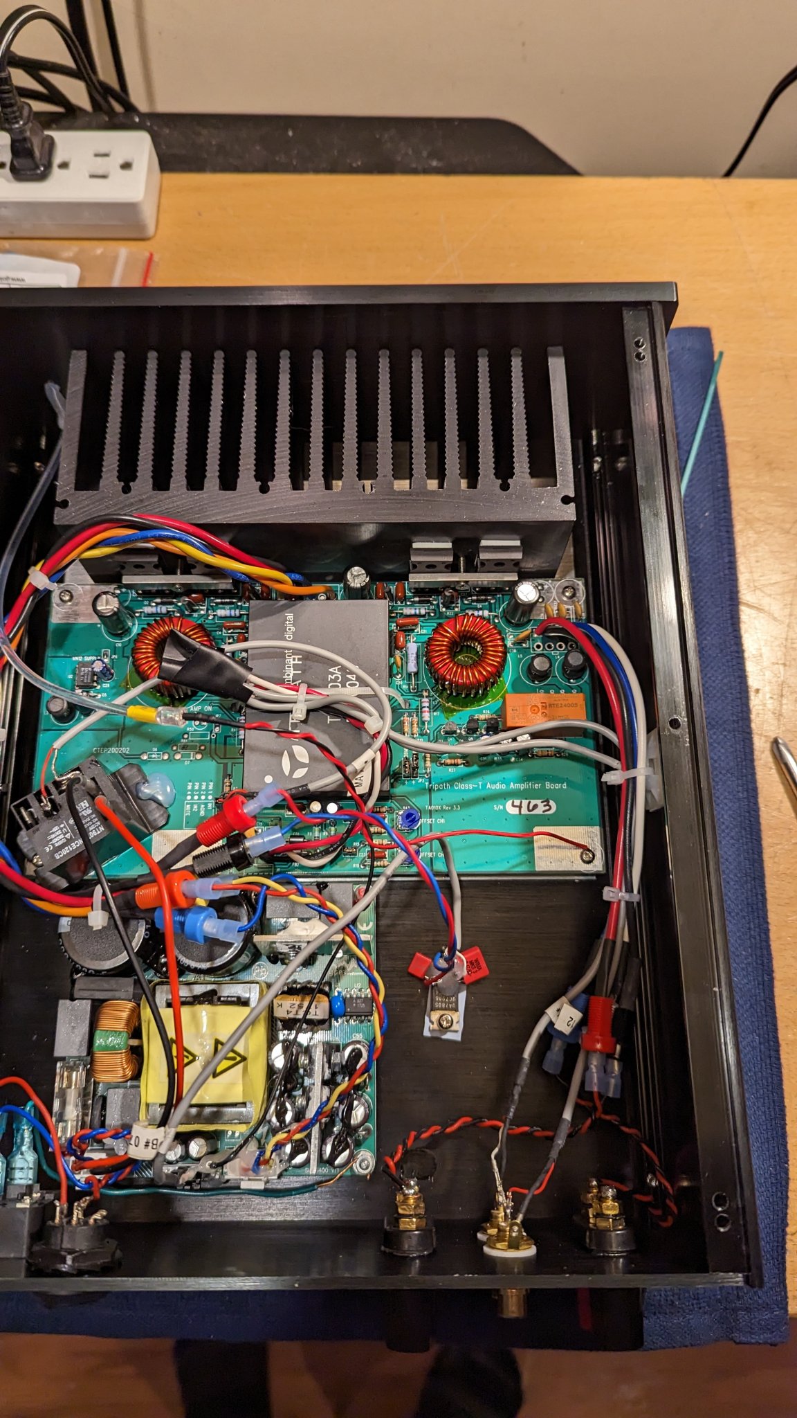

Amp built years ago when TA0103A were popular - with a Hypex SMSP400 SMPS. Turn on and Turn off thump (these Tripaths were notorious for these thumps) have been mitigated with delays.
Sounds great / clean. See attached pics and Application notes.
Ships from West sub of Chicago
How's $450 + ship? CONUS only please....

Hello,
I have attached the Technical Information sheet that may answer your questions. The Power supply is a Hypex SMPS400, so it is 400 watts. Turn on / off thumps have been mitigated with various relays.

Thank you, I've seen the reference PDF. So your amplifier is a straight reference design board? Who built the board? Where did it come from? Did you put the pieces together in a case? It looks nice btw.
I could be wrong but from my understanding, tripath provided a reference layout but only sold the chips, so a prospective builder could just copy their reference design or they could modify and potentially seek to improve it. The "better" tripath amps commercially available back in the day weren't typically reference designs afaik, not that the reference design is bad. But that PDF only discusses the board, not a complete package with the hypex smps. I find it curious it only specs 250wx2 into 4 ohms and doesn't mention an 8 ohm power, nor multiple voltages, and only gives the single .1% thd number... Most of tripaths literature for other models had more information.
However from the 250w spec at 4 ohms it does seem the 400w smps could hold it back some depending on the load. The amp could theoretically put out 125w at 8 ohms at that voltage, and might be capable of quite a bit more if it can handle more voltage.

The amp Board came from Profusion in UK a number of years ago. From what I understand, the board was made by Tripath - its the TA0103 Evaluation Board. The attachment I posted is the actual Evaluation Board, hence the filename eb-ta0103. There is an eb-ta0105 evaluation board that Tripath made too that had higher voltage rails.
The TA0103 TA0104 and TA0105 were put into Carver Z amps, Audio Research 150.2, 300.2 and Bel Canto EVO amplifiers back in the 2000's...
As far as I understand, you do not need 500 watt power supply to power a 2 x 250 watt 4 ohm Class D amp for music...I remember an ICEPower 2x500A amp kit powered with a single 400VA transformer...
