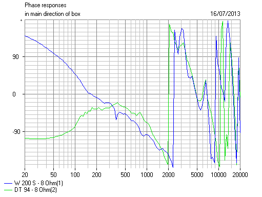

AllenB is correct, your only solution for phase is to modify the order of your networks.
Looks like you are about 60-70 degrees apart. Increasing either woofer or tweeter one order would be about enough to bend tweeter phase up or woofer phase down the right amount. Otherwise decrease order by one and flip the tweeter polarity.

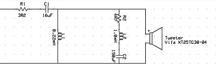

The XT 25 is a very tough tweeter to work with.... It has no ferrofluid in the gap, and mostly because of that (also due to its badly damped resonance chamber) its low end response can be terrible, both frequency, and phase-wise. Unless you use an impedance correction network, right before the tweeter. One possible solution is on the picture, but you still should use 2nd or 3rd order network at minimum 2 kHz. The 16uF cap on the drawing is a bit idealistic, it should rather be around 8-10 uf (max). You can also try carefully remove the resonance chamber, and fill it densely with wool.

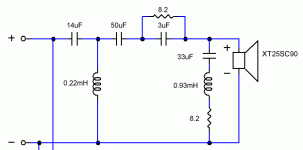

I find most tweeters need a LCR when crossed near 2kHz. I normally use 18dB/oct, sometimes resorting to 24dB/oct if necessary.
Below is my network for the XT25SC90 (2,250Hz || 18dB/oct). More information can be found at SWIFT-II.
