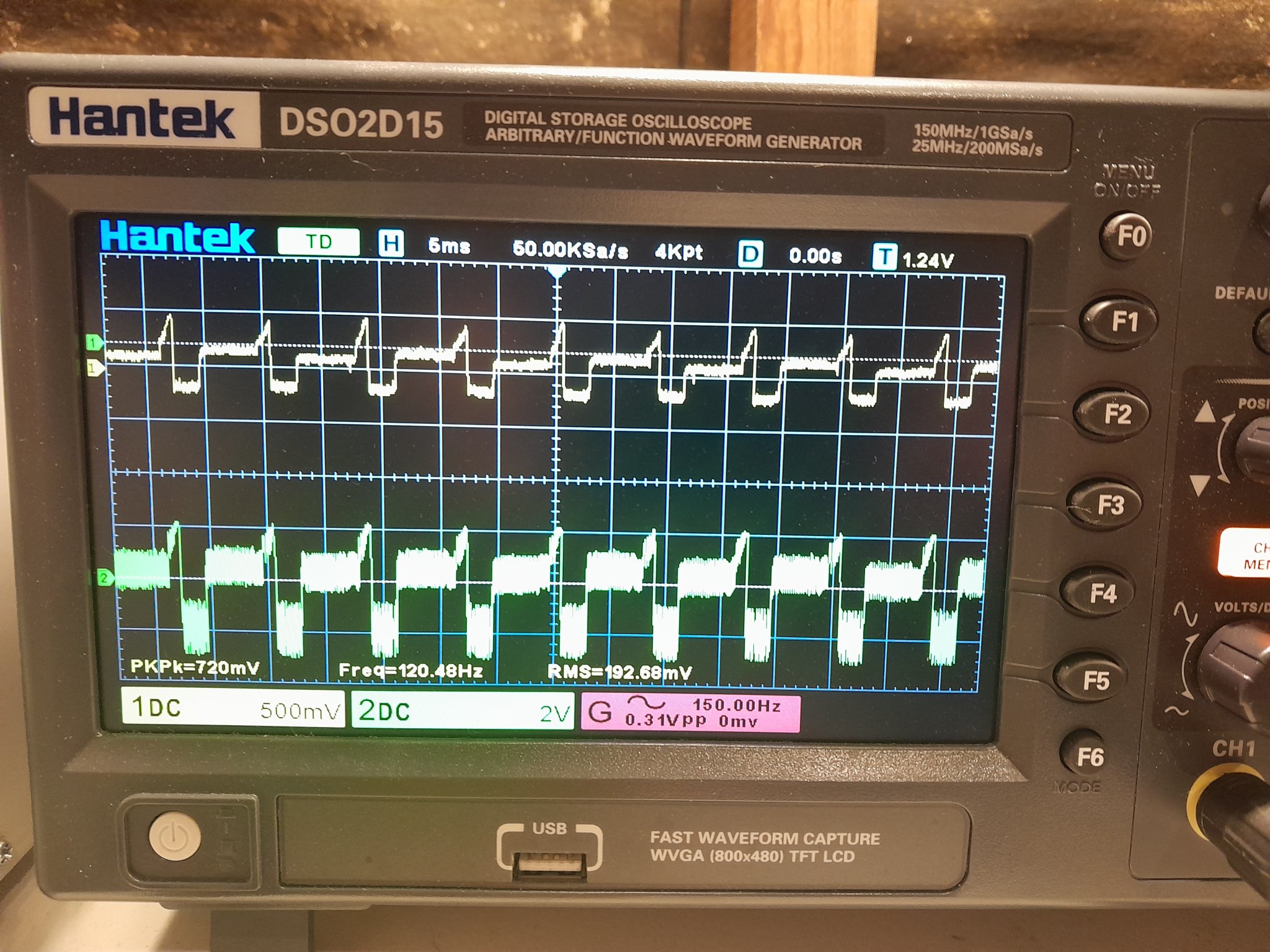

** Its too late to go back and edit my original reply, but it's present with or without the jumpers in. It does somewhat effect the tone sound, but its still very much there.
Also, from looking at the output, I'm 90% sure I had x10 set on the scope for the right/green channel. 200 mv scale would be accurate, and its amplitude is higher because the right side was noticeably louder.

Have you seen any evidence of oscillation? The "grass" the scope channel 2 looks suspicious, as do some of the odd interactions you describe.
BTW, I recommend always using x10 scope probes unless you are desperate for sensitivity. The load capacitance in x1 probes can provoke oscillation when probing internal circuit nodes.

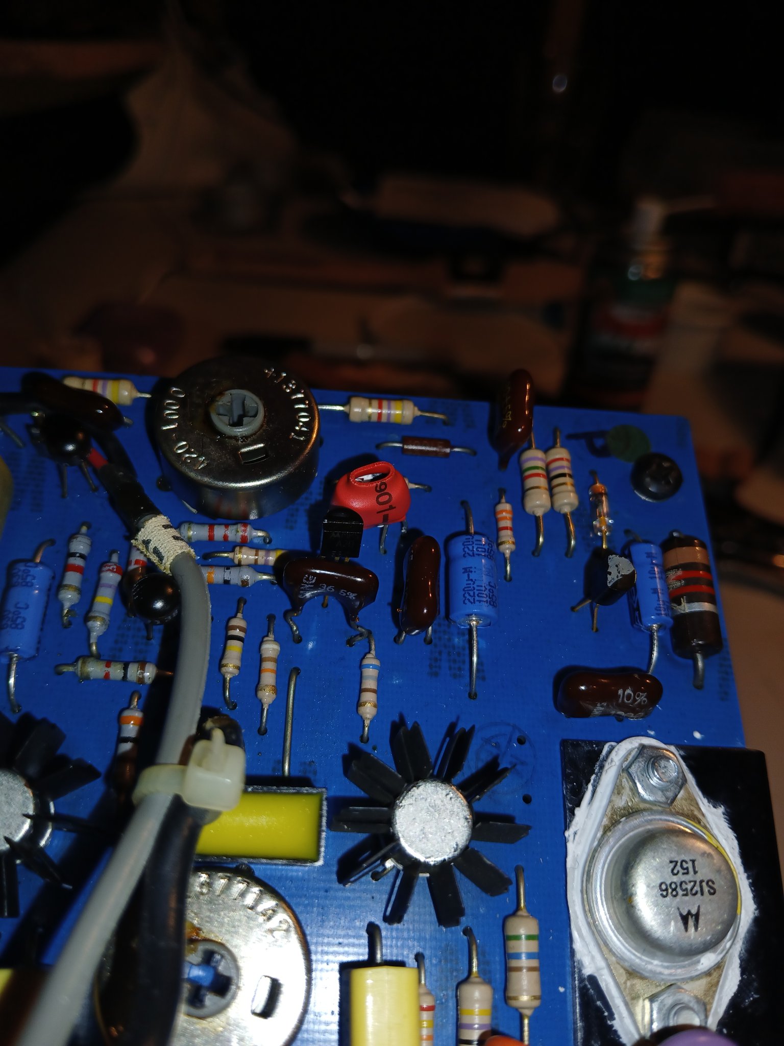

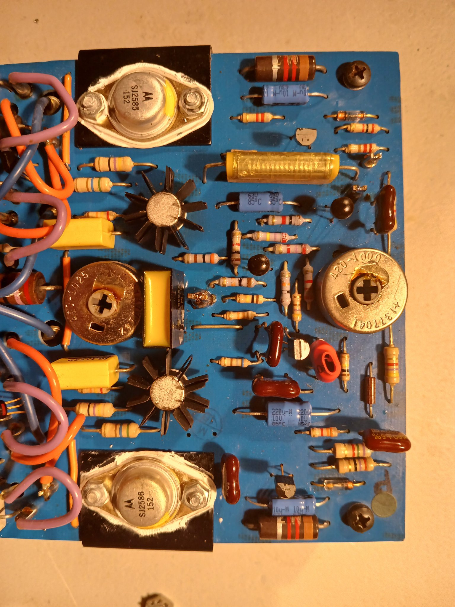

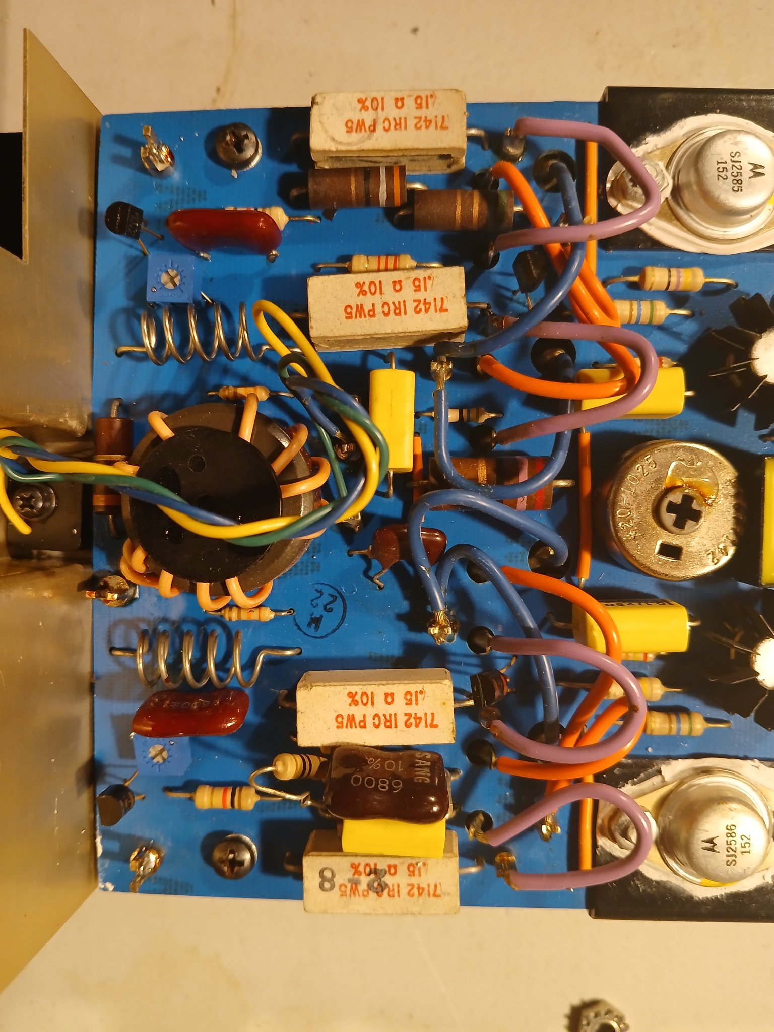

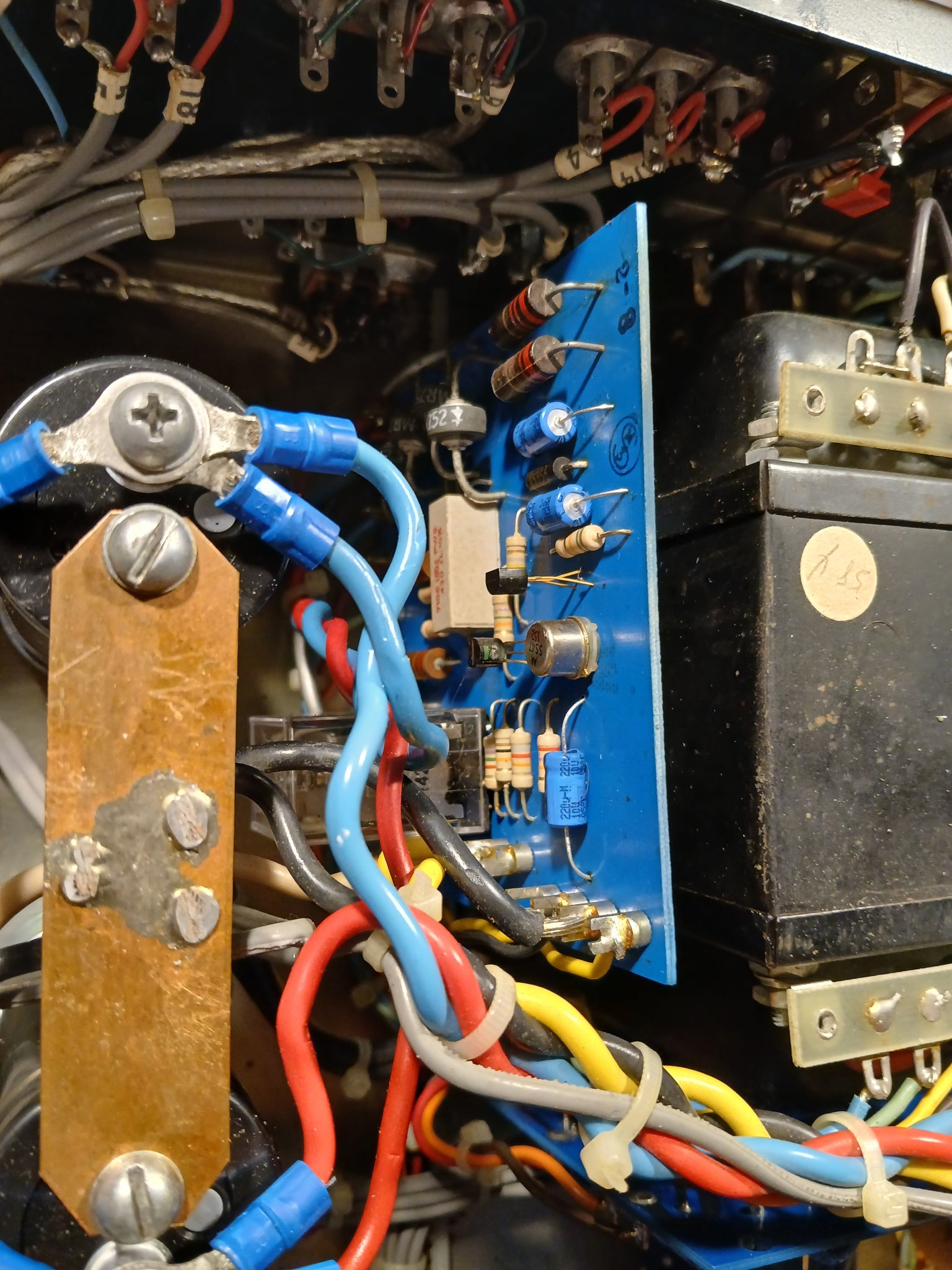

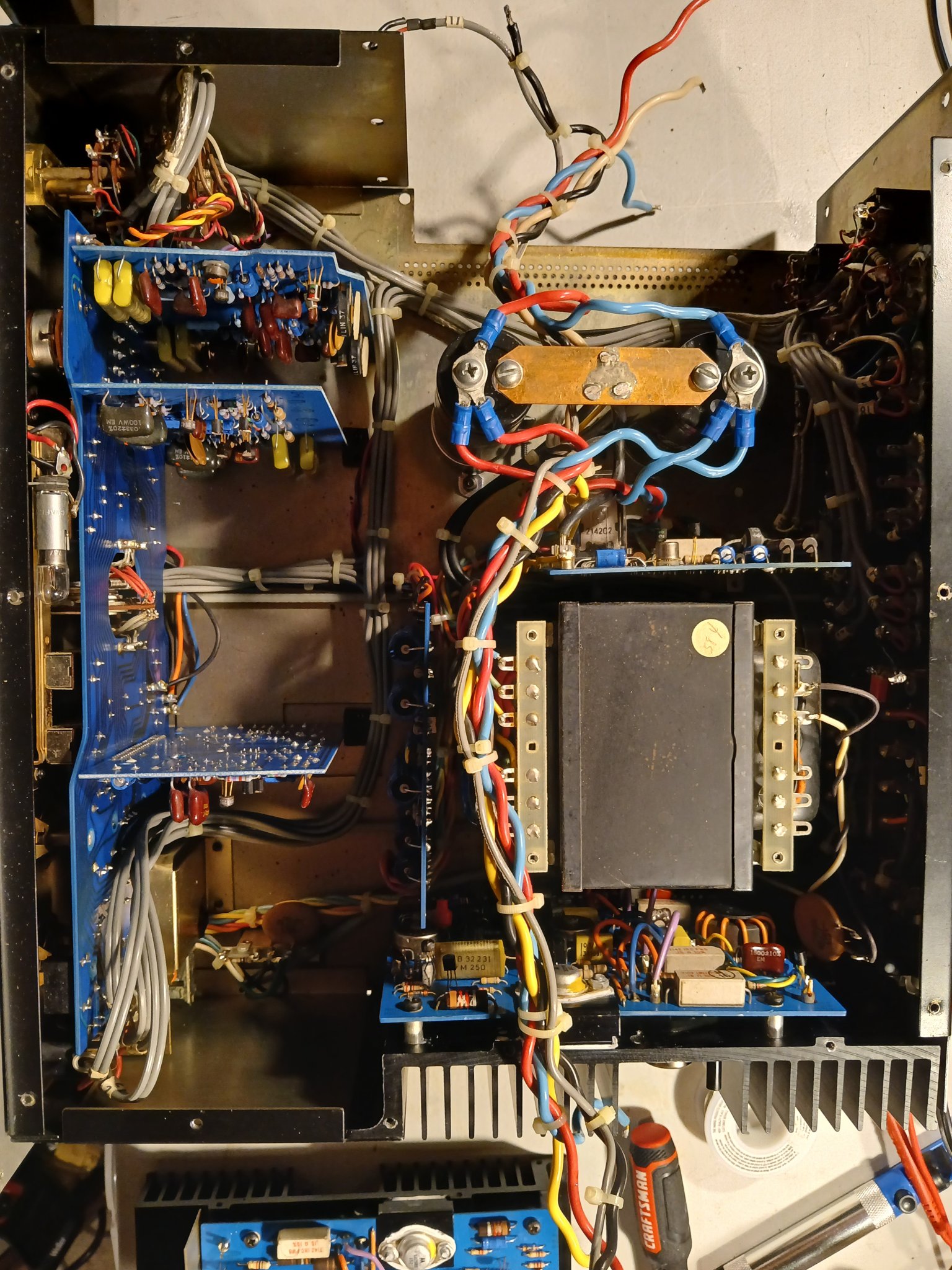

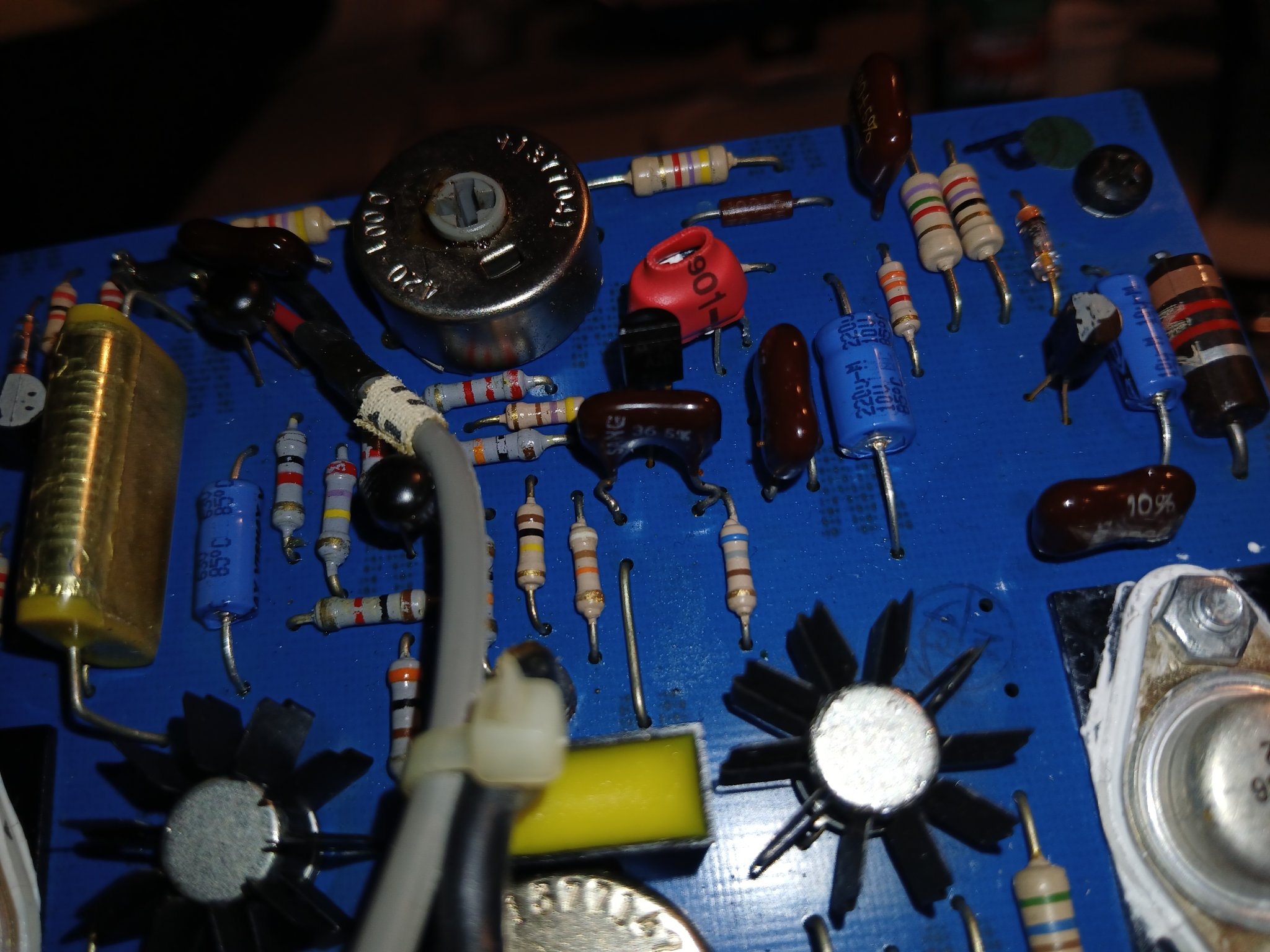

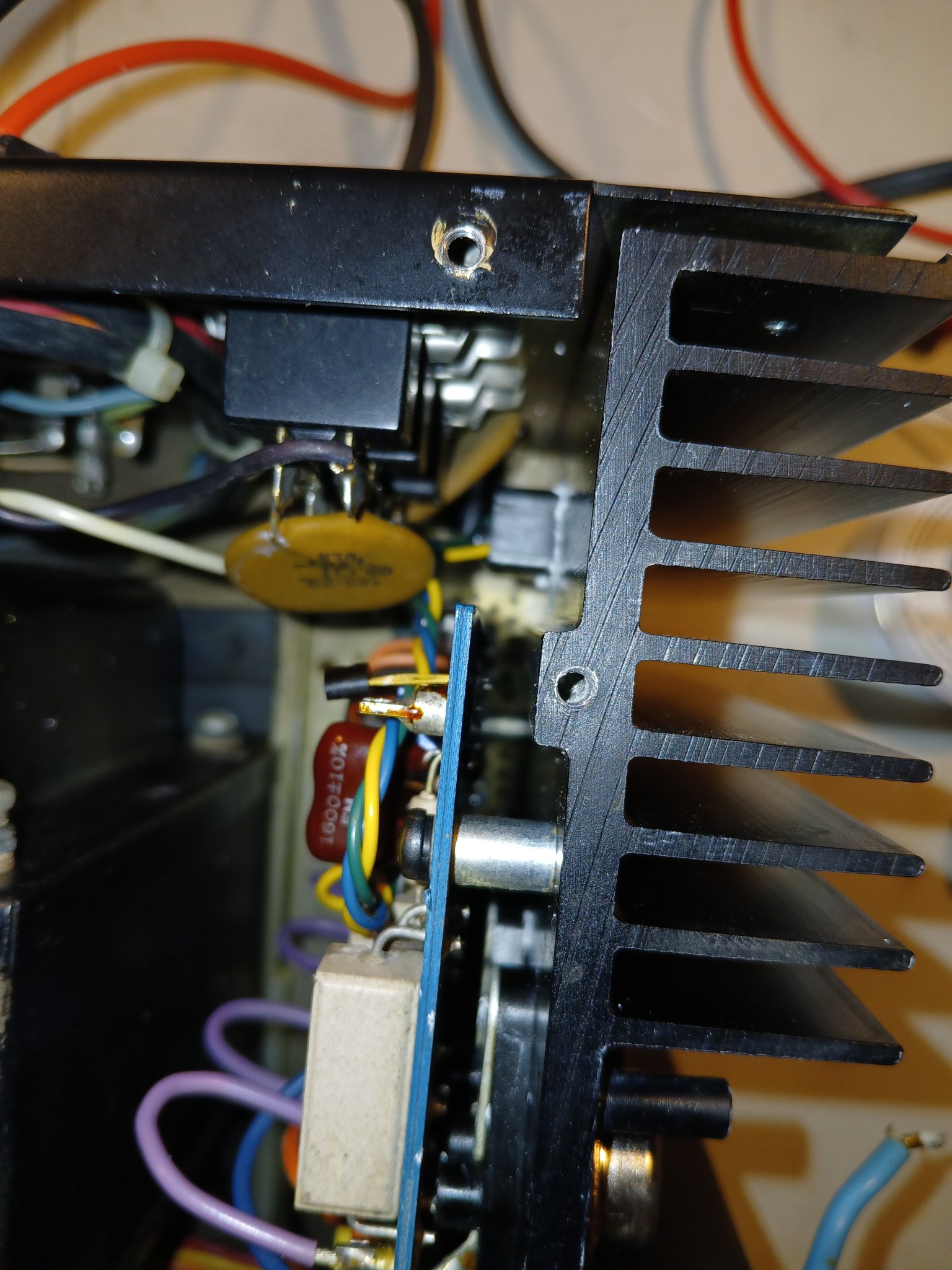

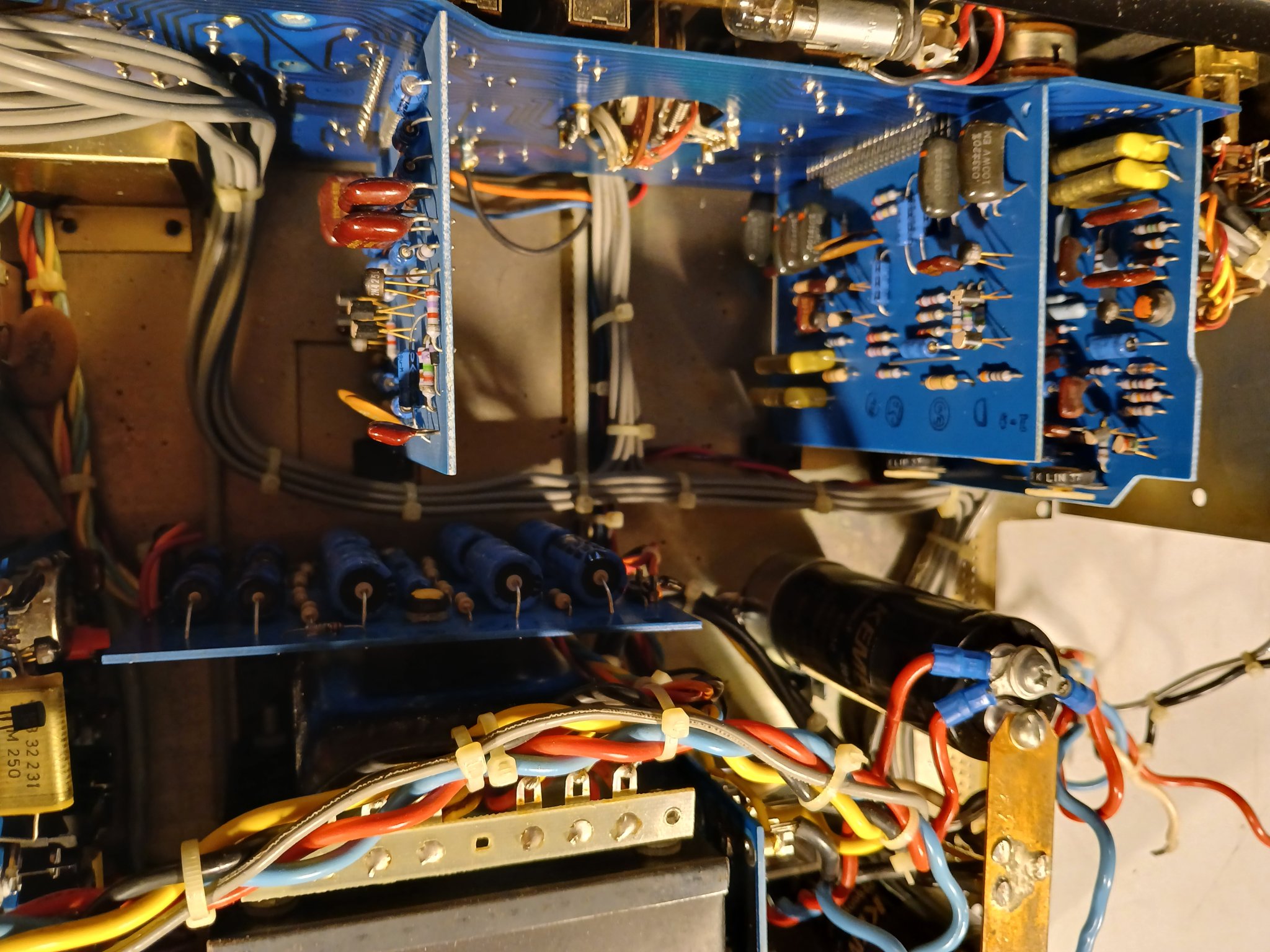

Could you take some photos of the inside of your amp, one in overall view from above, and one or two others a little closer please ?

There is thw AC connections right next to the bias transostor for the right channel. Once i swap boards, if the issue persists, I'll add a ground shield aroud it. If it doesnt, I'll set a day to pull and test every component on the faulty side. Over on AK, someone fixed their hum by replacing a faulty carbon 1.2k resistor on the dc rail, but they are fine on this board. They arent wirewound either, so i wouldnt expect inductance to be a huge issue.If it was just mains hum, wouldn't the duty cycle be 50:50? Maybe some kind of interference?
The main filters have been replaced, but im not seeing any anomalies with the voltage ripple, but I can post the waveform tonight. It was biased per the manual to consume 7-10 watts more per channel relative to no bias, so i'll have to do some math to quatify if the PS is behaving as expected. The rectifier diodes are original, but I didnt observe any signs of leakage, so i left them that way.Reads a bit like a psu problem, the extra load of biasing the second (L or R) channel stresses a volt regulator or (????)

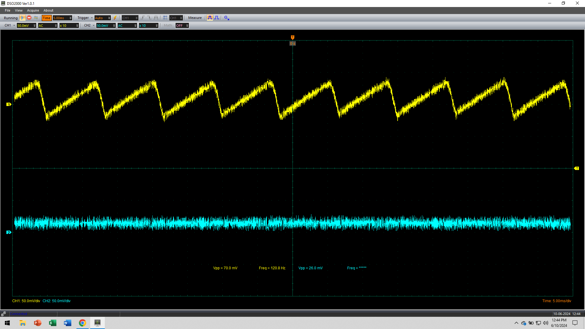

Below:
Channel 1 is Ground to DC+
Channel 2 is Ground to CR501 anode
