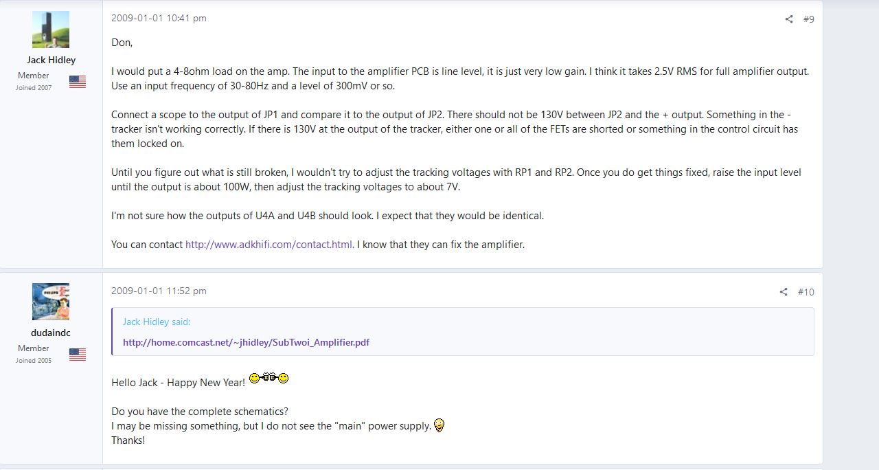

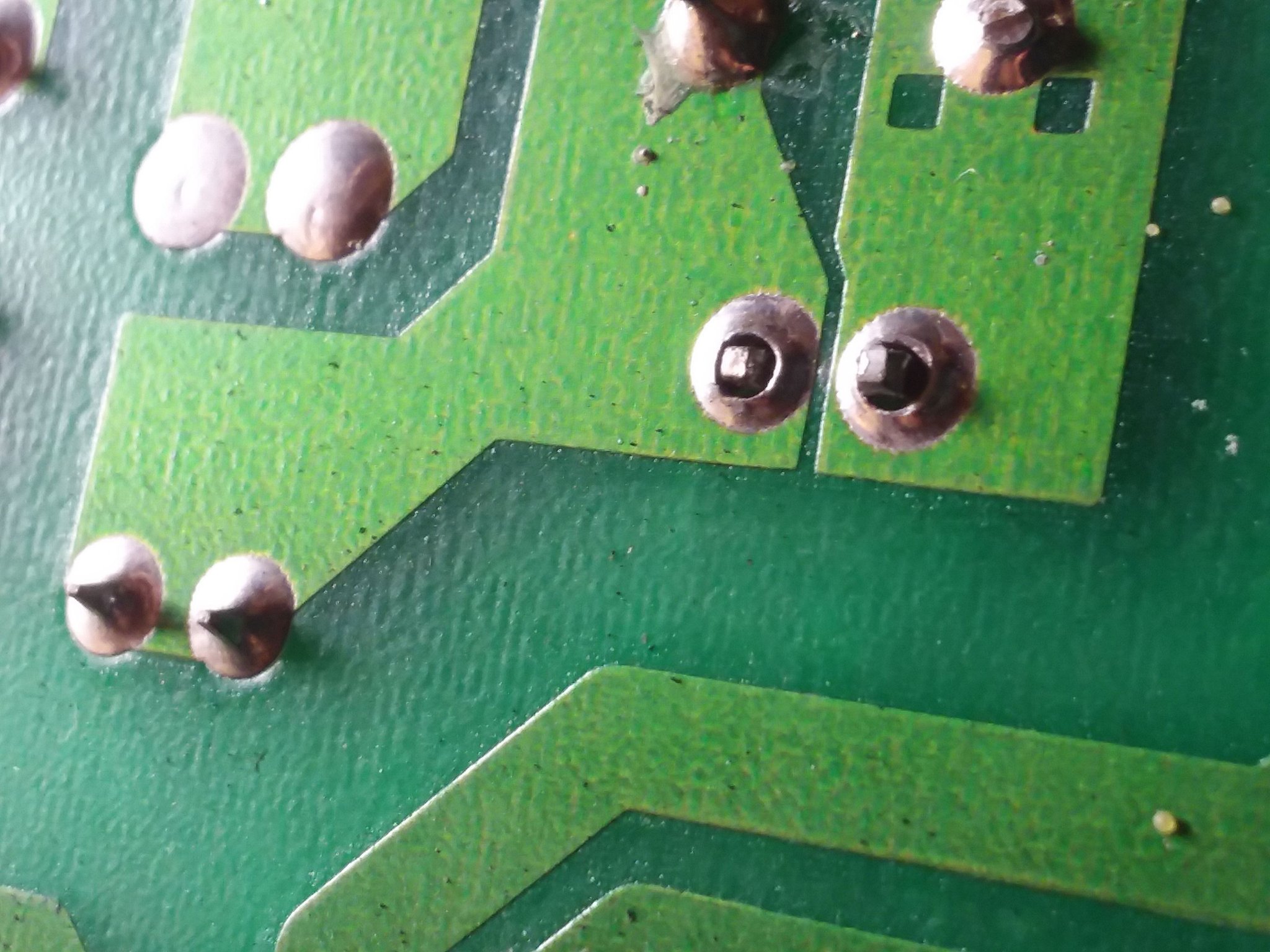

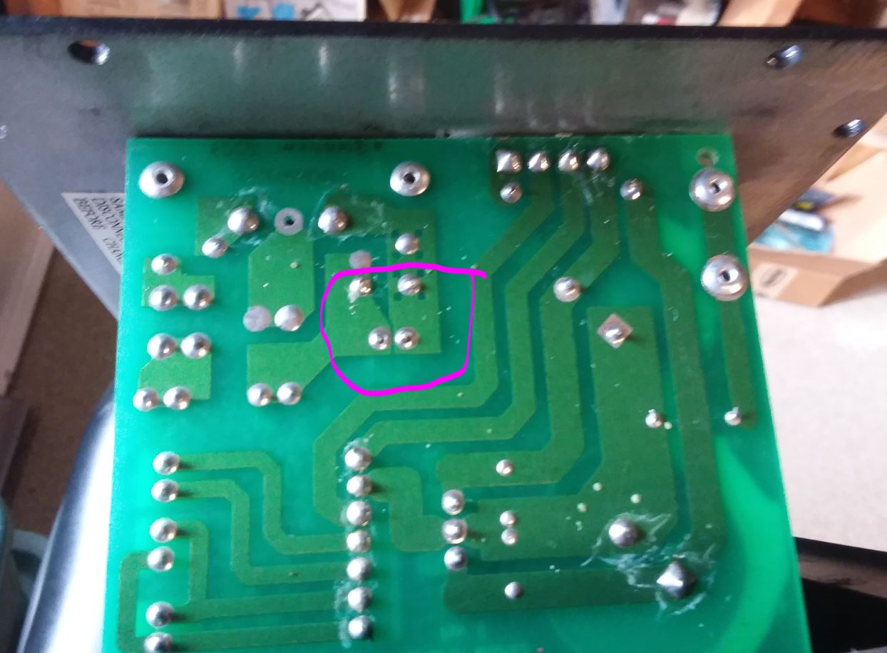

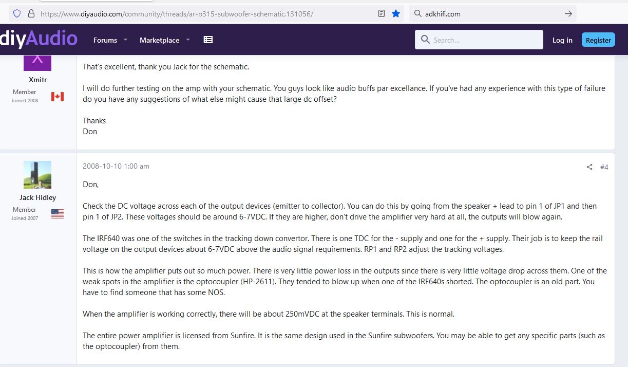

Hi WattPusher. I've fought with several of these - mostly with little luck. Two or three just as you described - one 'output' shorted. You might also find that one or more of the FETs in the 'tracking down converter' have trouble. May have stumbled onto something just today. If you are still trying / have access perhaps you might please check these connections and let me know should you find them bad.

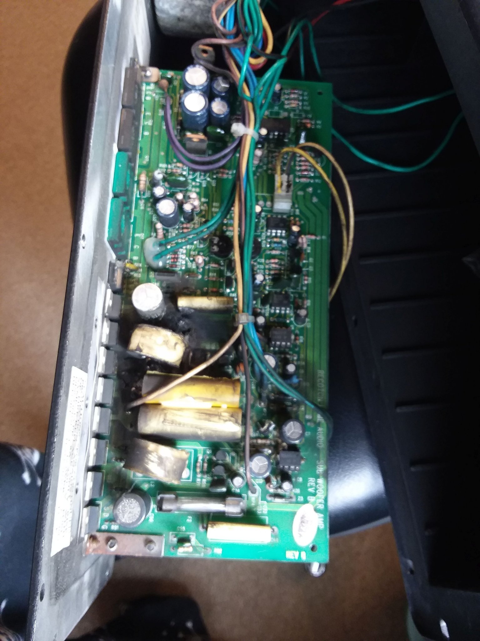

Found two with bad connections today - in the burned unit and another that's now working for the moment. (All outputs, drivers, FETs, optocouplers and much, much more replaced / repeated failures.) Hope this helps. Cause or not, nothing should burn this badly with the correct fuse types / sizes in place.
And as you may have already discovered; a significant -80VDC remains on the units long after power is removed. I'm revealing an anti-Carver bias. Worked in the industry most of my life and after wasting countless amount of time and other resources have only successfully repaired one or two Carver units or their ilk. Good luck! Here are some hints I found previously on this forum.
