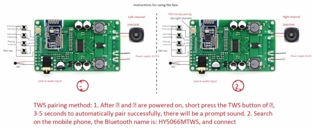

Here is just the TWS BT module. You can connect any amp you want. I am thinking the TDA7297 is a nice option as well as it is Class AB and we can avoid more DCDC switch noise.
How to Pair and Set the TWS Bluetooth Audio Receiver Board

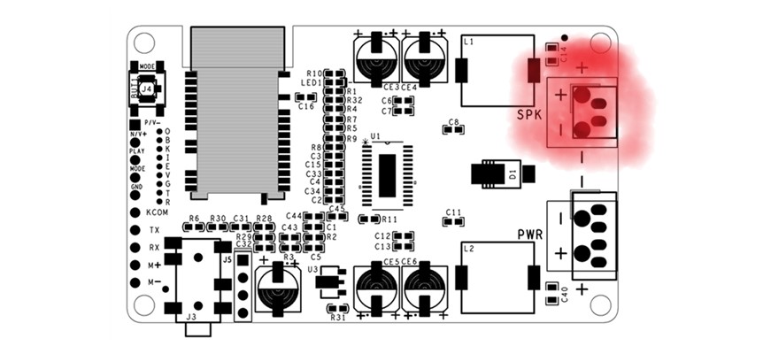

I just received the Tinysine TSA3118B(TWS) amp. It is really nicely made high quality board. The inductors are on small side but caps are Rubycon. It was shipped from China FedEx Express so got here in like 4 days - this was the basic $25 rate.
Connecting it in TWS mode is a bit tricky if you watch the video as they did not make it clear that the button press sequence for the master vs slave are different. Master is S1+S3 and slave is S1+S2. Once connected though it remembers that it is a TWS setup with the phone or whatever device you connected to it. I am not sure if pairing a new BT device would be simply connecting only to the master and not having to do the TWS pairing anymore. The sequence would not be very user friendly if it had to be done everytime you had a new device you want to connect.
It sounds pretty good though - typical TI TPA3116 sound, which is to say, quite good. There is a small amount of hiss from the speakers but nothing audible from 12 in away. No annoying BT static/buzz or anything like that - typical Class D amp sounds. I am using 12v SMPS wall warts. I have big 24v ones but the 5.5mm barrel jack doesn't fit. The amp does have screw terminals for power in though. Also RCA's for auxilary input plus JST 3-pin jack for another source. Also JST header for external control buttons for volume, pause/play, prev track or next track too.
I know everyone is wonderin: the master is the right channel and slave is left channel. This can be reprogrammed if you have a 6pin programmer and follow their instructions.
Overall, a nice product. I checked the left right using a YouTube left/right test track video and it is stereo for sure.
