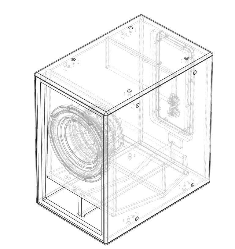

Hey guys, so a good friend of mine has a pair of Nexo RS15s installed in his venue. He powers them with the the recomended NXamp.
http://nexo-sa.com/attachments/products/48/nexo_rs15_datasheet.pdf
Originally he planned on installing 4, buttt budget ran short. 2 years later he'd like to commission me to build a pair of subs to accompany them, and ideally I'd like to get as close as possible to nexo offering as possible, in terms of response, size, power handling, and more importantly, phase response, so we'll be sticking with a 2x15 ported box. (a wave to people who recognize me from prosoundforums now, they are not too keen on the diy)
Now, I stumbled upon this pdf
http://nexo-sa.com/attachments/products/28/rs15-spare-parts.pdf
Based on the drawing, I've narrowed the driver down to 2 possible offerings from B&C, the B&C 15NW76 and the B&C 15NDL76, due to the shape of the frame and magnet assembly. I tend to think its the 15NW76 givin the greater powerhandling and xmax, it seems to be a better match to the specs of the RS15 datasheet. If anyone has any info to share, I could surely use it (esp if I'm "totally off" in my assumptions)
I initially thought it would be one of the nicer BC drivers like the 15sw115 based upon recomendations over from Prosoundweb etc ("its NEXO, must be buku dollar drivers"), but am glad to find that its a little more in reach $ wise.
I've found the BC 15NDL76 for 239 a piece

I'm going to start modelling all 3 of these in winisd shortly... however I was wondering if anyone was familiar with any better retail locations for these drivers, given I'll need four of em. I've designed a couple different ported boxes, but not held myself to such strict constraints before. Any help at all would be greatly appreciated, but regardless... I'll likely be documenting my results here.

Regardless of the speaker you choose, if the cabinet and ports are made the same as the cabinets you copy, the phase response will also be very close to the same, the copies will "play well" with the originals assuming the parameters are reasonably close (even your 3015LF, Sean ;^) ).
That said, Nexo is large enough they may be using a custom variant of the B&C drivers you are considering.

Any ideas how I would model the port on the nexo (I'm trying NOT to pull the drivers out of the nexo boxes... that spoils the challenge)? I've just been going with both ends flanged, since the actual shape of the port is this curved thingy lol.

Sean,Any ideas how I would model the port on the nexo ..
For simulation purposes, the port taper won't make much difference.
The slotted port using a sidewall will make a difference from the usual round port located away from cabinet sidewall "normal" simulation.
You can look at the published impedance curve of the cabinet to get an idea of it's Fb.
Since you just plan to copy the cabinet, why bother with a model?

I'd rather arrive at the results via modelling, vs pulling the drivers, taking a look inside and going from there. what can I say, I have too much time on my hands. Its also a good learning experience/exercise, and will let me brush up on ported box design.
for all intensive purposes, I'll only be copying the outer dimensions, and trying to arrive at all other data myself (I dont plan on measuring the ports. I'll then probably end up dragging one of those nexos out into a feild with my prototype and pulling ou smaart for testing to make modifications to my design as well).
bottom line... yes my end result could very well resemble a copy... but I'd like to arrive at it myself (with a teeny bit of help regarding driver choice and outside dimensions). I'd also like to determine if the non neo equivalents will give me similar performance, since they are cheaper and will save me about 250 overall on the project.

Nothing wrong with modeling, but if you want the cabinets to sound the same, build them the same.
I'll likely build the box with similar outside dimensions, a straight slot port on either side of same outer dimension (largest point) of the nexo, and shape my ports using a hard foam material. again, measurements comparing phase and response using smaart vs the nexo ray sub.

A "hard foam material" is not likely to be as stiff as plywood.I'll likely build the box with similar outside dimensions, a straight slot port on either side of same outer dimension (largest point) of the nexo, and shape my ports using a hard foam material.
A straight slot port on either side of same outer dimension (largest point) of the Nexo will have a higher Fb.

The outside of the Nexo port looks like DSL's CS30 port, wonder if it is similar inside.
If it is, your plan stated above will be way off in Fb 😉.

The ports are somewhat simlar to that, although it is the outside edge that is curved, not the inside. I'd only be using the foam for the testing purposes (not long term solution, just to get the port volume and shape correct, then install some curved ply). those ports are indeed the tricky part though 🙁

My first priority to look for the right driver to model would be, see note(*), (net) internal volume (1), and (net) volume for port (2) including sure the cross section area (or diam.)(3) and total length (4) this giving the overall tuning F for the enclosure.
*) This for each driver.
Get some results (1, 2, 3 & 4) and give some substance to the start of your reverse engineering project.
I also assume the driver that you're talking about (here^) is the Eminence Kappalite 3015LF Neo 15".

I agree with art.
Pull the drivers out, get an exact match, and build the subs as close to the current ones as possible.
For this purpose, that is your best bet.
