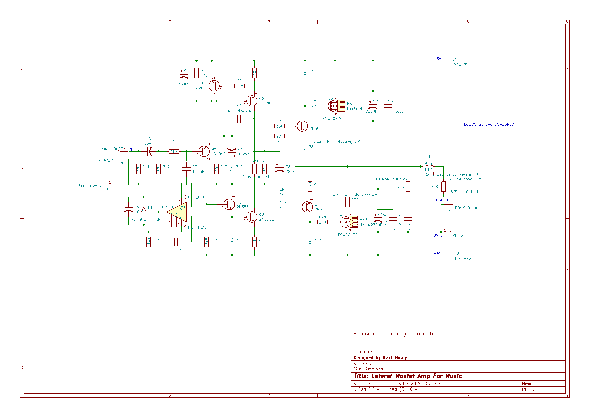

If we take Mooly's amplifier, since that is what I am building for the moment. It have a recommended input Voltage of 45V p/p but what would 100V do (assuming all component can handle it) Would that give headroom, general higher gain or just stupid?

If we take Mooly's amplifier, since that is what I am building for the moment. It have a recommended supply Voltage of 45V p/p but what would 60V do (assuming all component can handle it) Would that give headroom, general higher gain or just stupid?

Note that the clipping point is always less than the supply voltage as perfect output devices do not exist. So you have to subtract a few volts from the supply, depending on output devices and configuration.
For instance an amp with +/-45V rails might clip at +/-40V, allowing sine wave upto about 28V rms (80V p2p). If that amp has a gain of 28, then the input rms clipping point is 1V (or 2.8V p2p).
Headroom relates the clipping point to a nominal "average" level the system's is used at - the
more headroom the fewer transient spikes will clip. If your music is already compressed/limited (much is), you won't need a great deal of headroom as spikes are limited, if you have raw recordings with a high dynamic range, it matters more.

For the same power amplifier and speaker power you need more headroom for higher impedance speakers.
i.e. 100 watts and 4 ohm speaker requires +/- 20 volts.
100 watts and 8 ohm speaker requires +/- 28 volts.
Its just uses power formula's and ohms law.
Ohms law V=IR. Power formulas W=(VV)/R .W=IIR. W=VI.

Assuming your speakers operate with DC voltages your formula is correct. For AC-voltages definitely not.For the same power amplifier and speaker power you need more headroom for higher impedance speakers.
Find the error!
Find the error!
0.707 of DC if using sine wave.
So 20 volts becomes 28v
and 28 volts becomes 39v.
My calcs were correct for a square wave ! worst case scenario.
