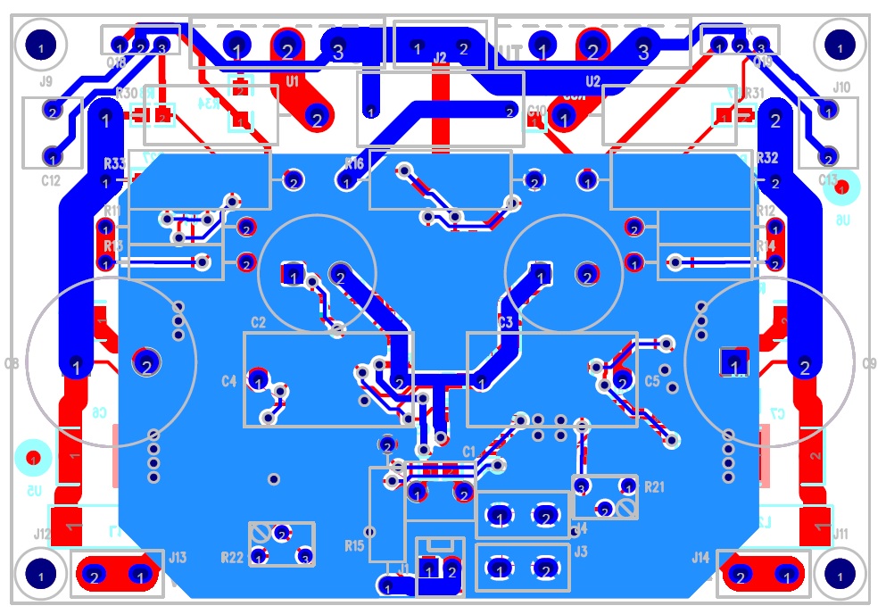

I was not happy with the HV version I had designed. So this amp will be changed to be an dual TSSA V1.7 module running balanced with an optional discrete inverter onboard to make it possible to feed it from an single ended source.
The new TSSA V1.7 BL (HV is renamed to BL) will cost €200/module.
But the system voltage should be +/-32VDC. So it is possible to reuse powersupply from the TSSA V1.6.
- Sonny
PS: Below is the PCB design of the TSSA V1.7
- Sonny
