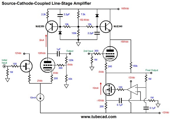

I am looking for tube buffer or preamp design using with 6DJ8 or maybe someone can suggest better tube for this project. Looking for very good soundstage, very low THD like 0,01% and less. Something that touches mind body and soul. I like to use one tube per channel or one tube for stereo buffer like Aum Acoustics Single Triode Tube Buffer. Can anybody point me to the right schematic to do something like this Aum tube buffer?
I am planning to use high PSRR power supply like 21 century Maida regulator for high voltage and for heaters also PSU with 100db PSRR. Balanced in and output option using some buffer or any better ideas how to solve that issue to use both balanced and unbalanced tube amp?
I picked up these sample schematics looking for very low THD, PSRR and good attenuated harmonics. It would be good if the gain for this buffer or preamp rather low. Planning to use sometimes up to 2Vrms input and output balanced 4Vrms option.
Please comment about these schematics and your experiences with this kind of tube amps like:

Bear in mind that these circuits were simulations, and for the most part have never been built.

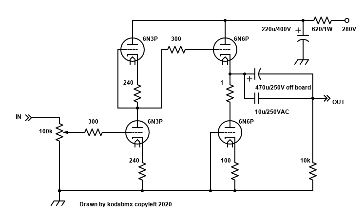

I make a tube line/HP/preamp board (two versions, one is SE and actively loaded, the other is a WCF).
I also have 3 versions of the SE version shown in this schematic. The other two use 6N1P or 12AU7 instead of 6N3P respectively.
All have been built, used, and enjoyed for many years now.
15$ for a blank board, more for a kit or complete.
The schematic below is set up for driving headphones - For line/preamp use, you'd change resistors 1 and 100 to 240, and leave out the 470u cap.

It would be great if the gain is 5-20db.Gain?
It could be so. I still believe that someone have tried to test these kind of schematics and could give feedback.Bear in mind that these circuits were simulations, and for the most part have never been built.
To use with 6DJ8 tubes then probably I need to make some changes there. I also have some easy schematics with 6DJ8 but looking something for better THD, PSRR etc.I make a tube line/HP/preamp board (two versions, one is SE and actively loaded, the other is a WCF).

6DJ8 will plug right in. Just change 1R and 100R both to 240R on the 6N6P section (and use a 6DJ8)
So will 6CG7, 6N1P, ECC88, ECC99, 6N6P etc.

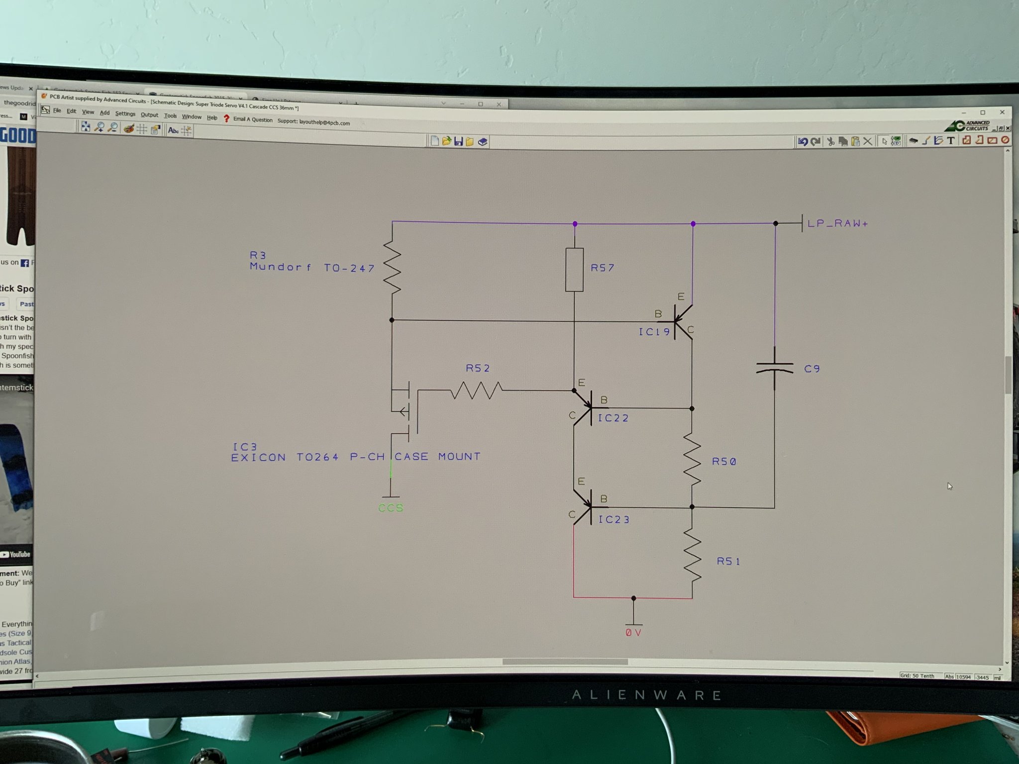

Here is the Tubecad grounded grid that I will build some day.. the buffer on the backside is different from the servo used above.. a little bit more ‘lean & mean’. I also attached a better CCS.. ymmv ! I need to update this design. The design shows the lt3080 configured as a CCS. I would use the LT3092 for my attempt.
