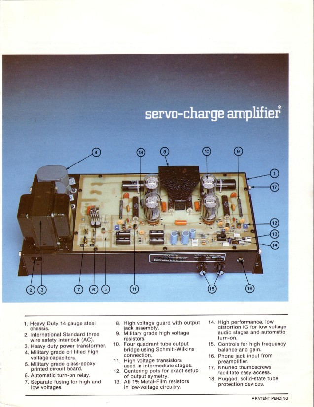

Well i am all about Diy but ......Jim Did this with the Acoustat tube sevos..... just copy this....Go for it....Less you need to Make a new mouse trap??
I had the Xs Thay were a pr of M3s type on the floor....
The Tube Sevos Sounded Great....These Amps Will drive ANY ESL.....ML ,SL,Quad,......What was the Down side an why did i move on to the 121 interfaces......The THD was so low that you just wounted more an more Output....an it Not going to happen.....
To me it like a 500 Watt pr ch Mcintosh SS amp.....Sounds Sweet.....but has no headroom becase of the autio-fourmers on it outputs.....you can use all it output with Low THD....leves mOST wonting More...
An this is not just me.... I sold Mc an saw a lot of people who lov the sound move away from the Mc SS Amps....just did not have the drive thay wounted for ribbons are Even Mc own speakers...
With mods the 121 can sound as good an can be driven with my OTLs M60s ....60watt tube amps....Goodluck

Well all i can say is it good to see someone that HAS had a DDamp....give some input!
I well say My Acoustat sevo tube amps had a Eq in them.... an thay sound so Vary good to me an [others] ...
So when i was Saleing Audio in the 80-90s...
A Dr. i had done work for in his home..had a pr of Acoustat 1+1s....With one of pass,s big s/500s 250 watt pr ch Amps driving them...he wonted to Bet me...that there was No way that these Acoustat DD tube amps could give him more out put than the Big Pass...an sound better on top of that...
So i call him on the Bet....$2500+the pass s/500+ the 121 interfaces that were on his 1+1s.....
Well that was that...
I got the cash amp an 121...he got my Sevos tube amps...With Stock tubes... Amps were all stock ....
I lov the sound of the DD amps on my Xs that i paid $400 for the pr...but i was over driving them ...just could not get a nuff of that low thd, ,full,warm,honey sweet topend, big Full bass an sound stage that filled the room......So i never looet back....goodluck on you Trip with DD amps
